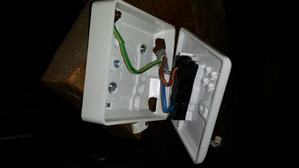

Ps just because the wires are coloured black and red, or brown and blue, does not necessarily mean they are line and neutral!
If all you have behind the switch is a single cable with the L & N cores connected to the switch (and, hopefully, the earth connected to the backbox or switch earth terminal if present), then you don't have a neutral there. Post a photo of the connections if you have any doubts.

...et voila
2016-02-20-16-44-29-jpg.93898
Would that be safe to say I can use that?
But if you trace that cable back to the light fitting or junction box, you should be able to find a feed there. It's generally pretty easy to find somewhere to tap for things like this in an open attic space.
It's not one of those.
