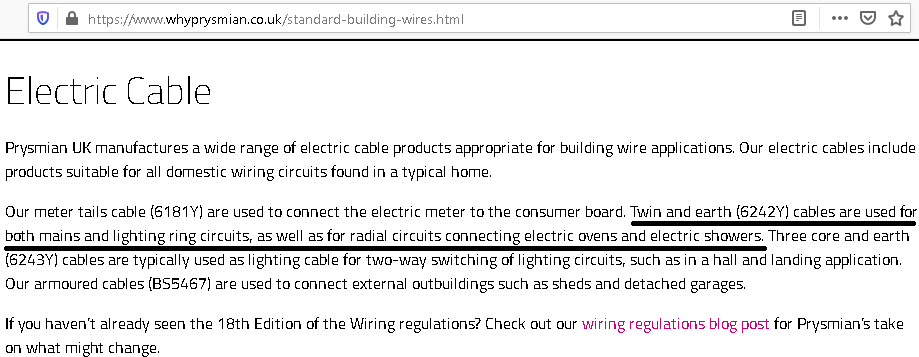

Lighting is not wired on rings.
Even the manufacturers have recommendations for lighting rings:
