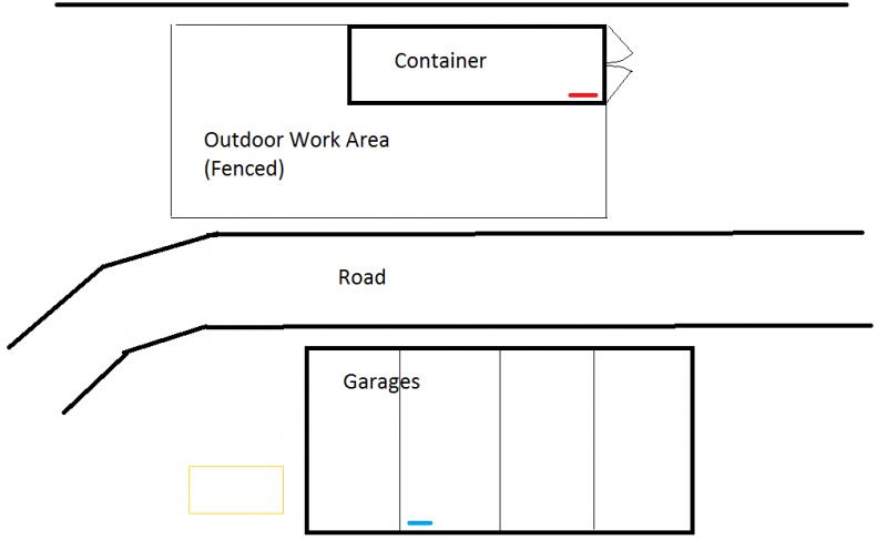

A rough outline is attached below.
To get to the container, the road is around 8-10ft wide, plus 10-12 foot within the work area, plus 10-12ft to the back of the garage where the current consumer unit is, I believe the cable feed int he four garage comes in at the bottom left corner of the four garages, and presumably each has a meter and consumer unit as ours does.
There is then a fixed steel boundary fence along the back of the work area (top of the image) and movable site fencing around the work area.
We do not know what the supply looks like beyond what we can see, nor as far as I know, what the earthing arrangement is currently.
Daniel

As said, as I understand there is going to be a meeting with estates and one of their electricians with the current club chairman and garage sec, at which point I presume the plan will be drafted up of how its going to be done.
But they have been asked to draw up what they would like, for it to be considered.
For me they need to work out what they want would like best, whats a bear minimum, and where they can be flexable in terms of what is electrically easy and or cost effective. Obviously having an insight in to what they can expect from the meeting is a bonus in terms of understanding what the electrician is saying.
Bear minimum as I see it, is a pair of sockets, or a single socket, on the other side of the road from the garage, so they can run power tools from it without running an extension over the road.
- Ideally they would also be able to run a welder (the largest mig unit you can get off a 13amp plug) of the socket.
- Ideally there would be provision for having some lighting in the area, either flood lights on stands, mounted on the container, or mounted on the garage for winter evenings, and the help them tidy up at the end of a day. Which could be turned on an off without opening the container.
- Ideally they would have a light in the container, to help people put thing back neatly, and prehaps a socket if that could be put in at the same time, to prevent people running leads through the door.
