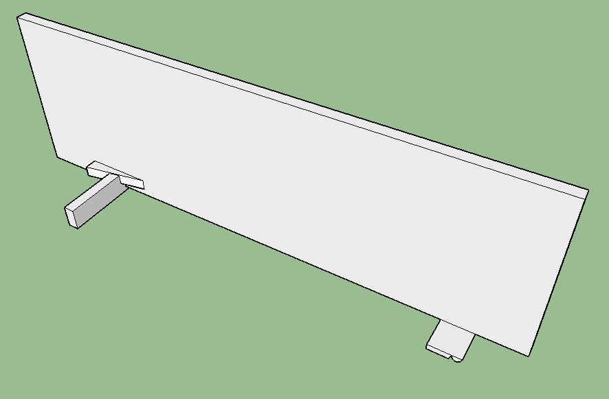

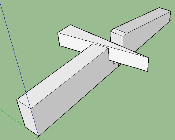

Shooting a door in is the process whereby you trim a door down to the required size to get it to fit into the opening and is the first part of getting any new door to fit into an existing opening:
1. Using a framing square check that the head of the casing is square to the hinge leg. If it isn't you'll need to work out by how much it rises or falls across its' width. That must then be transferred to the foor and the top edge of the door adjusted accordingly. Requires a jack plane and a home-made door wedge (or a Workmate if you have one)

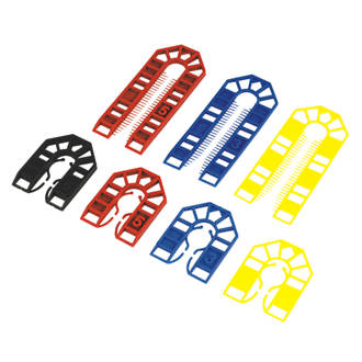

Will these do as packers=
http://www.screwfix.com/jsp/trolley/trolleyPage.jsp
Don't be put off by what everyone has said I recently replaced 8 internal doors with nothing but average diy skills. They are all straight and look great, people visiting even commented asking who my carpenter was as they look great.
Some doors required planing multiple times a little bit then a little bit more until it was perfect my advice don't be in a rush and you will do fine.
Unfortunately your link is a bit wrong (it points at the trolley page), but if the packers you were referring to were the Broadfix horseshoe packers:
Then you are looking at the right sort of thing. I generally carry a selection of horseshoe packers because they are generally so useful for all kinds of joinery tasks - use the blue packers (2mm) or blue + yellow (3mm). Getting things visually correct is often better than being 100% spot on in accuracy terms, but be careful not to overplave - it's easy to take it off but a lot more diffiult to put it back on!

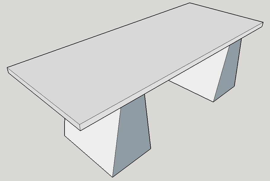

WHen you plane down the door is it better on two tressels or two workmates? When I did the Diploma Level 2 we clamped the door into two workmates and had it on two pieces of baton on the floor.
There isn't really a right or wrong answer to that one , it's more what you feel comfortable with. I've used the wedge that J&K has shown , I've wedged a door on the sawbench (and much rarely a workmate , simply because they were rare on the sites I worked on) but I have also just pushed a door into the corner of the room or clamped it between my legs. Whatever works for you and you feel comfortable with.
Remember that when you are planing the edge of a door you need to hold the door in an upright position so that you can actually use a plane on the long edge comfortably. If you lay a door flat on top of two trestles you won't be able to plane it accurately or (with a power planer) safely. That's why the "old school" chippies like me tend to make up a clamp from an offcut of 4 x 2 or 3 x 2 softwood. There are lots of alternatives, though. I've seen doors held at one end in a single Workmate, I've seen the sawing stools where one end of the (flat) top board had been notched out like a stirrup to hold a door. What I haven't ever seen on site is anyone using two trestles or Workmates, one at each end. The battens on the floor is a good idea to kep the door off the floor and minimise damage, although with a door wedge like I showed above you'l only need something like a 12in length of skirting or 2x1 PSE as the wedge does the rest. As LadyLola says Workmates are actually quite rare on work sites and always were in my experience - too low,too unstable and not big enough IMHO
When I fitted a load of new doors into my house a while ago, I made a couple of very simple jigs which some people call a "Door Buck". It works very well. See here for example -
Essentially you use thin bit of Ply and put some timber either side of it with a gap which is a little bigger than your door width. Then you put some shallow feet on the bottom of it. When you place the door in the gap, the weight of the door will push the flexible ply down and the 2 bits of timber on each side will push against the door making a clamp. Pretty neat and simple solution. Surprisingly very stable.
