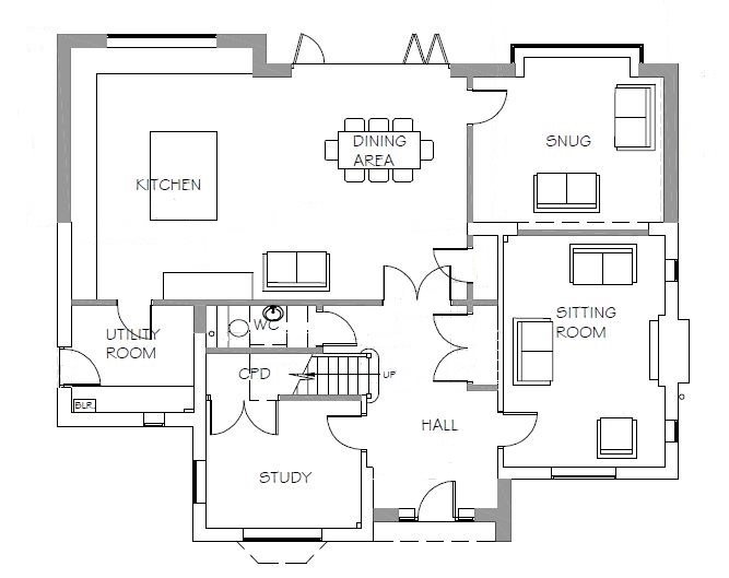

Thanks. I have included a floor plan below. Based upon the comments, I could do as follows:
Main box, keypad, external sounder/box
Sensors: Front door, side door
PIRs: Kitchen, snug, sitting, hall, 1F landing
What wiring is required for this?
6 core: from main box (in a cupboard) to keypad, sounder, sensors & PIRs
Power: fused spur to main main box? (No dedicated power required for Keypad, Sounder, detectors?)
What would be the best locations for PIRs? Corner opposite door?
Do I need a keypad by back door, or can I go through kitchen to use the keypad in hall?

Just my thoughts on sensors - cover all rooms for the sake of a few pounds. The snug detector could be place on the right hand corner, but like all things without seeing the room there could be some changes to these. I placed a detector facing a window due to the curtains blocking the view in the ideal position. Not ideal but the best compromise
Internal extension speaker may be needed near the exit / entry door. A second keypad could be placed next to the utility door with a contact on the door but keep the kitchen on full guard

Great. Thank you. What would the second keypad add?
What is full guard? Is that where if it is triggered it goes straight to alarm, rather than the deactivation count down?
You mentioned having a second keypad by the utility door which is OK if you use that as an access route. Without it you would have the utility door on timed, kitchen and hall on walk-through zones before you get to the keypad which would need quite a long delay. So, have a keypad by the door and that triggers a short (20 second timer) before the alarm is triggered.
Guard = immediate alarm
Walk through / intermediate / access = no action taken whilst the entry / exit timer is running, but will cause an immediate alarm otherwise

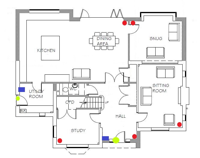

The first fix install is starting next week; my builder has priced for 5 zones/PIRs.
- Do the attached seem sensible?
- Should I also add the upstairs landing?
- Are any of these unnecessary / could be swapped out?
