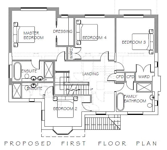

Pre-Wiring for future alarm
That’s 8 zones ....5 pir , 3 contacts , always a good idea to run a spare cable to the loft in case you require extra cover upstairs , depending on panel an expander can be fitted in the loft
Thanks, that is what I was thinking. If anyone get in upstairs this restrict movement around the 1st Floor.
