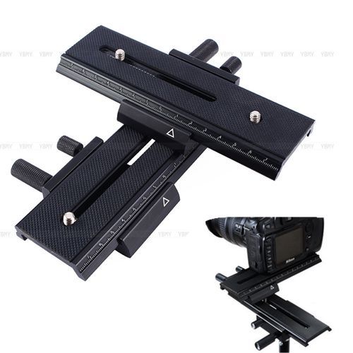

These cheap camera rails have a rack and pinion which can move the head less than a millimetre quite well:
Ebay - pic as attached
Linky

2) moves sideways if you have to move it to and fro between cuts (which you would). That makes the overhead rail ones sound less promising, but the Laboratory saws all work that way.
