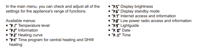

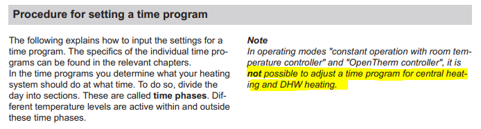

Thats really what I want to be able to do, and am struggling with it - so I shouldn't need to change the operating mode to be able to do that?
When I scroll through the P options here:
The only ones that appear as I scroll through are P2, P5, P6, P7, P8, P9, P10, P11
I cant access P4 which looks to be the one I want?
Maybe this is the issue?

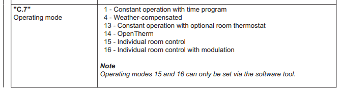

Yes you will need to change the mode, switch it to mode 1 then p4 becomes active. But you will need to set up 15 or 16 again when you flip back...there is a software tool for windows to do that. You could also wire in a room thermostat for back up, and set the boiler to mode 13. In a loss of comms I would rather be warm and spend a bit of time resetting the rads up rather than fault finding in the cold.

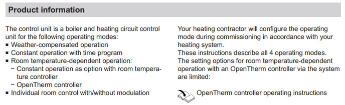

Ok, so Viessmann have said:

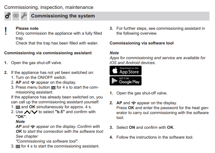

"The change from Opentherm to manual has to be done from the Commissioning screen, option C7:14 to C7:1 then go to last setting in list until END shows then confirm with OK. The Commissioning Screen is where the Installer set up the Boiler functions, this is in the Installation and Service Manual that the Contractor had on receipt of the Boiler, there are other settings in there that, if changed by mistake, could put the boiler into a fault state, so in theory, this should only be done by a competent Person, i.e the Installer or a Heating Contractor."
So if I wanted the boiler to change to manual, I need a plumber. Even if I wanted to do it myself there are no instructions in the user manual of how to change commissioning mode. I've looked at the installer manual above and I guess I could try that, but I'll need to start using the software tool and start using the gas valve - I dont fancy that.
