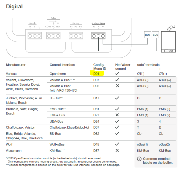

I have a Tado system and I am still using the extension kit for my current woscerter boiler. I am planning to replace my current boiler same as yours - Vitodens 100 W B1kf and want it to be connected with Opentherm protocol via Tado.
I believed my Tado extension kit (now discontinued) has a digital connection so Opentherm is possible. Do you have a wired thermostat or EU wireless thermostat?

I bought a EU kit, and just use wireless thermostats, nothing wired.
I'm fairly sure the Opentherm setup means the weather compensation is handled by Tado, as the Viessmann option is a different commissioning mode. As soon as Opentherm is enabled it locks a lot of the control panel option leaving Tado to control it.
Yes, all the rooms (except bathrooms) have an SRV and wireless thermostat sensor.
I bought my boiler via the plumbers (as I needed a full replacement from my old system), they bought it at the same price it was seen online.
I chose the installer from the Viessmann list:

Here are details on the weather side of things with Tado, as there is no physical device its just internet forecast based, but also I'm not sure how much its factored in given that its set to Opentherm with the set schedule.
The viessmann installer just got an electrician to connect the wireless receiver to the boiler following the Tado instructions that came with it to make sure it was set to digital and opentherm (The Viessmann installer commissioned it in Opentherm mode). Then I configured all the SRVs and tempature sensors.
They powered the receiver via the boiler itself, but it could be wired up for power if you wanted. The EU receiver I ordered came with a 2 pin plug but obviously I wouldnt use that.

Thanks.
I've downloaded the Tado professional apps and found out that the wiring is not correct. Tado is suggesting to wire it digitally on HT-BUS (D17). I have Greenstar 30Si. That's probably the reason why i don't see in hot water in Tado apps.
Not sure if I am going to pay someone to wire and recommission it back again as I planned to change by boiler this summer.
