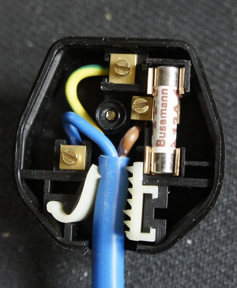

Try it and time yourself and then post a picture. What you think is the right way is probably not to the correct standard.

wellthat looks a bit naughty to me, I suggest you stripped lengths incorrectly for a start.
Phase (sorry Line) might pull out first then it's hit and miss whether all Live conductors pull out before the protective conductor
Wires are too long?
Wires are too short?
One or more is too long?
One or more is too short?
Cable gripping the wrong amount of cable sheath?
Line and neutral too long.
Earth too short.
If you where to pull on the cable hard enough, the line and neutral should pull out of the terminals before the earth.
Don't beat yerself up too much over this.
A lot of people (including "Electricians") wire a plug incorrectly.
The Live conductors (Brown & Blue) should be just the right length to go into the terminals without any strain and the earth should be looped so as to give it enough slack to be last to pull out (that's why the inside of the plug is shaped to allow a long length inside ie around the curved bit).
You've nicely put the clamp to hold on the sheath rather than on the insulation so award yourself a point for that.
