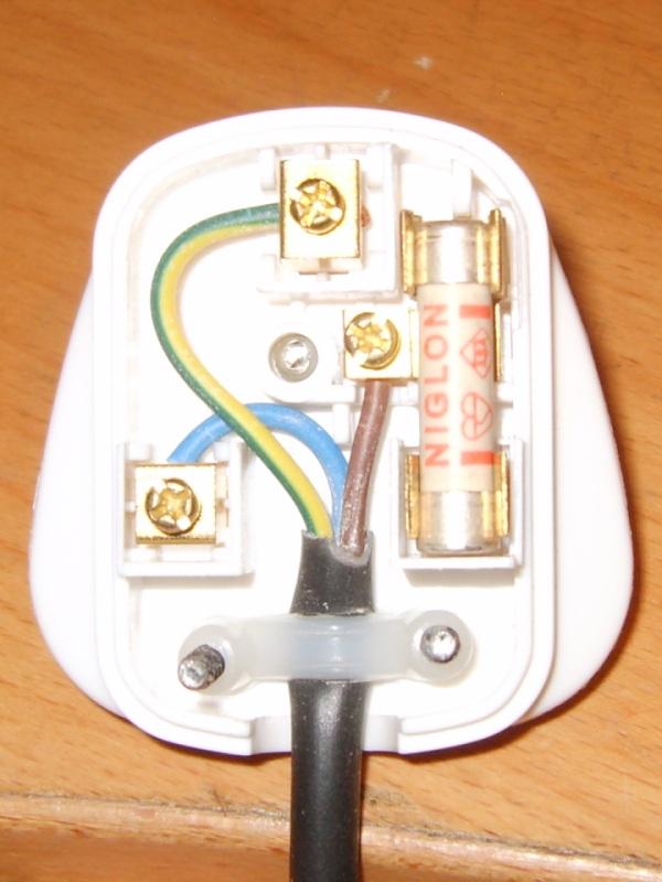

Prepping a cable for a plug
Fair point, but when manufacturers instructions contradict BS 7671 or any other british standard for that matter, and you can't see any good reason for doing so, it's time to question the manufacturers instructions!
If I had a batch to make up I would probably start with a simple jig for the correct conductor lengths.
Just a block of wood the right thickness to snug the outer sheath up to one side, the stripper jaws against t'other, and away you go.
For the three different conductor lengths required, just cut three different steps in the block.
The measurements I used were taken from the little card you get with the plug from new.
Then all the advice you have been given on this forum is totally incorrect. The regs clearly state that manufacturers instructions must be obeyed, ie they override BS 7671.
The advice given here (the earth being longer to ensure it is the last wire to detach if the lead is pulled out) should over ride the information in the instructions.
That advice was given many years ago when I and others were examined on our ability to safely fit fused plugs to equipment by my then employer.
The mere hint on the card that cables could be pulled out is an admission that the cord grip might fail. That is an admission the manufacturers must avoid making in case it does happen and they are sued for consequential damage or injury as a result.
The use of crimped on ferrules was also recommended for some of the thinner wires to prevent them being cut by the screw being over tightened. How many manufacturers include torque settings on their instruction cards ?.
it woulda been nicer if the protective conductor was a little longer :) and/or the N a little shorter.

Yes it does happen, that's why we wire a plug so the lives pull out first and quite a bit of earthwire is still connected or is the very last to disconnect.
