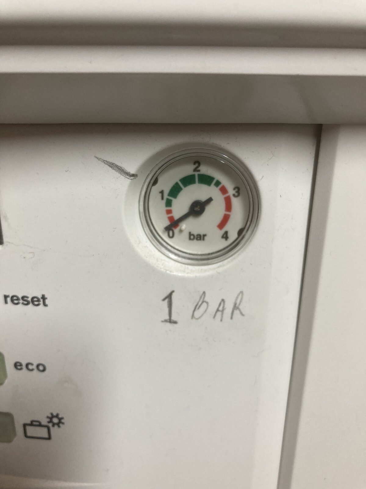

I’ve returned from holiday today and my central heating system (Worcester Greenstar 37cdi) has a leak on my Fernox TF1 joints
I’ve got some rubber washers so will replace tomorrow
But my question is, the pressure needle as shown on the attached photo was virtually nil BUT the central heating was working fine and the radiators were hot
1 - I thought if the pressure was so low that the boiler and central heating wouldn’t work, correct, or gave I dreamt this ?
2- as I had set the heating to come on whilst I was on holiday, has is done any damage running with virtually no pressure in the system, and needing a top up ?
Thanks in advance of anyone able to clarify

Interesting video about this.........
I think they run as I don’t think they have a low water pressure sensor
Thanks @CBW
So a future project I’m planning to do is add a few more radiators but I was apprehensive about not completing it in a single day and thus we had no hot water either
So do you think I can effectively knock out the heating then but my taps will work fine ?
Hopefully when I get around to it in the new year I can complete it in a day but the wife is nervous shall we say
Probably no damage done IMO as you did maybe have ~ a 2M head of water and if the upstairs rads were hot then every chance no damage.
PG is showing, being a little bit optimistic, 0.15/0.2bar, 1.5/2M? that boiler has probably a hi limit stat on the heat exchanger which would/should have locked the boiler out in any case and the water wasn't all lost suddenly like in the case of a pipe coming adrift, that happened to my neighbours OF Firebird and the hi limit stat just shut off power to the boiler.
