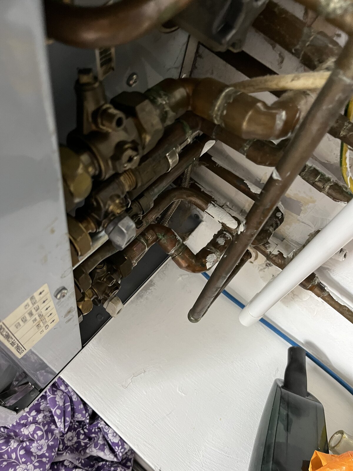

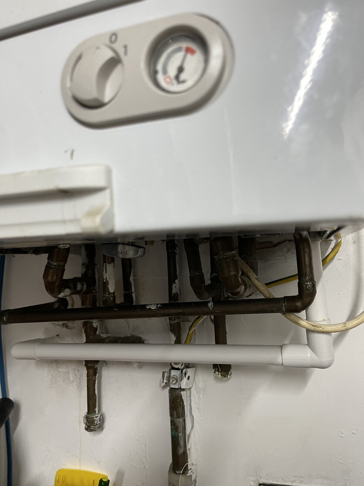

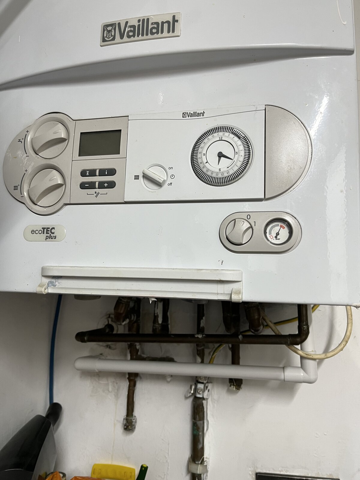

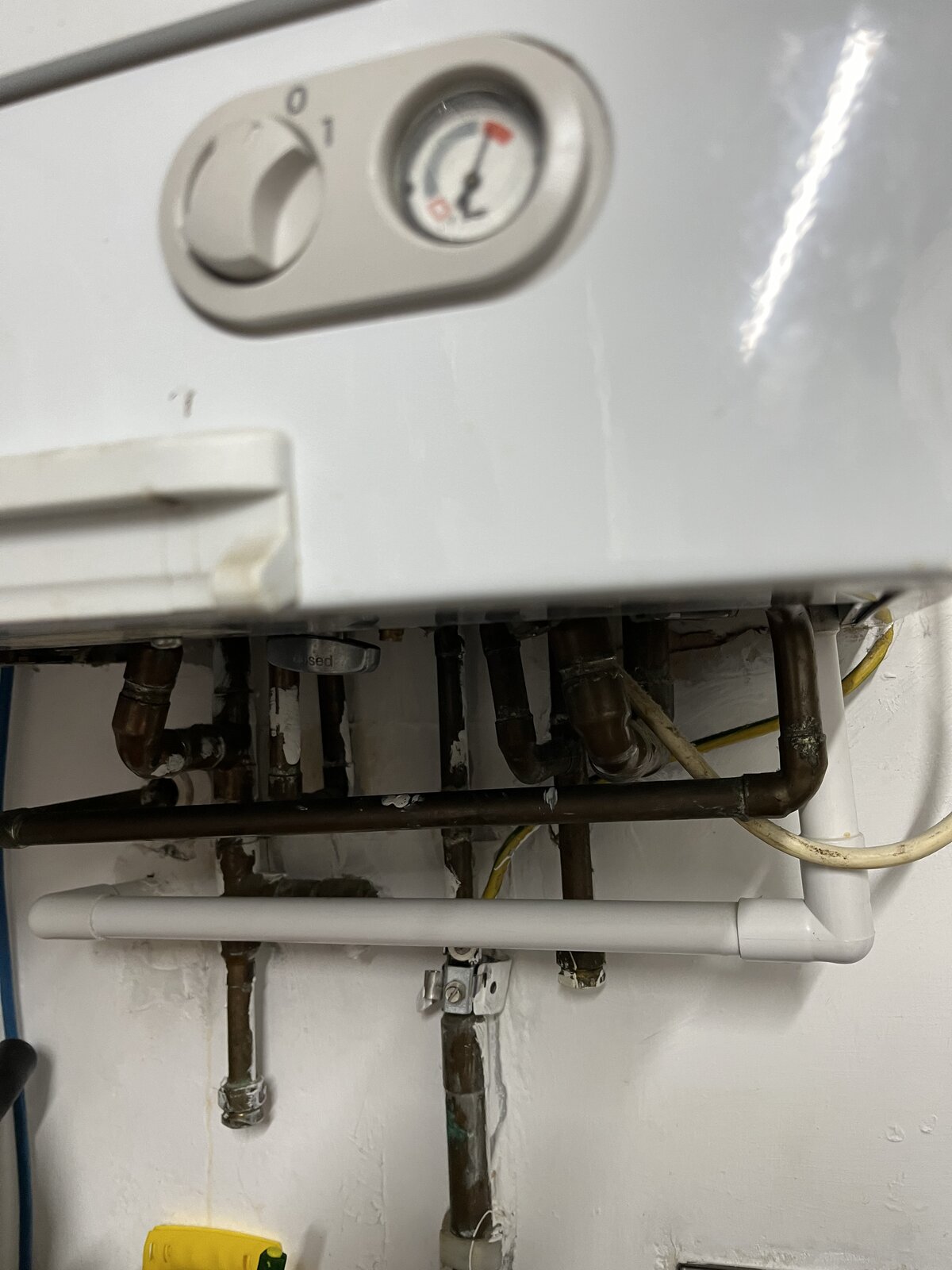

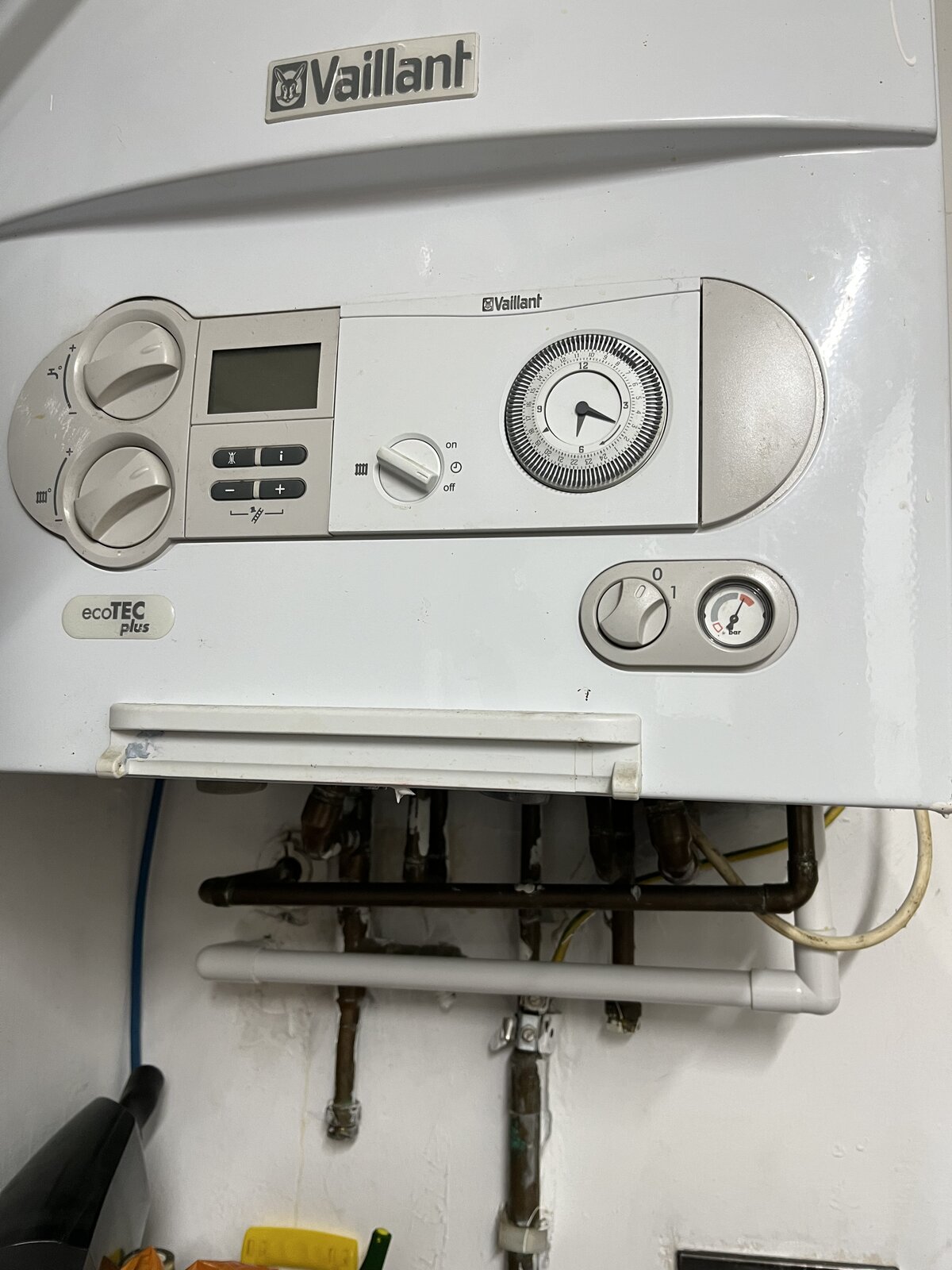

I mean the front cover. I hope you don't mean that?
Yes the bottom part is all open . I guess there was a front part to it, it’s only the flap that an engineer would open, not the whole of the front if the boiler.
Send a picture
That's the worst picture of a boiler I've ever seen.
Well done for turning off. With the heating on it could blow the PRV. But that's dangerous.
Looks ok imo. The fill valve @Mottie referred to is what you used to get the pressure back up. The pressure relief valve (prv) is preset to 3 bar, so even if you over pressurised, providing it’s working would be a fail safe, but likely need another if operated. You have done the right thing turning it off as you may have saved on a prv.
