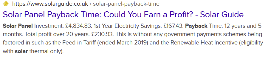

Is it??
That says you're in deficit for the first 12 years 5 months, and at the end of the 20 years, assuming they've needed no attention, you'll have made about £12 a year.
But surely 20 x 167.43 = £3346.80 so you're still ~£1500 DOWN?

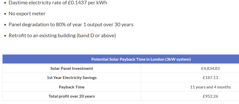

- they go on:
14.37p/unit!!
and that's a LOSS not a profit 20 x 187 - 4834 = -1094 per annum .
OK, cap rates are ______Current (since April)_________|_______Previous
(why did the standing charge have to double?????????????)
The cap unit price is currently double their 14p. So for 20 years:
187 x 2 x 20 -4800 = Saving of 2680.
Divide by 20 gives 134
That's one car tyre a year. Whoopy doo.
Is it??
- they go on:
14.37p/unit!!
That site has crap numbers.
Anyone paying £5,000 for a 3kW system is being taken for a ride.
Anyone who's expecting to pay 15p/kWh for the next decade is on an amazing fixed deal.
Scale up to a modern system of 6kW at around £7-8k generating around 6,000kWh a year in London and a price of 20p/kWh, SEG of 5p/kWh and self consumption of 30% and the numbers work out much better. That's something like £600 a year savings.
Factor in October's cap and you're paying it off in single figures. But that's over optimistic, I would stick with 20p as a long term average.
