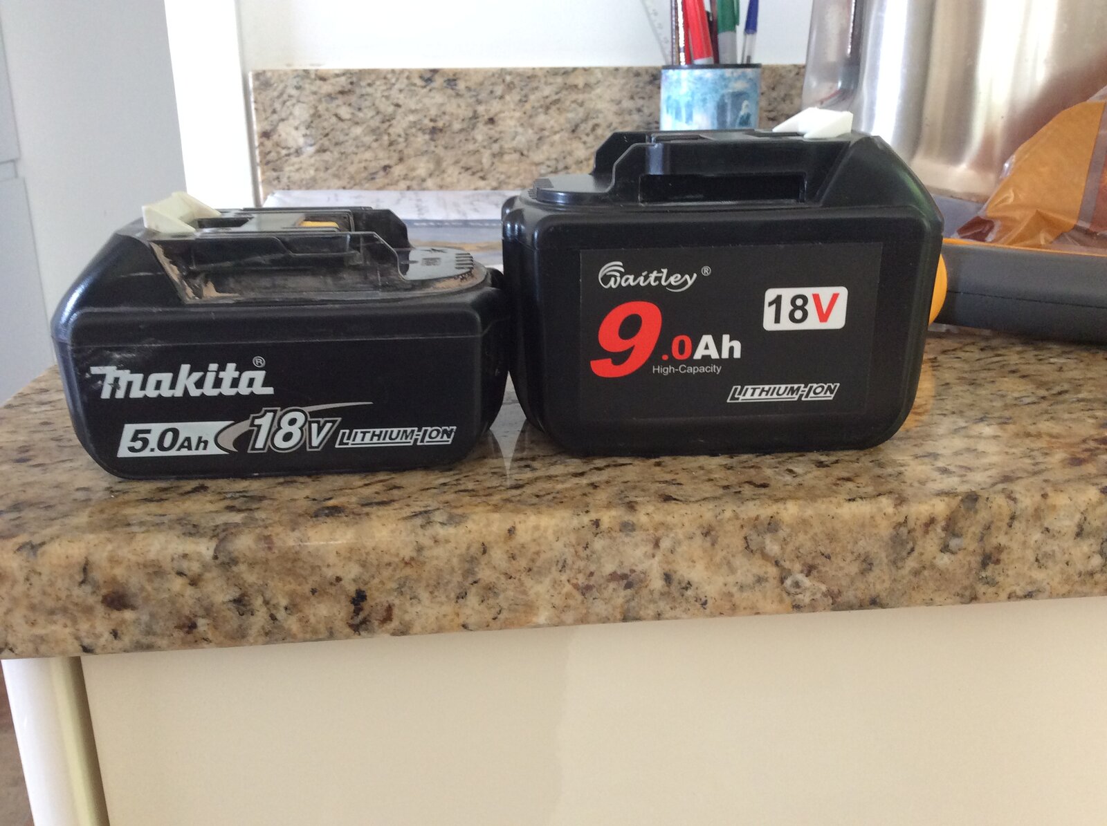

Price of lithium ion batteries
9ah half the size of 5ah...
How is that possible?
Because what I wrote was, "The 9Ah are about half as big again as the 5Ah ones, so not that big..."
- or in other words one and a half times as large, innit?

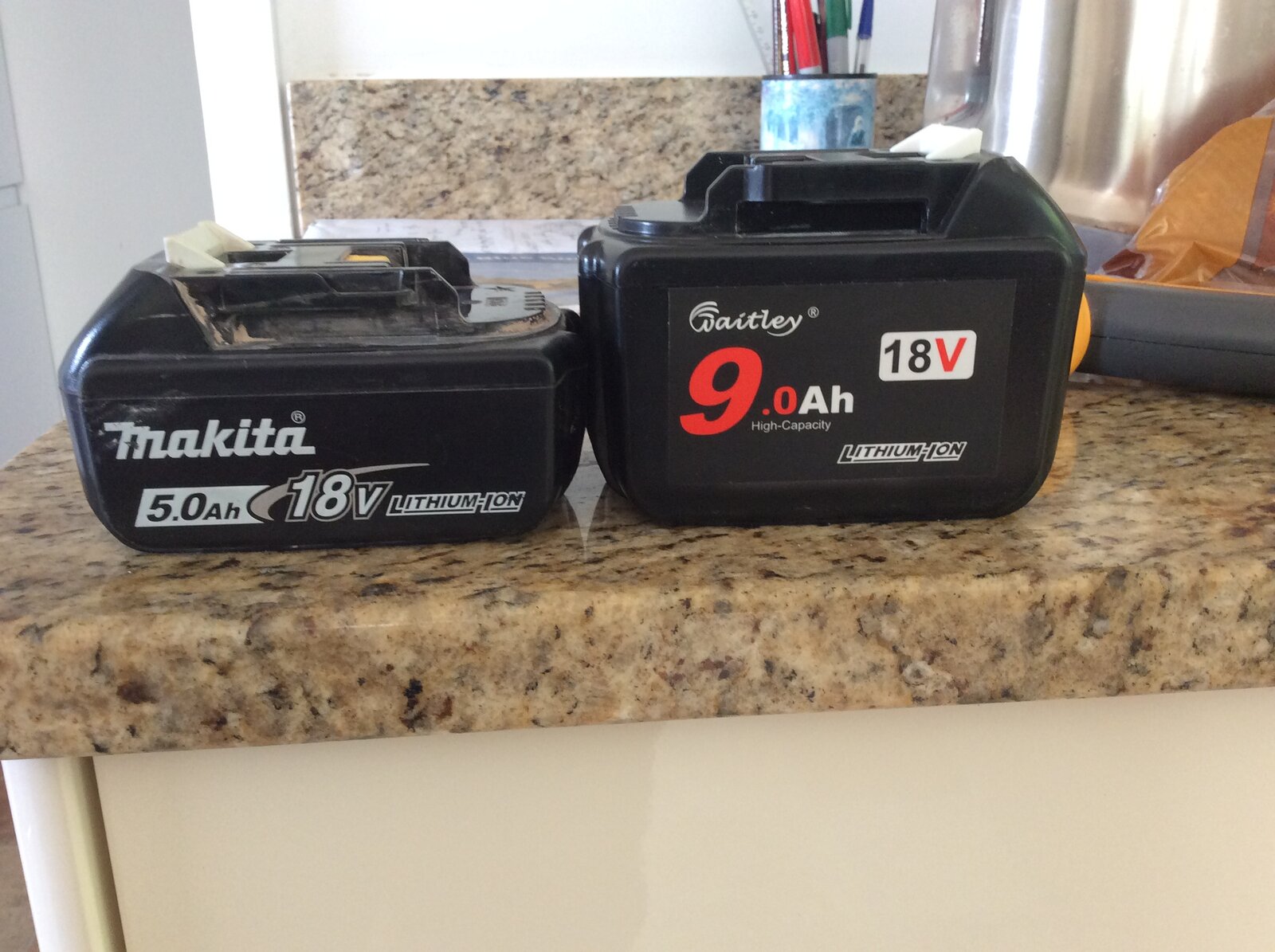

I weighed a 5ah makita and 9ah Waitley battery to see if I could work out, on paper at least how much was in the latter.
Makita 625gms = 125 gms/ah
Waitley 875gms = 97gm/ah
So by my reckoning the Waitley is closer to 7ah unless they can extract more ah from less weight?
Ive not tried the battery yet but will be interesting how well it performs in my Battery eating chainsaw.

In use I find they are more like having two 4Ah batteries, possibly because there is a lower discharge limit that the tool won't let you exceed. In any case even at 7Ah they still last longer than a 5Ah and are a lower price...

Just an update from my post regarding my assumed 7ah of the Waitley 9ah purely by comparing the weight to a Makita 5ah .
Ive just charged a flat 5ah Makita battery plugged in via an energy monitor which registered 100watts to fully charge.
I then repeated with the Waitley 9ah one and it took 150watts to charge so read into that what you will:)
Based on my experience of how the Waitley has been performing over the last year I wouldn't think my 7 ah assessment was too far out and am more than please with the cost per ah of them
