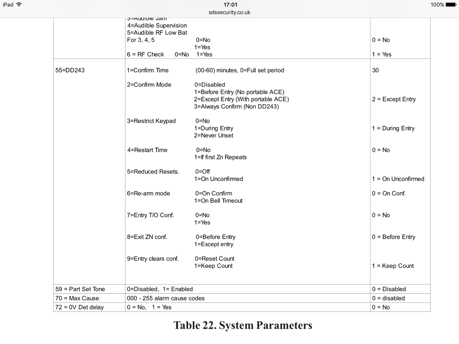

Hello,
I recently replaced an old galaxy panel with a new 2-44+ version along with a new keypad and a few new PIRs, all with the help of a friend who used to work for an alarm company.
I thought everything was setup properly, but I have a problem! The alarm sets ok, but when you attemp to unset it by entering the code nothing happens. After more than a minute it will accept the code, then prompts for a user reset before going back to normal. All I can find related to this problem is a comment ensuring that the door contact is set to final and the pir in the hall (where the keypad is) is set to exit, both of which I have checked.
Any help will be greatly appreciated! I should add that my friend with the experience is away and out of reach arm but I do know all the codes and am an electronic engineer!
Thanks!
Sounds like it's set for the fob to unset the system ...this option may need turning off
Option 55 / 3
Galaxy guy will confirm as a tad rusty on the galaxy
Well that was quick! Thanks for the help, problem solved! I was worried it was going to be a hardware or earthing problem. I wonder how that option was turned on? Everything was working well last week!

Hi, thanks for sorting out the OP's issue Mark. I've been a bit busy lately.
The DD243 setting to restrict to a tag unset when the system is full set is an option required by the standards for a grade 2 system. It's there to force the use of a prox tag. A crazy option really, as it can lead to false alarms where the occupier knows the code, but doesn't have their tag to hand. Anyway, that's standards for you.
