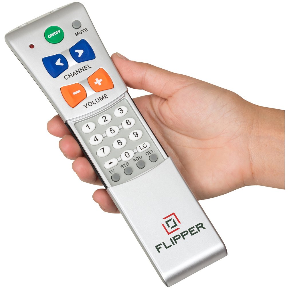

The problem is items for the disabled are often not what able people want. The one shown with cover slid in place is great for my Mother however for me I want to be able to use the electronic program guide and access recorded programs and even with slide open one has lost many of the features of a standard Sky remote control.
