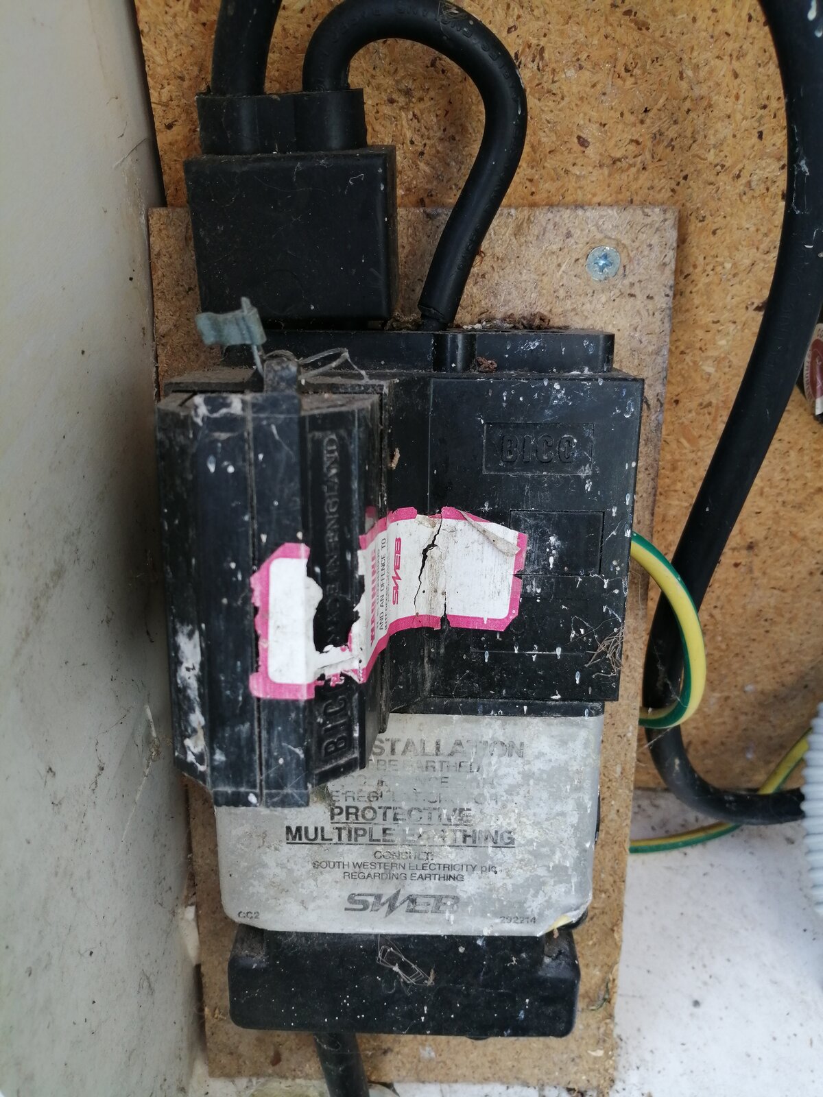

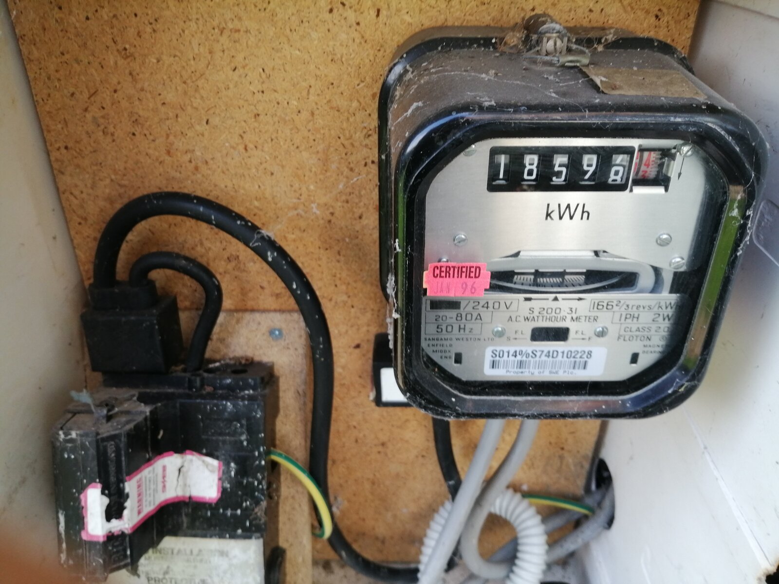

I can only point out that the sticky label on the supplier's equipment says "Protective Multiple Earth". The house is on a modern estate in Devon and was built in 1996. I'll try to upload a photo and post it separately. I'm not aware of an earthing rod being visible.

Photos below.

Saying its not desirable is going a little far, however DNO's are getting $hitty with people installing things in meter cabinetts. I thought a corner of the cab could be used for customer equipment.
Anyway, if you wish to avoid that, there is an alternative of putting a small switched fuse inside the house, close to the meter cab (within 3m of the meter), and then a cable going out again to the garage. Maybe that would work better for you, should to wish to avoid Controversial issues
