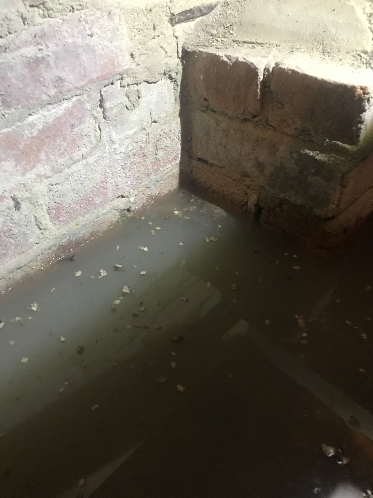

Please could you assist me with a stinky situation that has lead to the underfloor of my house being flooded with sewage?

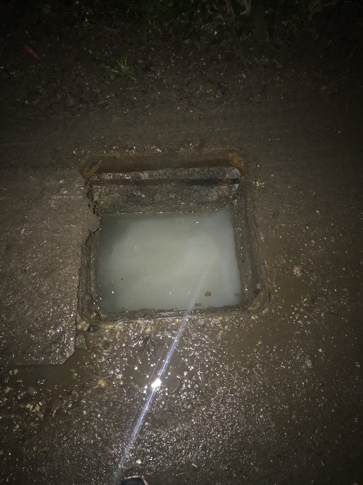

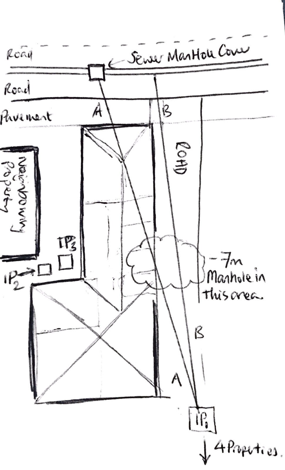

Around Sept 2017, the street that I share with 4 other properties became flooded with sewage twice in a short period of time. The sewage was escaping from an inspection point (IP1 on diagram) towards the read of my house. The source of the leak was slightly elevated relative to the floor of my house. The water/drains company attendend, and on each occasion they cleared an obstuction about 7m from the inspeciton point.
Now, approx 3m later, there has been a similar incident, but the results were a little more unpleasant. A few days ago we noticed that the drains weren't clearning very well. There hadnt been any issues on the road like last time, so assumed it was a local problem and applied drain cleaner over night. In the morning, noticed that things hadn't improved, but left it for the time being. Later that day, I heard what sounded like a large rush of water, followed by the toilets gurgline and with their water levels sitting low. Within a few minutes there was a terrible smell. I manged to figure out that the smell was coming from underneath the house so opened up the floor with the intention of going down to take a look. Unfortunately, the entire sub floor had become flooded with stinky water to a depth of about 1.5 inches.
Still assuming it was an internal issue, I called a company out to inspect. The first thing they checked was the inspection point that had previously overflowed, and found that it had again become blocked, though this time instead of overflowing into the road, it had managed to find a way into my uderfloor.

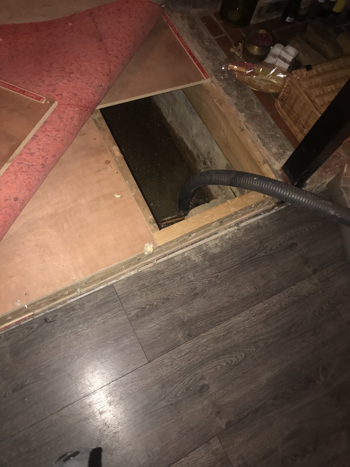

They put me on to the water company, and they came out for a third time to unblock the street drain. Again there was a blockage around the 7m point. After unblocking, they hoovered out the internal flooding as best they could and performed a CCTV inspection.

- At the 7 meter mark, there was another manhole and what looked to be my property joining the drain from the left hand side.
- Just past the manhole there is what looked like a sealed join from above.
They weren't able to locate the manhole in the street. It could be that it is burried under the road. Alternatively, it could be that is located under the property. I'm going to get a metal detector and try to resolve is location

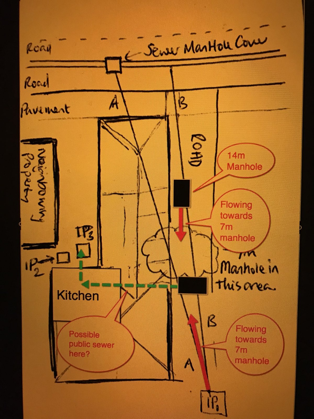

I've drawn a diagram of the layout as best I can. It's not clear to me whether the drains actually run in a straight line from IP1 to the main sewer manhole cover in the road (Marked by line A), or whether the drain runs from IP1 along the road next to my house (Marked by line B). Both of these possibilities seem odd though as (A) would run a shared public sewer under my house, and (B) would have it joining the main sewer away from the manhole in the road.
A few final bullet point facts...
Drain shared with 4 other proprties.
If the missing manhole is under the house, that part of the house was build in the 1980's.
There are two inspection points roughly directly opposite the 7m mark on the other side of the house (IP2 and IP3) on a neighbours land. It could be that these are running under my property into the 7m manhold spot, but I'm not sure at the.
My house joins drain after the inspection point
My working assumption is that I have something under my house such as a sealed manhole that is connected to the drains that were backing up. In the past it stayed shut, and the water backed up into the street, but this time it broke, and all the backed up water has escaped into my property. If this is the case, it's quite likely I'll have future issues whenever the public drain blocks.
I'm still trying to get my head around what has gone on. I'm waiting for the underfloor to dry out and probably go down there in a few days to investigate, but I'd really appreciate it if anybody could help on the on the following. x:
Any thoughts / suggestions on how so much water could have got from the sewer into the subfloor. It did not escape from up the toilet/bath/sinks. The onset of the smell was accomanied with quite a bit of rushing water and gurgling, so I'm assuming something just gave up, but I'm not sure what.

An insurance claim will deal with the damage, but I'm not sure if they'll deal with the cause. If there is a drain under your floorboards, then that needs changing for a sealed type. Now is there something at the 7m point that's snagging things and causing the blockage. Is there young kids in the other properties that they might be throwing nappies and wet wipes down the loo.
If a joint has come loose under the floor, then you'll carry on getting seepage into the floor, so they'll need to put a camera down your pipes to check for that next.

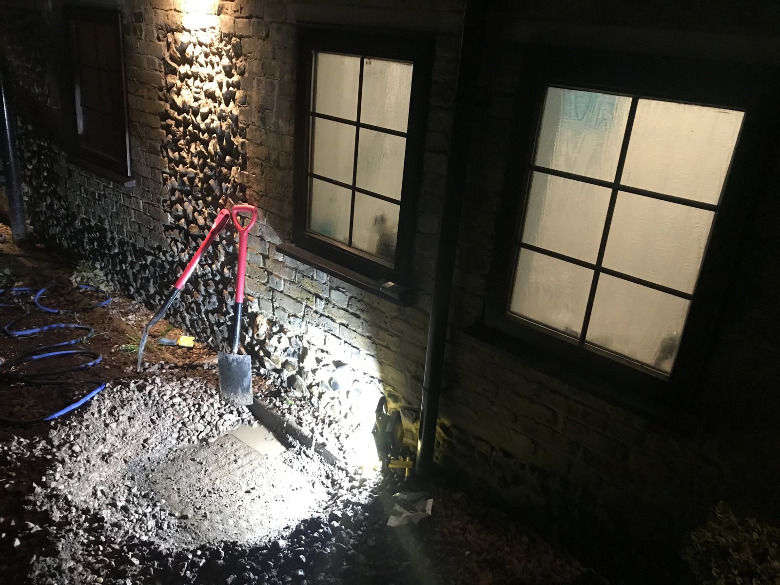

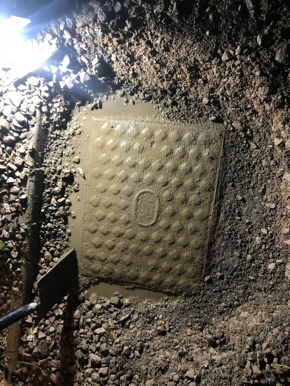

In other developments, I spoke to the previous owner of the house and he managed to help me locate a burried manhole. It wasn't at the distance that the CCTV found however, so there is a good chance it is a different one. This manhole was about 14m away from where they did the inspection (ie, an extra 7 m). Additionally, the connection was angled in the opposite direction to what I was expecting (ie, away from the main sewer), and the water was flowing back towards where the mystery buried manhole at the 7m point. Only the bathroom seemed to be feeding into it - the kitched appears to be going elsewhere...
I've updated the diagram to show this. I'm wondering if the two bits I know about meet and then run under my house, perhaps to the other inspection points (IP2 + IP3) that are on the neighbouring property. If it does run under my property, on one hand it is good as, despite being on private property, given it is serving multiple properties, I believe it is the water company's responsibility to look after it. On the flip side, it might be bad due to them possibly having the right to knock my house down to access them :)
I guess next steps are to have another discussion with the water company on the basis that issues with their drain has caused damage to my property, and it might be that there are shared drains under my house. I'll also approach a company about a drain survey and get this all mapped out.

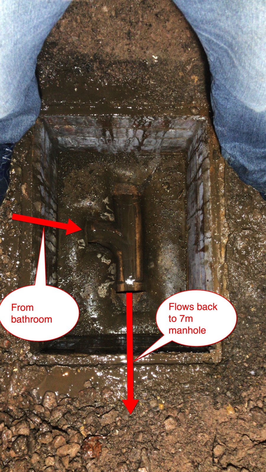

If it is like your drawing the 7mtr manhole would be a possible cause due to its design. Depending on the channel the bathroom waste could pass across it and flow upstream towards IP1 and then stop in the pipe, eventually causing a blockage.
That's just a guess though, if the other manhole is buried at the same depth you could find it with a shovel or metal rod of some kind.
You really need to locate all the chambers, and get an accurate idea of what's going where firstly. Once thats done, I'd CCTV any pipework under the property to ascertain it's condition, and look for any obvious defects.
There are 'no-dig' options available where practical, lining and/or patching can be done from existing chambers to provide a structural repair to damaged, and even collapsed pipework, subject to survey and situation. Excavation would be a last resort I think.
Does seem a bit odd though why the system isn't taking the most direct route to the road, do you know if the drainage predates the property?
