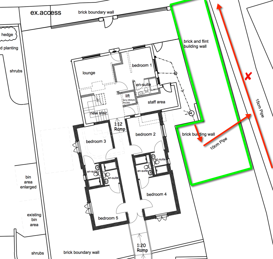

I had a look at the plans submitted to the council prior for the extension work at the care home. It shows 4 new bedroms with ensuites. I've attached the plans below for the curious. The original property also has a upstairs ensuite, so there are a total of 6 bathrooms running through the 10cm pipe and IC that bust. My house is marked in green. The 15cm pipe that runs along the street to the main sewer (just off screen to the top), serves 4 other houses that are upstream/off the bottom of the picture. The X marks where the original blockage was found.
Re the insurance and thames waters responses. They have both fobbed me off in the past, but this was prior to me having any evidence of the public sewer under the house. Insurance company told me that although they could assist with trace and restoration, and for putting right damaged caused, they wouldn't be involved in fixing the issue.
My last chat with TW was with them working on the assumption it was my own individual and private drains that were faulty, and as such it was up to me to locate and fix it. They had no record of a public sewer under my house. I did tell them I suspected that the neighbour was connected to me (shame I didn't check the diagram above), but until I had the drain survey done, I have no confirmation of this. The fact that it serves the neighbouring property makes it a TW issues. I'm not sure if I'm even allowed to repair it myself.
I'll write to TW at the weekend and let them know I've located the IC and it also serves another property and take it from there.

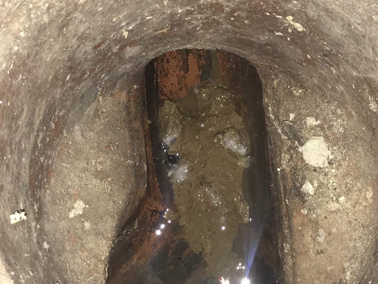

TL;DR summary: 9 months ago, house got flooded by sewage triggered by a blockage on the street drain that somehow managed find a route into my subfloor. Suspected it might be due to an unmapped public sewer that ran under my kitchen. Water company denied knowledge of it, so I had to arrange a drain survey myself to confirm. Using the survey I was able to locate an inspection chamber under my kitchen that had popped open due to the street drain being blocked. On the basis that it was part of a drain that served another property, I contacted the water company to discuss next steps...

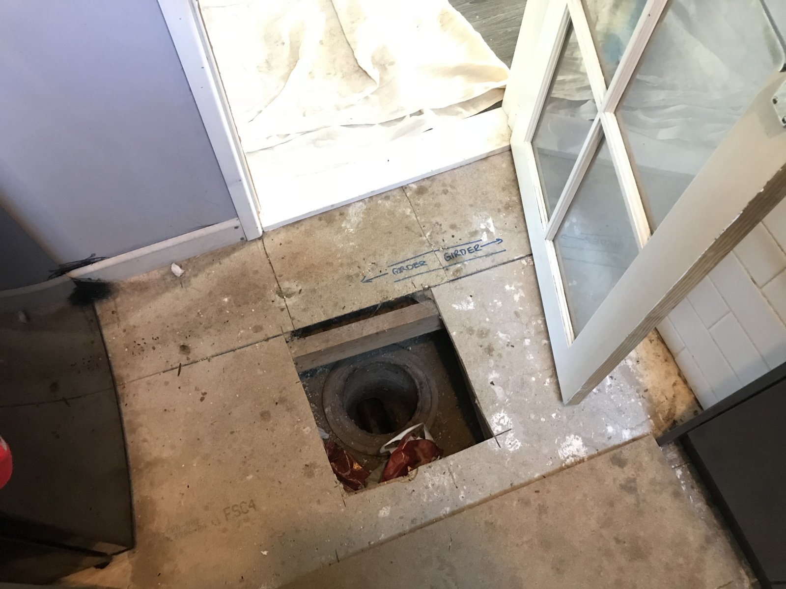

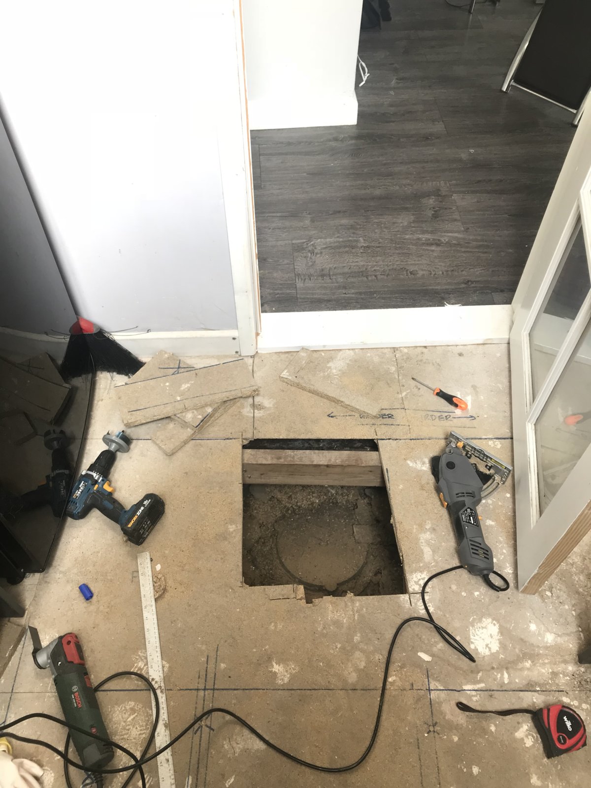

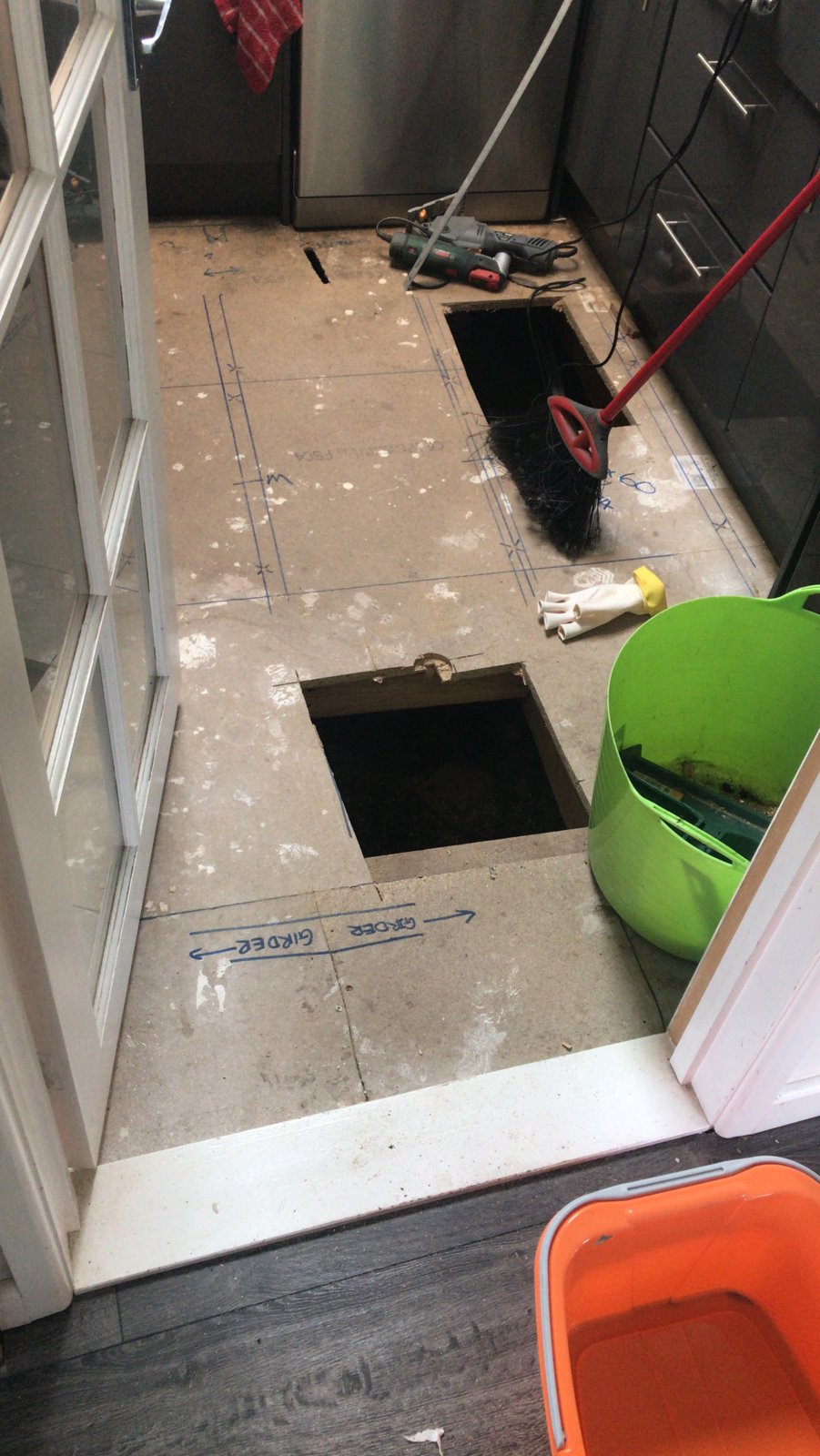

Here are two photos of the area where the work needs doing. It's not the largest space...
My understanding is that they will be fitting a double sealed vacuum inspection chamber.
Does anybody know what this would involve and the likelihood of them being able to do this with starting to take cabinets and/or joists out?
If they do end up trashing the kitchen, do I have any comeback on either the water company to put the damage right, or via my insurers trace and access style clauses?
Many thanks!
I thought you weren't allowed to have any sort of manhole underneath a floor?.
Thames have admitted its their asset, and thus their responsibility. Any damage caused by them or their asset is their responsibility. If they trash your kitchen, they are responsible for replacing it.
As for the work, it appears they will be fitting a double sealed cover, which hopefully will prevent any future reoccurrence of the internal flooding you experienced earlier this year. As long as they have suitable access to get themselves, the cover and frame, and materials/compounds required to fit this new cover, I cannot see they will need to do anything other than provide a suitably sized hole in your floor to do the work, if the existing access isn't suitable.

1. Yes - floor is still open, but covered. There are two holes in the original kitchen floor that I created whilst trying to locate the inspection chanmber. I've had temporary loft flooring down over the top for the last 6 months whilst waiting for them to confirm next steps (ie, whether I can / should fix it, or whether it's there's and not for me to touch).

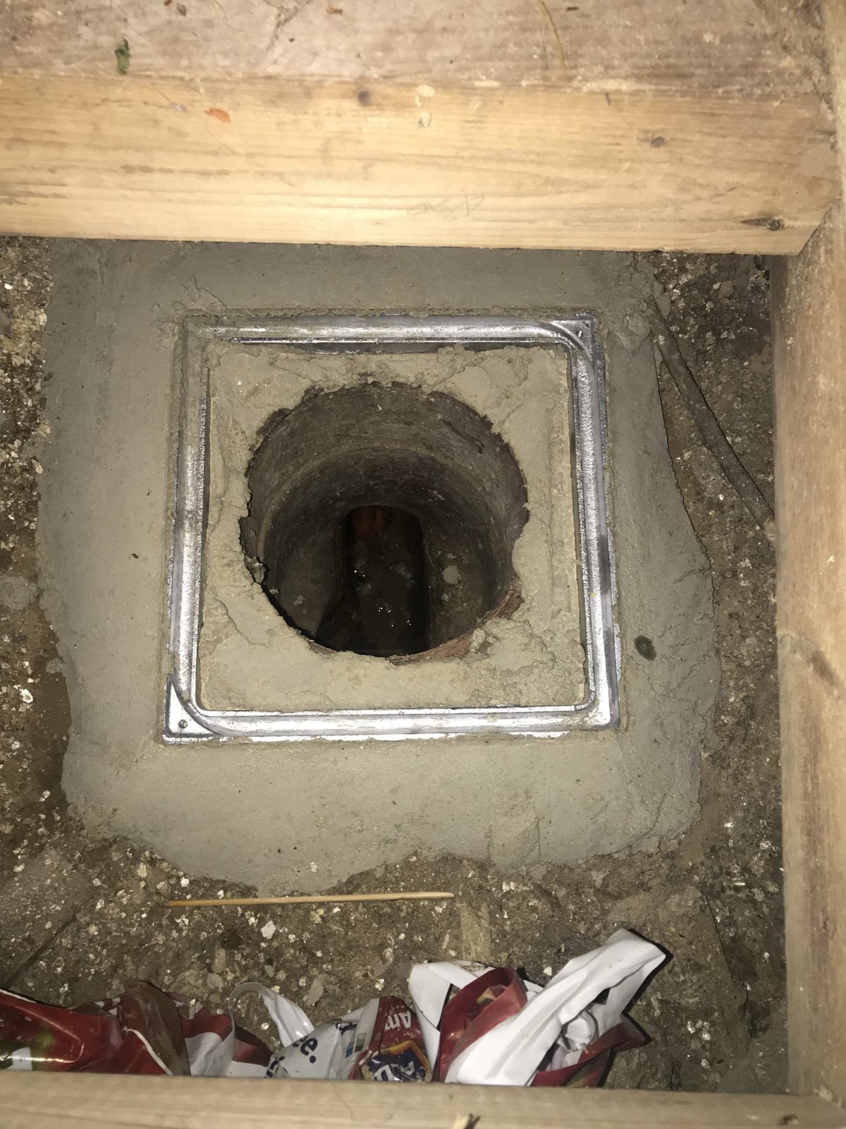

Hi All,
Finally managed to get Thames to take responsibility and come around to try and sort things out. Some good new was that access wasn't an issue, though things haven't quite gone as I was expecting.
Recall original the original clay chamber, round inspection chamber...

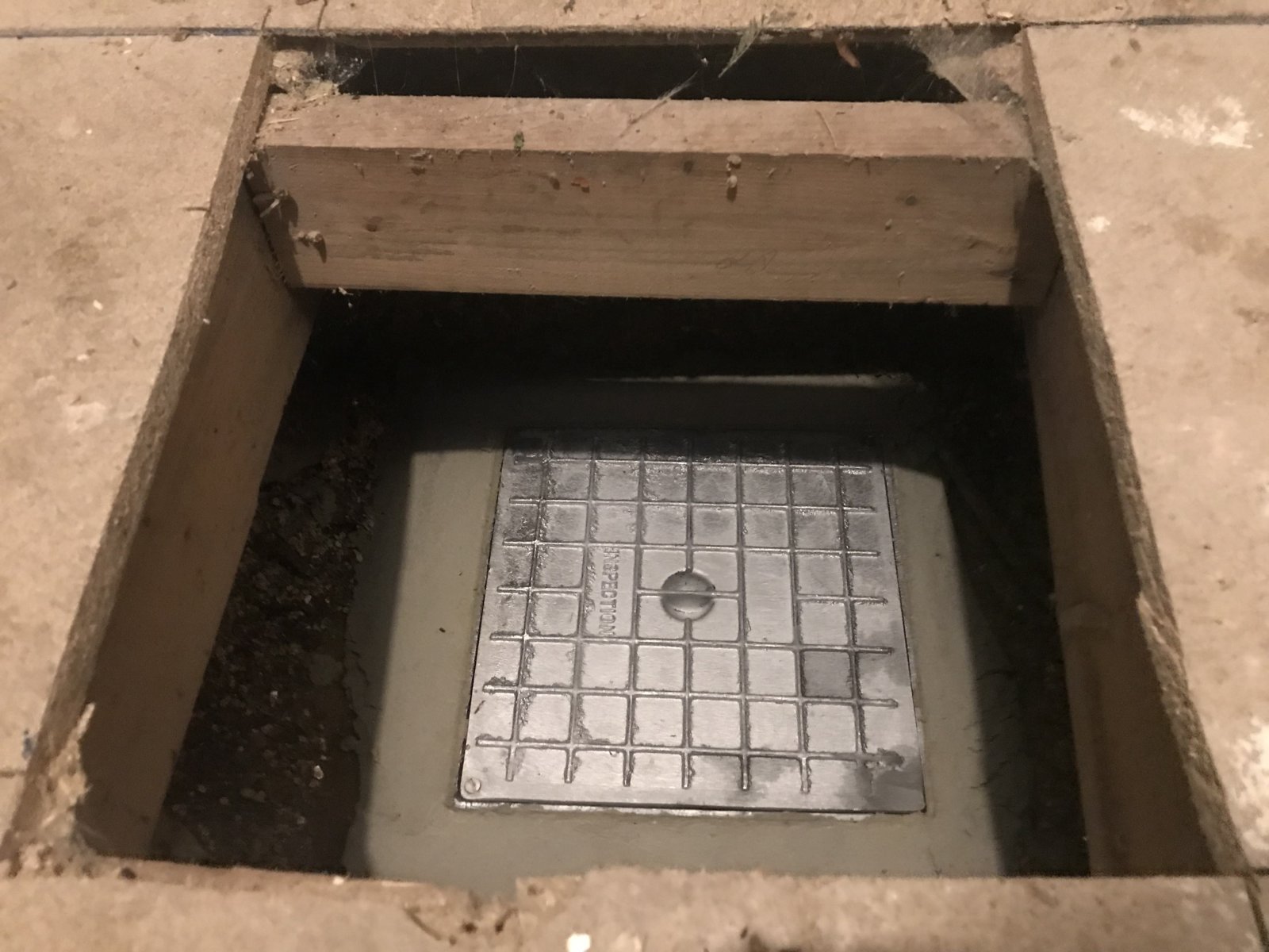

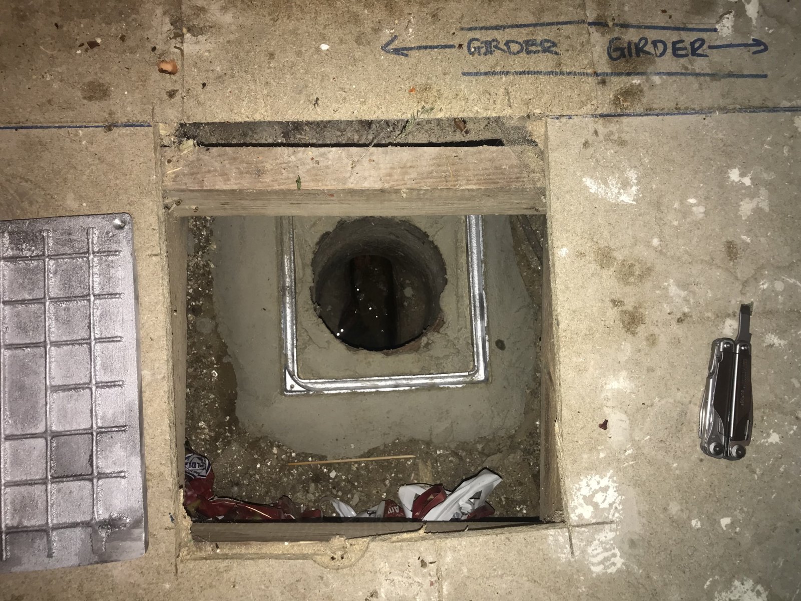

I was expecting them to seal it with an air tight / leak proof cover, but instead got the following:
Not quite the water tight setup I has hoping for... more like an unsealed oversized square cover, placed a top of a round hole, cemented to the dirt floor :)

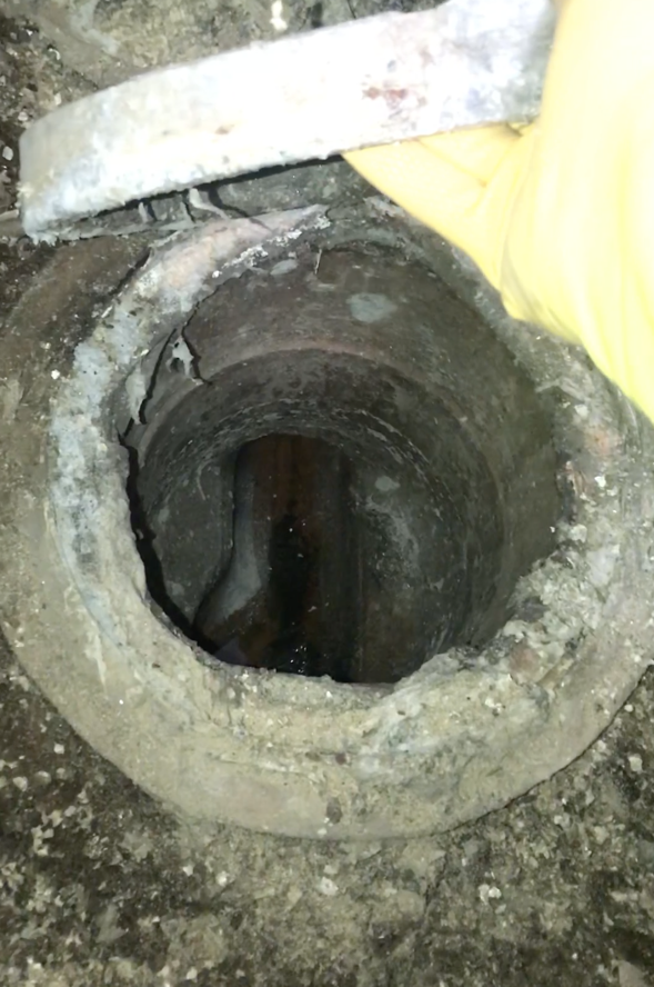

Just for fun, they also managed to drop cement into the junction:
I honestly never thought I'd find myself poking things with sticks and hoping that they were the neighbours poop.
I'll go back to Thames again and start reading the riot act. As was suggested above, this is environmental services time.
Does anybody have any thoughts on how hard it might be to remove that cement without damaging the drains? I think I'm one neighbouring wet wipe away from a new sewage flood :)
Very easy to remove.
They should have moved it but to be fair to them whoever put the manhole there is the one that needs a *******ing.
There’s not much else they could have done, the lid they have fitted is much better than the round one that it will have replaced.
