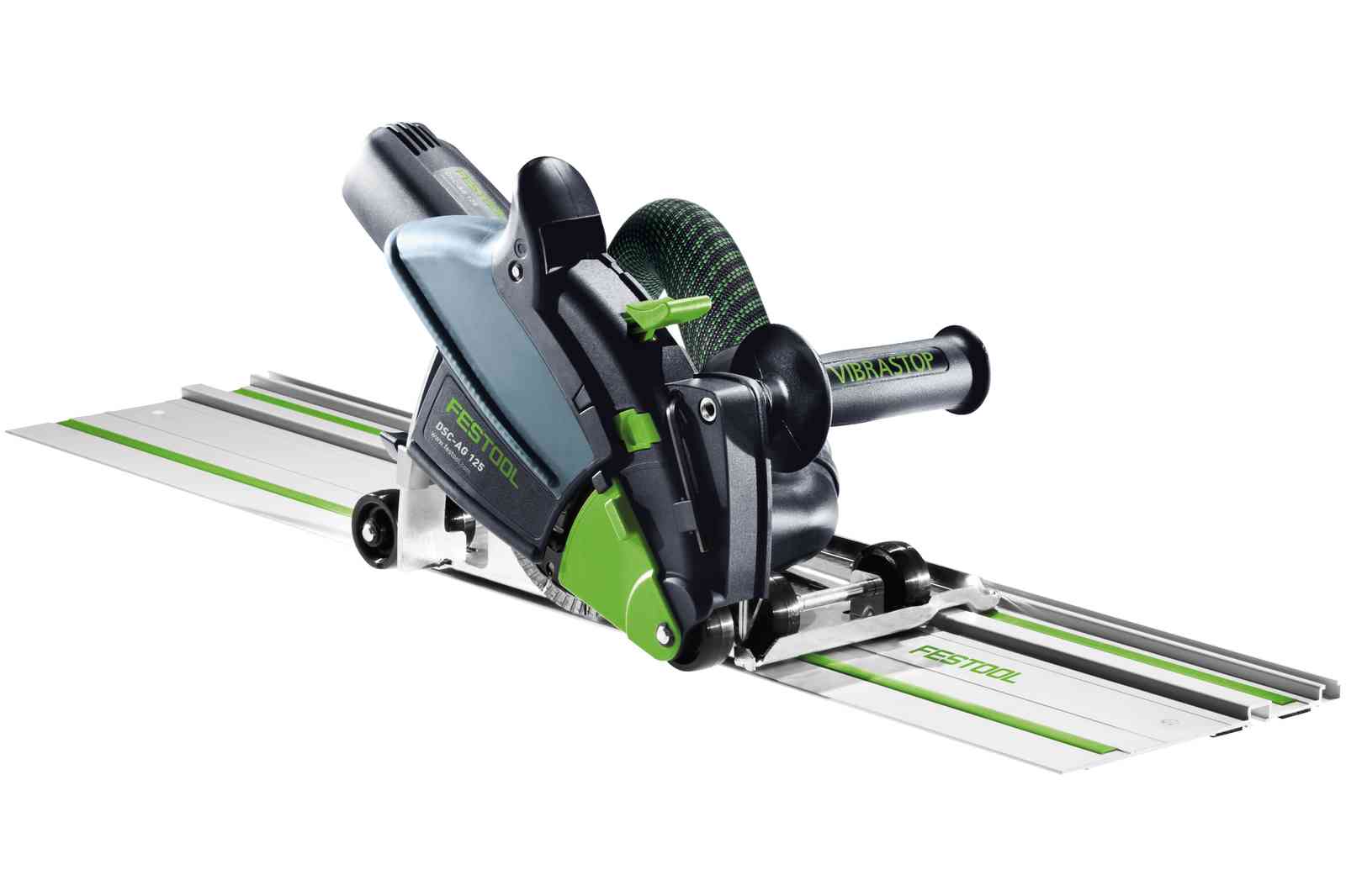

For what it is worth, a couple of months ago they had to remove the render from a semi-detached house, both properties were rendered. They got me to grind a vertical score line between the two properties, and yes, my Festool grinder was connected to a dust extractor.
