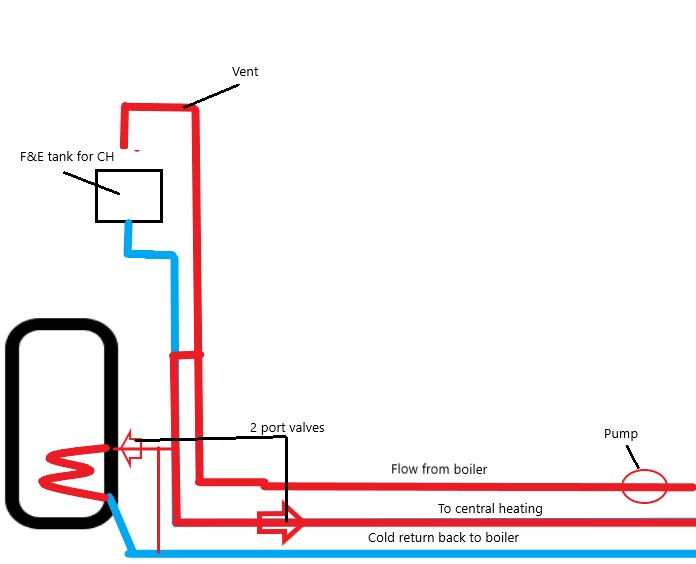

Ok .. just doing some more investigation, and the header tank heating up seems more prevalent when just the water cyl/tank is being heated and central heating valve is off. I think I may have worked out why, or what will probably be making the matter worse. It looks like the route for the heating water from the main 22mm feed and return pipe going to and from the boiler is just a 15mm pipe with the water cyl control valve on. However the exit from the hot water tank coil is still 22mm. Surely this will restrict the water flow into the cylinder heat coil, meaning it will take a lesser path of resistance which is up the feed pipe into the tank. Which i presume is why every now and again i get a glug which is the warm water from the boiler making its way into the header tank.
I cant really get any decent pictures, so will try and draw a diagram of whats going on to help.
Cheers all.
Ok .. dodgy drawing i know... but hopefully this gives you an idea of whats going on. The pipe thicknesses are to show 22mm vs 15mm. I would think that 15mm pipe is restricting the flow when the CH valve is closed so the water is finding its way up the cold feed pipe. Or would that not be an issue?
here are also a load of red turning isolating valves in places. There is one on that weird small bypass pipe, and one on the 22mm pipe coming out of the bottom of the cyl. I have read they could be for balancing the system. They are all wide open though now, as the boiler is firing restricted flow errors when just the hot water is on. I think ideally that pump should bejust after that cold feed pipe from the F&E tank, but getting wiring from the boiler to there is going to be a right old nightmare from what i can see, unless i could run a cable externally maybe (is that a possibility, or against some sort of regs?)

I'm not sure I understand your layout sketch. Can you do one showing the boiler as well? preferably with the various bits of kit grouped to give some idea of locations and levels.
If your drawing was accurate the vent would be running continually every time the pump ran, have another look and see if you have the pipe layout accurate.

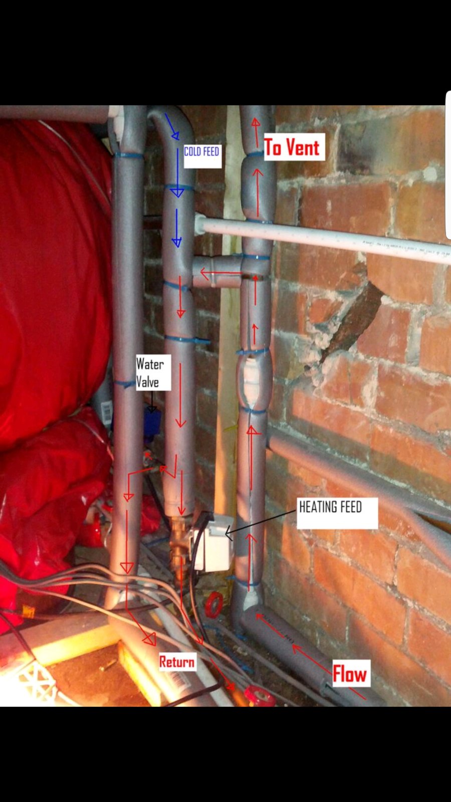

Basically, all that stuff on the left of the picture is up in the loft, the boiler is on the ground floor at the back of the house with the pump right after it on the flow pipe. I have attached a picture but the pipe labelled return is incorrect. I think that's actually the hit water going to the taps etc.... The pipe that's actually returning to the boiler is the white plastic one you can see that comes out the bottom of the cyl
I can't see that anything is coming out the vent when I've monitored it for a while, but I presume it's because it's quite high so it finds its way round the junction to the cold feed before actually making it to the end of the vent. It does get quite warm so I presume some hot water is making it up the vent, but just not far enough to come out the end of it. However it is making it up the cold feed as you hear it glug every now and again when only heating water not CH. So I guess that's either hot water or air. Given the f and e water warms up I presume its actually warm water making it up there.
