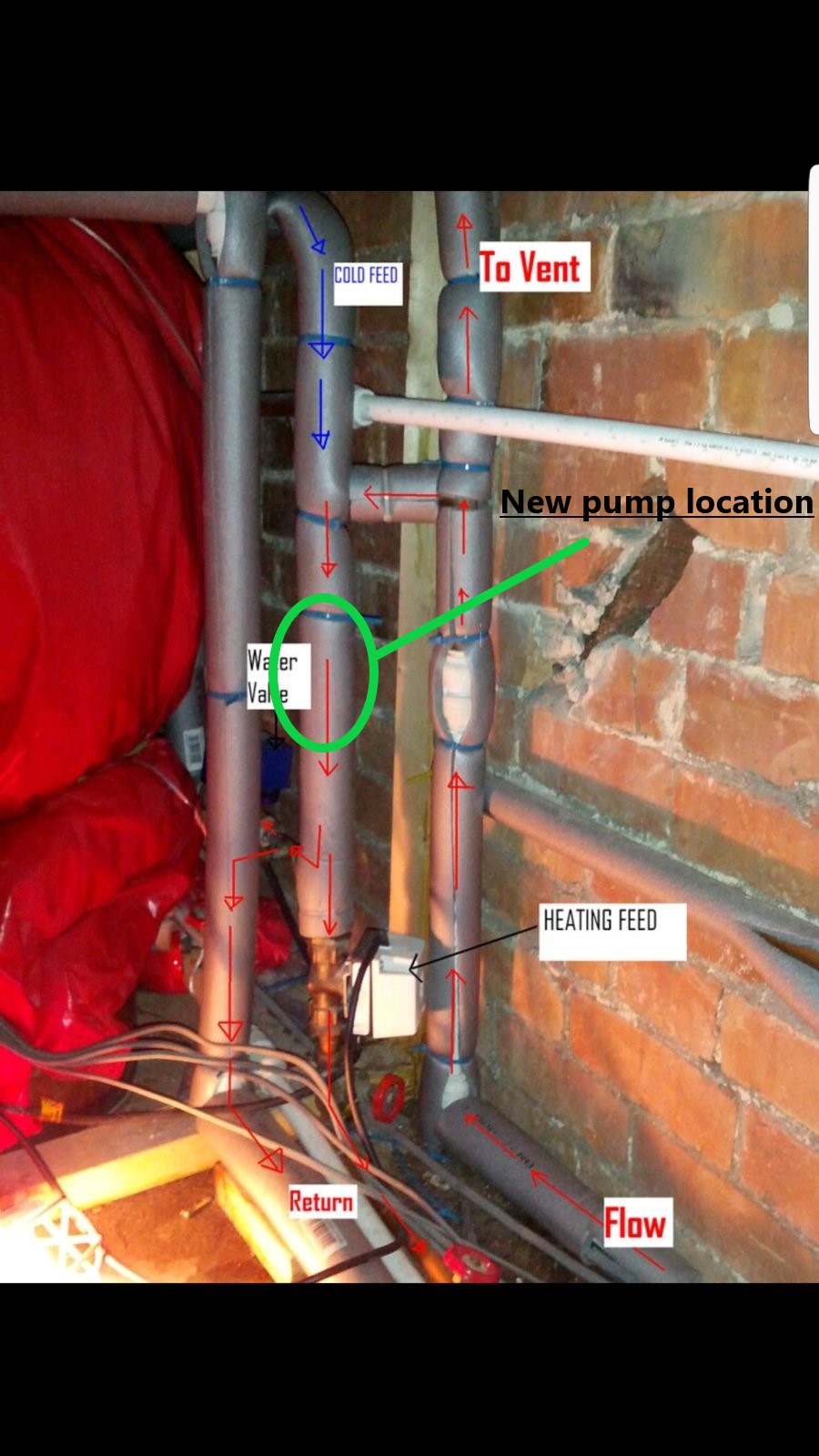

Pump in wrong place on Open Vent system...

Either get the fed and vent altered. Or relocate the pump to the boiler return.

Ok....pump location seems to be the one..... would you agree that this is the place the pump should be (green circle)? Ignore the return label on the pipe, that's actually hot water to taps... The pipe returning to the boiler is actually the white pipe running in the same direction to the right of it. Oh, and the picture doesn't show it very well but there is a manual bypass 15mm pipe that goes from flow to return for when both valves are shut.
Yes, but remember it needs to be controlled by the boiler.
Yup this is my main concern really due to locations of bothe the boiler and the vent/valves etc....

We do have a system bypass that links from the flow back to the return before the two 2 port valves.
The 15mm pipe isn't the bypass, as I can see the bypass separately. That is also a 15mm pipe, but that goes from flow to return before any of the 2 port valves, and has a manual red handled isolation twisty thing on it, its open by about 2 or 3 turns from closed.
If the valve is open, even half a turn, it is acting as a bypass sending water straight back to the boiler without going through the rads or HW cylinder.
Where is the system bypass you mention - it's not shown on any diagram or visible in the pics?
Is it a automatic bypass and has it been set correctly?
Its a manual red turny handle type bypass, not automatic.
I watched a video yesterday that explained to just open it slightly, just to let a little water get through for when the valves arte shut down by the stats/clock. However, when both valves shut the boiler should stop firing, but there is the pump overrun to think about for a short while, so a little water needs to still get round. If i shut it completely this would be an issue surely?
Its on the sketch, its the little thin red pipe coming down to the fatter return pipe. It is also shown in the picture coming off left from the flow to the water valve, coming down to the return. You cant make out the pipe but i have drawn some red arrows on there showing its direction.
I got confused and thought that the bypass was something separate from the 15mm pipe with a gate valve on it. You should replace the gate valve with
an automatic bypass valve. At the moment hot water is continually going straight from the boiler flow to the return, which increases the return temperature. This reduces the ability of the boiler to condense.
