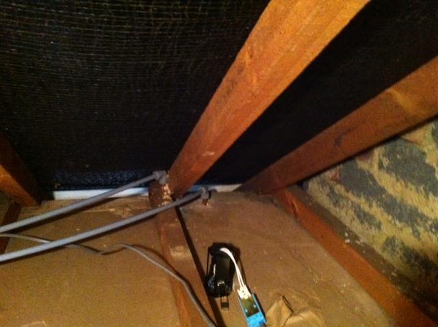

Hi there, I'm new to this forum and desperate for some advice regarding a recent flood at my Mum's house following a disastrous fit of a recent bathroom. Luckily I was the one taking a shower when I noticed a complete loss of pressure and then water started to come through the ceiling lights and eventually through the ceiling. The pump was continuing to run and I could not turn off the shower. It's not a power shower but run from a 3 bar pump in the airing cupboard next door.
I managed to pull the power from the pump and isolate the leak by turning water off.

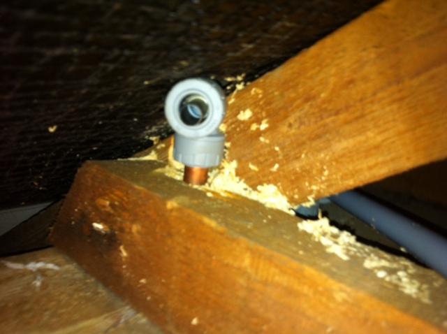

When I went into the loft I could see the 15mm plastic hot water pipe had come away from the push fit connection connecting it to a copper pipe at a right angle bend going down into the bathroom to the shower. When we called a plumber he said it was not installed correctly and shouldn't happen again and simply pushed it back but when I called the pump manufacturer and showed them the picture they said it will happen again as you shouldn't connect plastic to copper like that and should solder a copper extension to the current pipe and connect at a straight instead. Also I notice they have gone right through a timber beam down into the bathroom on the pipe that came off. Does that create any vibration issues that may have lead to the pipe coming off again? This is in my disabled Mum's house and paranoid this will happen again when she is taking a shower and not so lucky being alone so really need some good advice to ensure this never happens again.
I haven't got a picture of the end of the pipe that popped but it just looks like the end of a hose pipe with no connections at all.
HELP!

plastic to copper connections
connections of plastic 15mm pipe to copper pipes coming up from bathroom.
