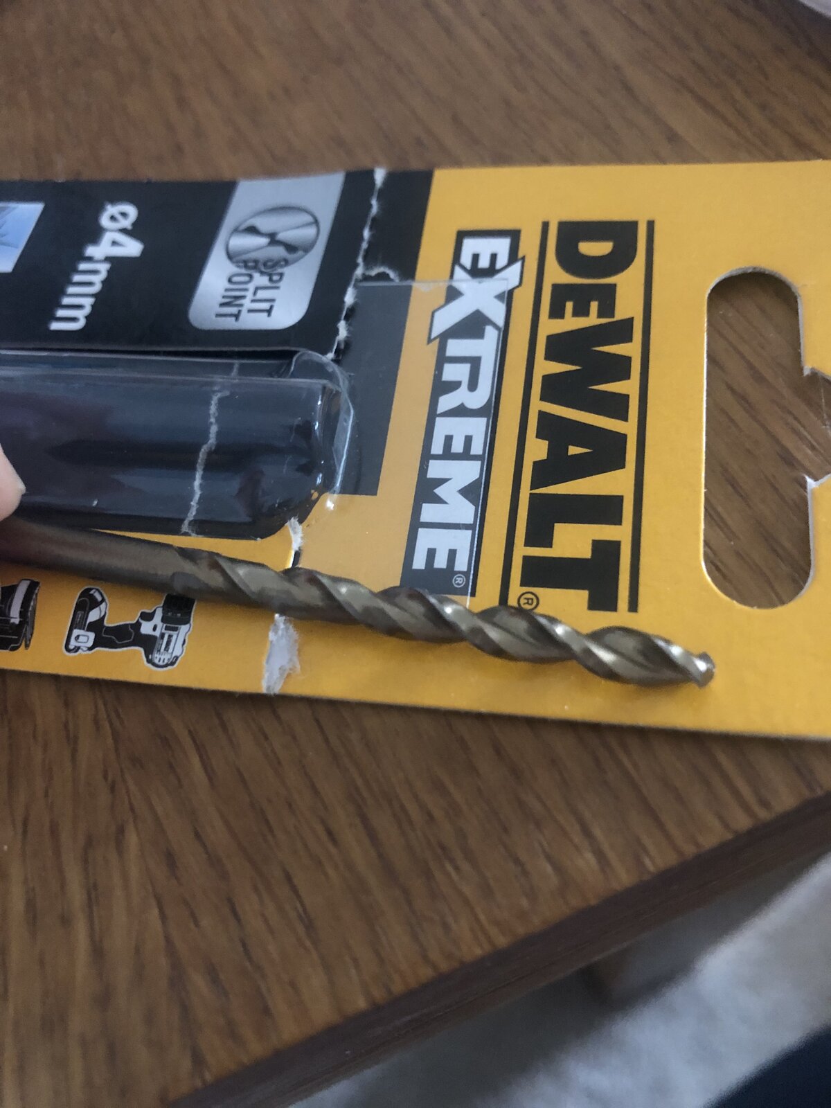

Ok so I bought a HSS drill bit and gave it another go in a couple of different positions and still no joy. I'm not 100% certain that it's metal as the drill bit didn't seem to have any metal shavings on it and a white dust was coming out. Any ideas?

Can you photograph the tips of your drill bits please so we can see how sharp they are.

This is the HSS drill bit I was using it's the DeWalt Extreme 4mm.

please photograph your masonry bit.
the hss drill tip is not well focussed in your pic. Is it blunt and rounded? You must not use hammer on hss.
Am 18v hammer drill will drill into blocks OK, but into reinforced concrete will take quite a while. You can put a mark on the shaft of the drill and watch to see if it has gone in after a minute

Kind of but there's not steel shavings coming off it more of a white powder comes out. I also didn't have it on the hammer setting when using the HSS drill bit as I read that might blunt the drill bit, but I did when using the masonry one.
