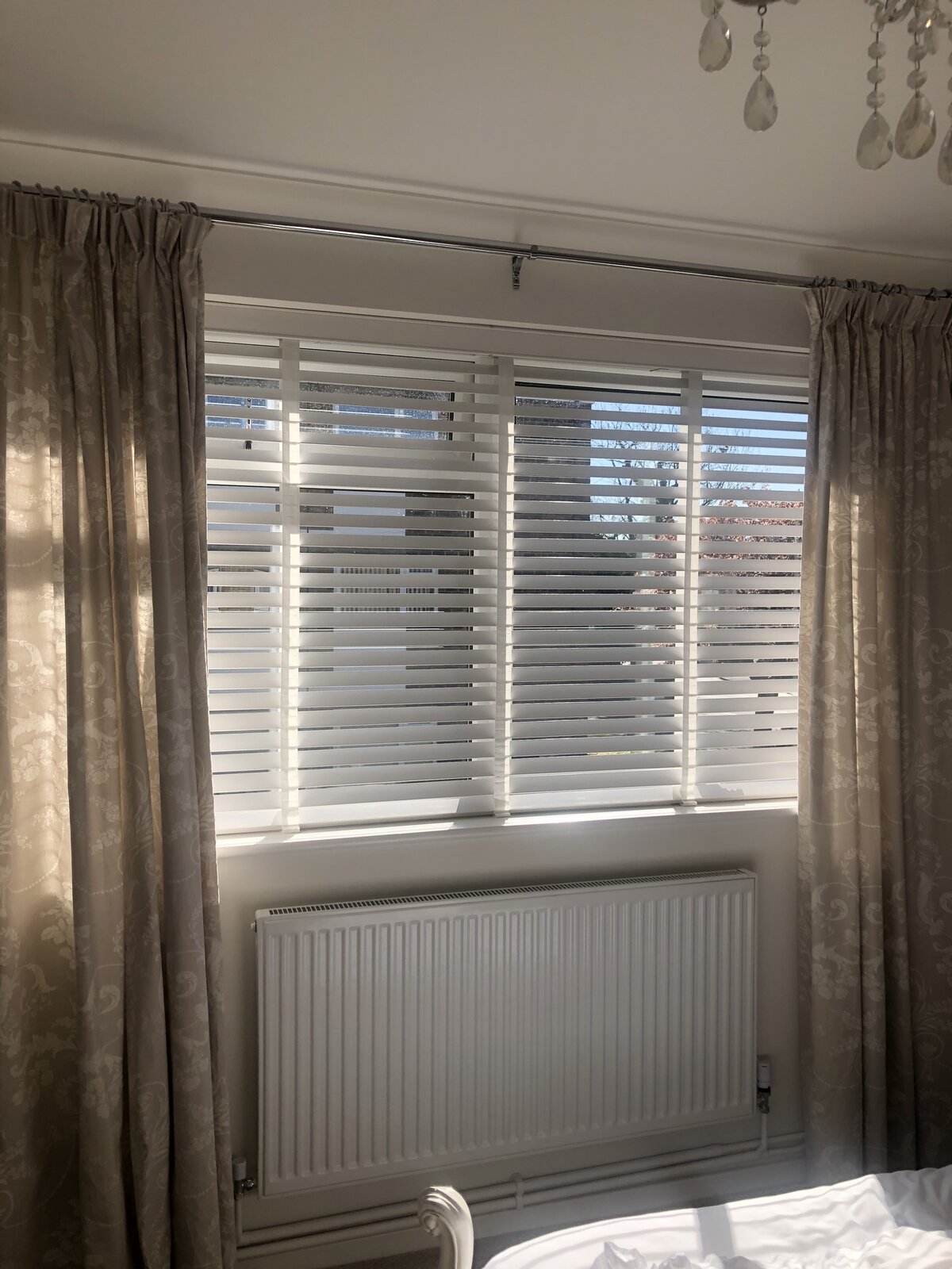

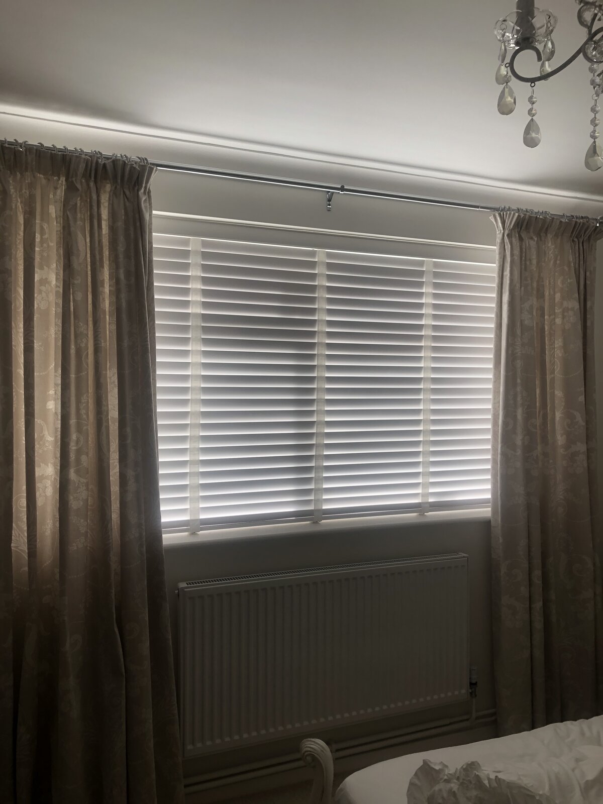

Update: I admitted defeat in the end and got a handyman to come round to help, it was concrete lintel and he managed to get through it with an SDS drill.
