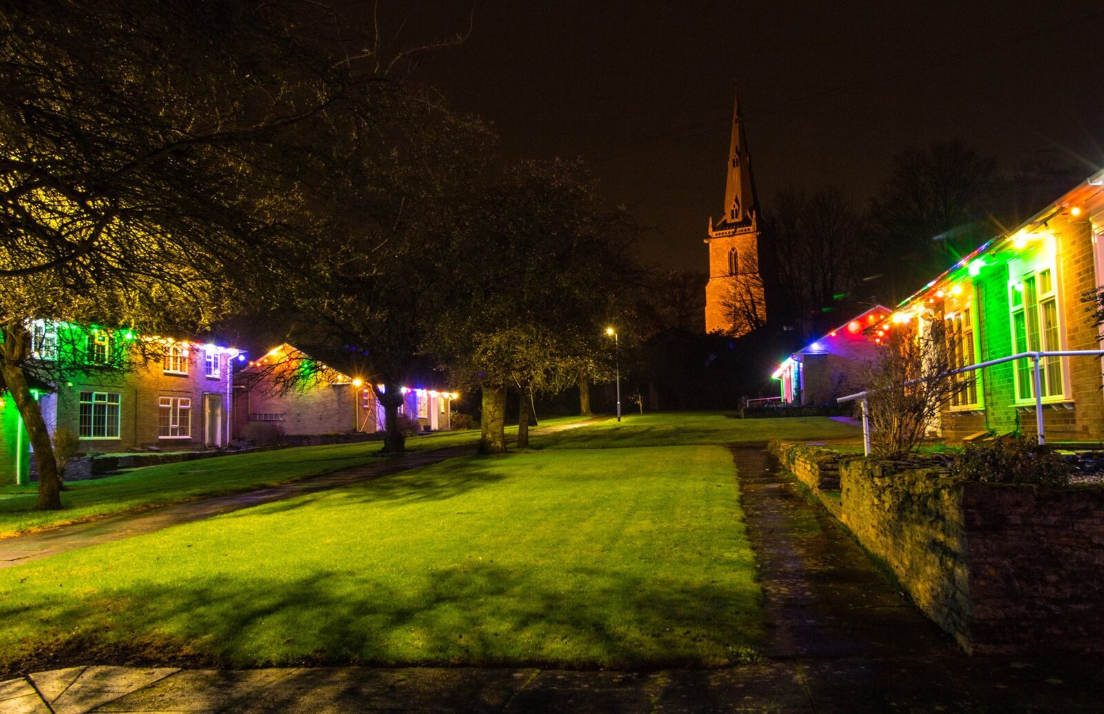

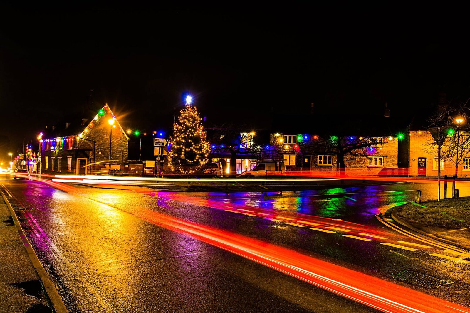

They do not always remain stuck to anything, just today we had to replace some that had come unstuck from new plastic fascia and bargeboard less than a week after fixing them. If you do use them then clean the surface with isopropyl alcohol and wipe dry with a clean dry cloth before fixing,
Small screws or cup hooks are the best option in wooden facias and bargeboards, we are still using some cup hook fixings that were fitted over twenty years ago,
Images from 2019
