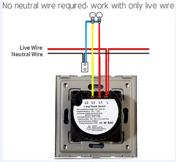

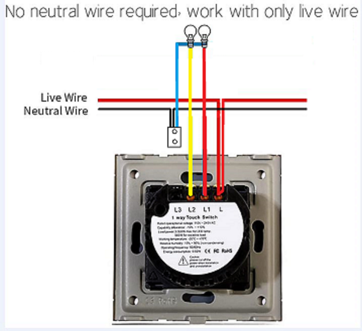

I was going to do something similar originally but without 'knowing' what doesn't show in the picture I didn't want to make any guesses, despite the fact I imagine this is spot on.
I'm sure that what you imagine (and what EFLI has depicted) is, indeed, 'spot on' - and that the manufacturer's version would, if taken literally, result in a big bang and no light
