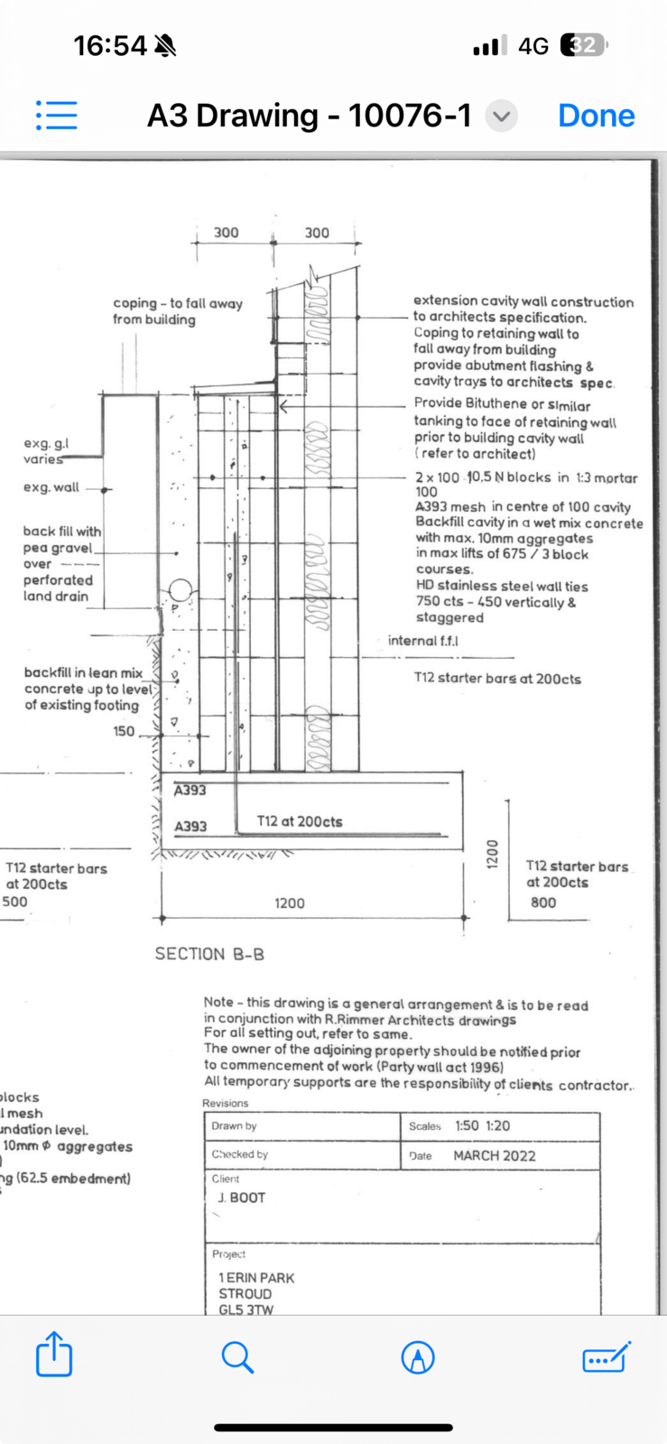

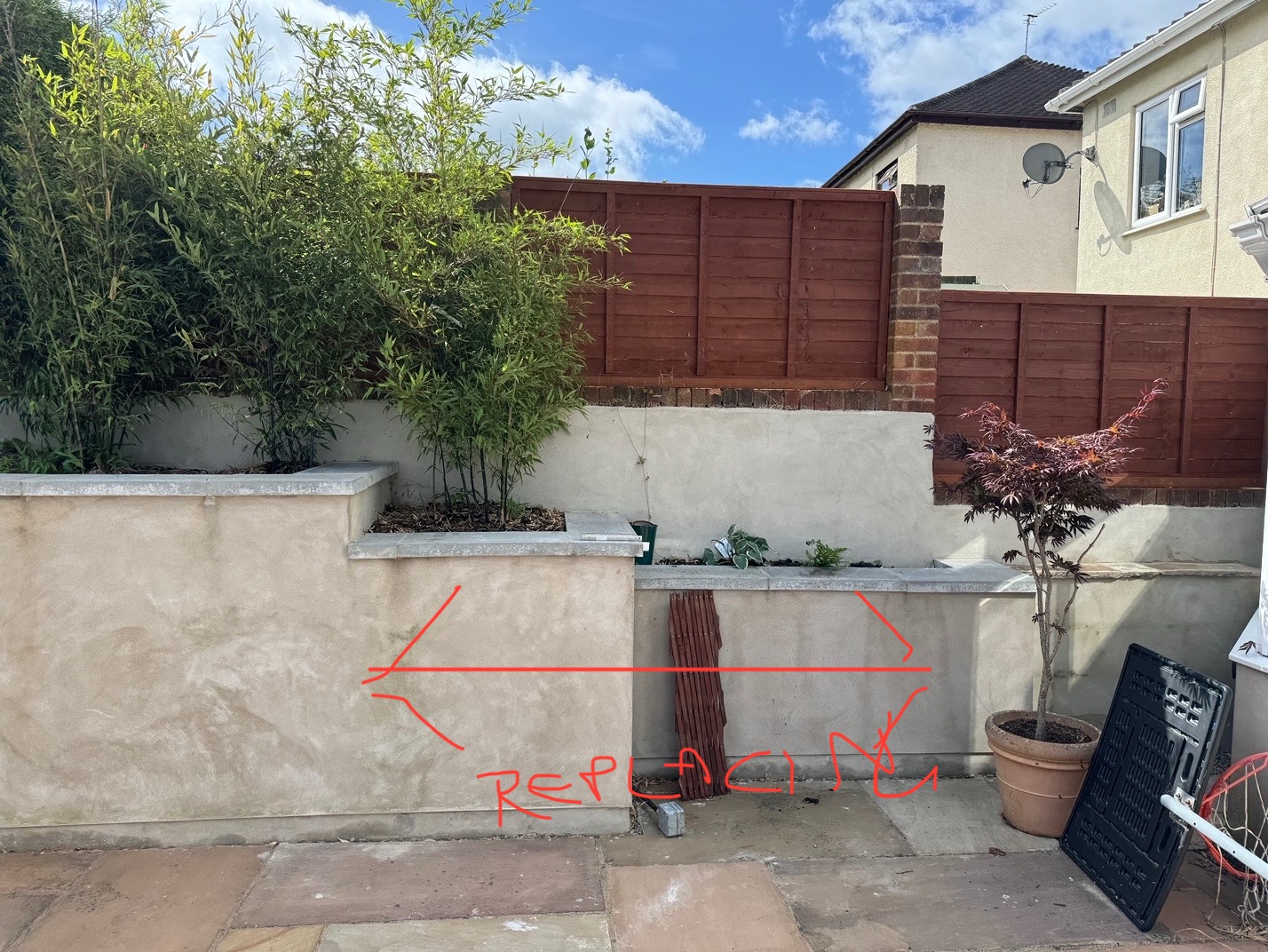

Hi there. I am planning to build a rear single storey extension under PD.
Part of the work will involve replacing an existing retaining wall with something slimmer and then tieing this new RW into the side of the extension
The RW will be wholly on our land butting up to our party fence boundary with next door, where the ground m is higher. This consists of a blockwork wall at the bottom and then a fence on top (line of junction). See photo.
I am hoping this can be done without a PWA as the neighbours have made our lives hell over other planned works. Can anyone confirm?
The foundations will be stepped and on that side only 300mm so I know that’s fine. As the RW will abutt the blockwork wall but not be on the line of junction (where the fence is) will this be ok?
We will not be cutting into or altering the party fence wall- just building a new RW up against it
Any advice would be appreciated

There is a block party fence with a fence on top (making line of junction). Separating our back garden. Then built up against this wall is a RW, which I want to replace, with something slimmer, taking it closer to the party fence. The outer side wall of the extension will then be partly tied into this RW. The footings are for the RW and extension, entirely on my side and stepped so only 300mm at that side.

And this

The left (higher and bulkier) part of the RW is not going to be touched- this is the part holding back most earth. From there it slopes down to around 2m from the back of the property where it is at ground level. We already changed the entire length of the RW (without PWA) a year or so ago and there were no issues.
Like I say the structural engineer has something in place to support it if needed as it’s being constructed, the question is as more about whether a PWA is needed or not?
The bit with the red arrow is being replaced and taken back closer to the wall and then tied in to side wall of extension

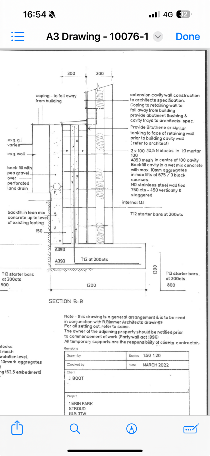

From the section drawing the PWA would not apply. And you can't serve a PW notice if the PWA does not apply in the first place., but be aware of the significant potential costs if you do and the various parties go through the motions anyway.
Your retaining wall design seems over designed and unnecessarily high - looks like it's retaining the retaining wall, not just the ground.
Strictly, you should not be touching the neighbours retaining wall with your backfilling if the wall belongs to the neighbour. I also wonder if this new retaining wall would in fact be deemed an engineering operation, and therefore not PD.
Be sure that your engineer and your architect are actually working together on the design and not separately
