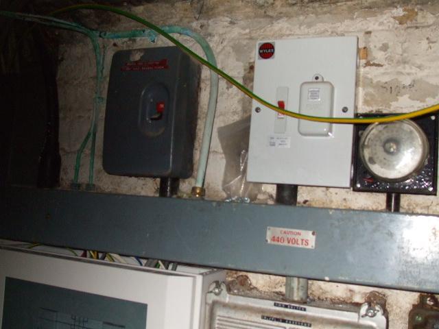

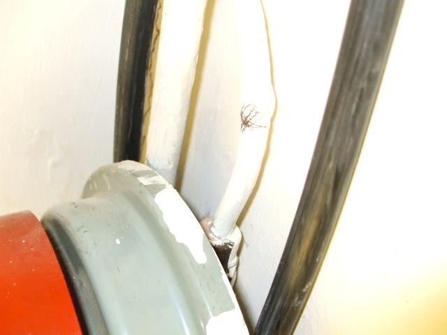

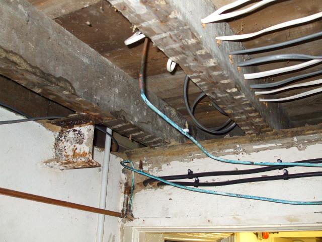

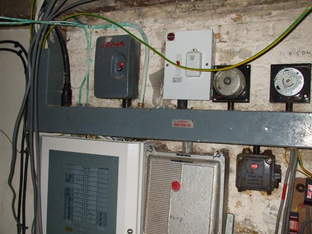

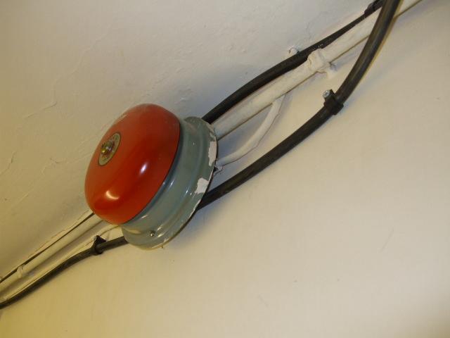

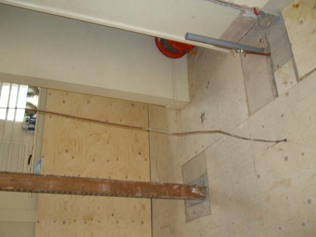

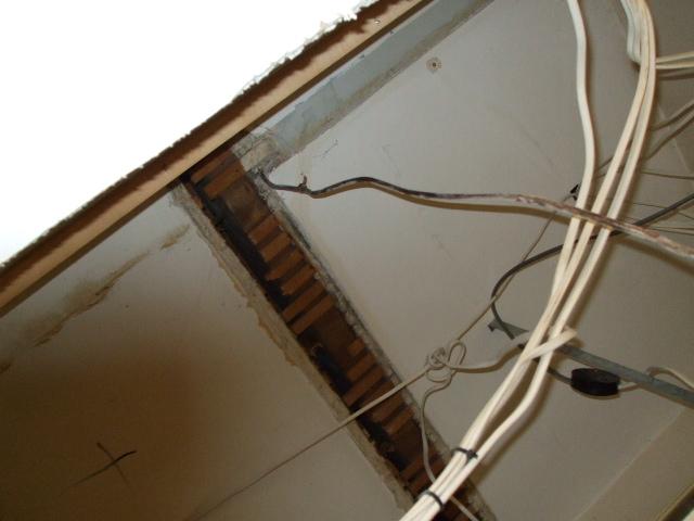

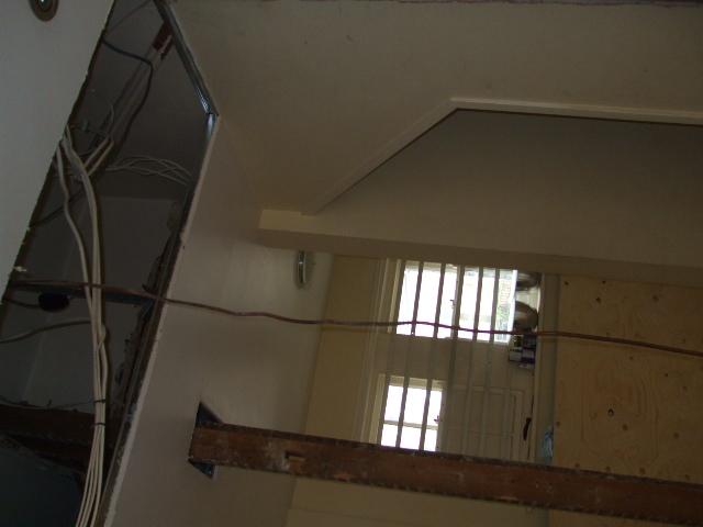

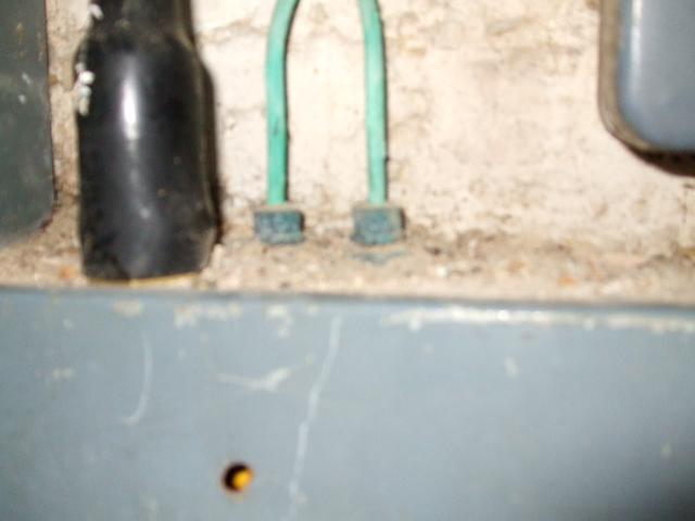

Sorry for the delay didnt get to the shop until lattelast night have posted several pictures of the pyro the entry points etc hope this helps
Great pictures.
The bells certainly look like the 240V variety. What does the red label on the grey switchfuse say?
The photos show a lot of sheath corrosion (the green deposits). This may be due to a reaction with the plaster (possibly lime).
This will ultimately be terminal as pin holes will form and these will allow the magnesium oxide powder insulation (which is hydroscopic) to draw in moisture.
You should consider replacing this cable.
