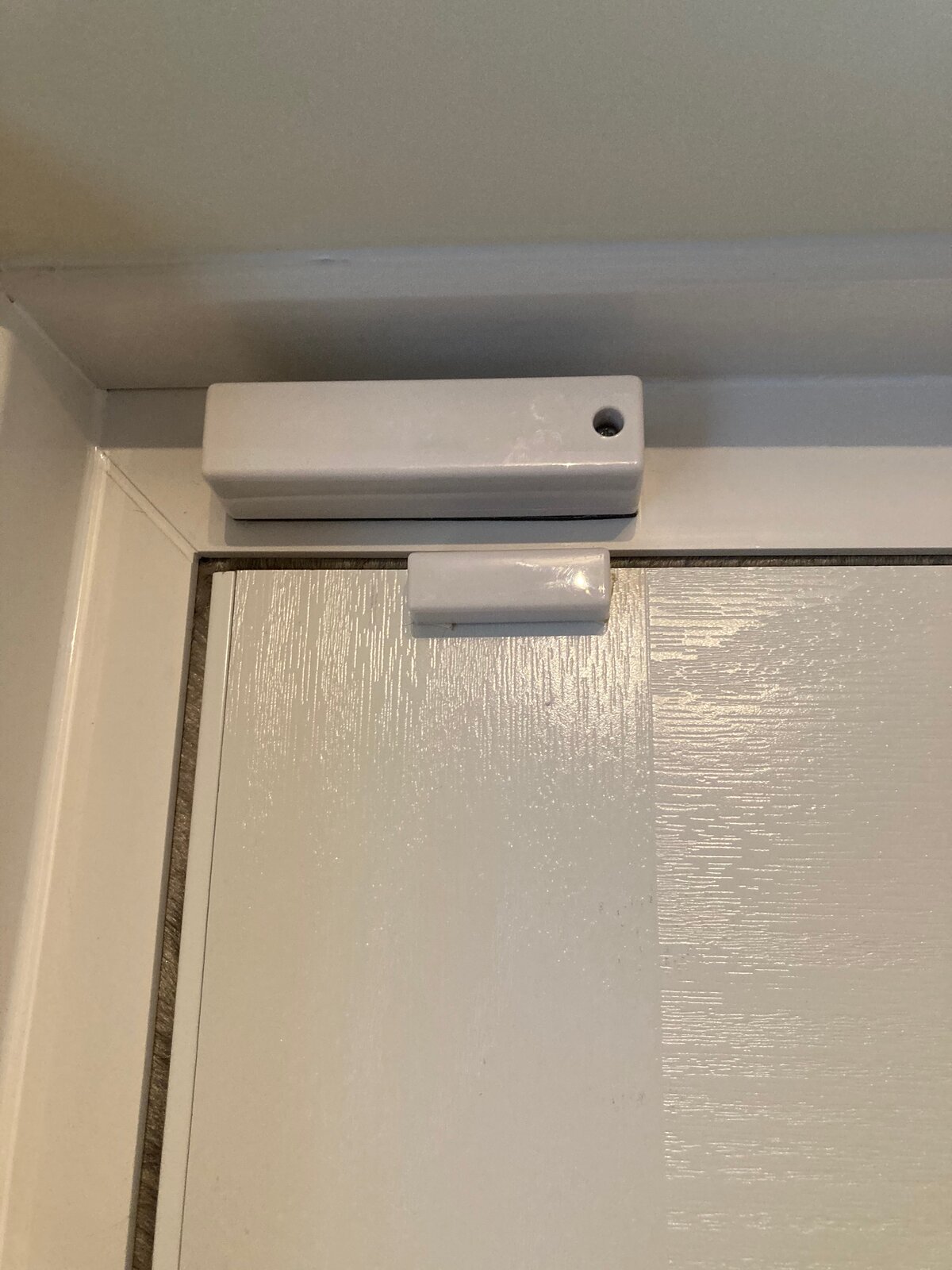

hi guys , still no further forward, log shows door contact fault unable to set system.
picture of door contact causing all the trouble.
tried code then No no twice still unable to clear
Take the cover off the magnet on the door ....has the magnet fell out of the plastic housing ?
Magnet not aligned with little make on contact.
Take magnet off door , as it is stuck on with double sided tape and hold next to contact.
