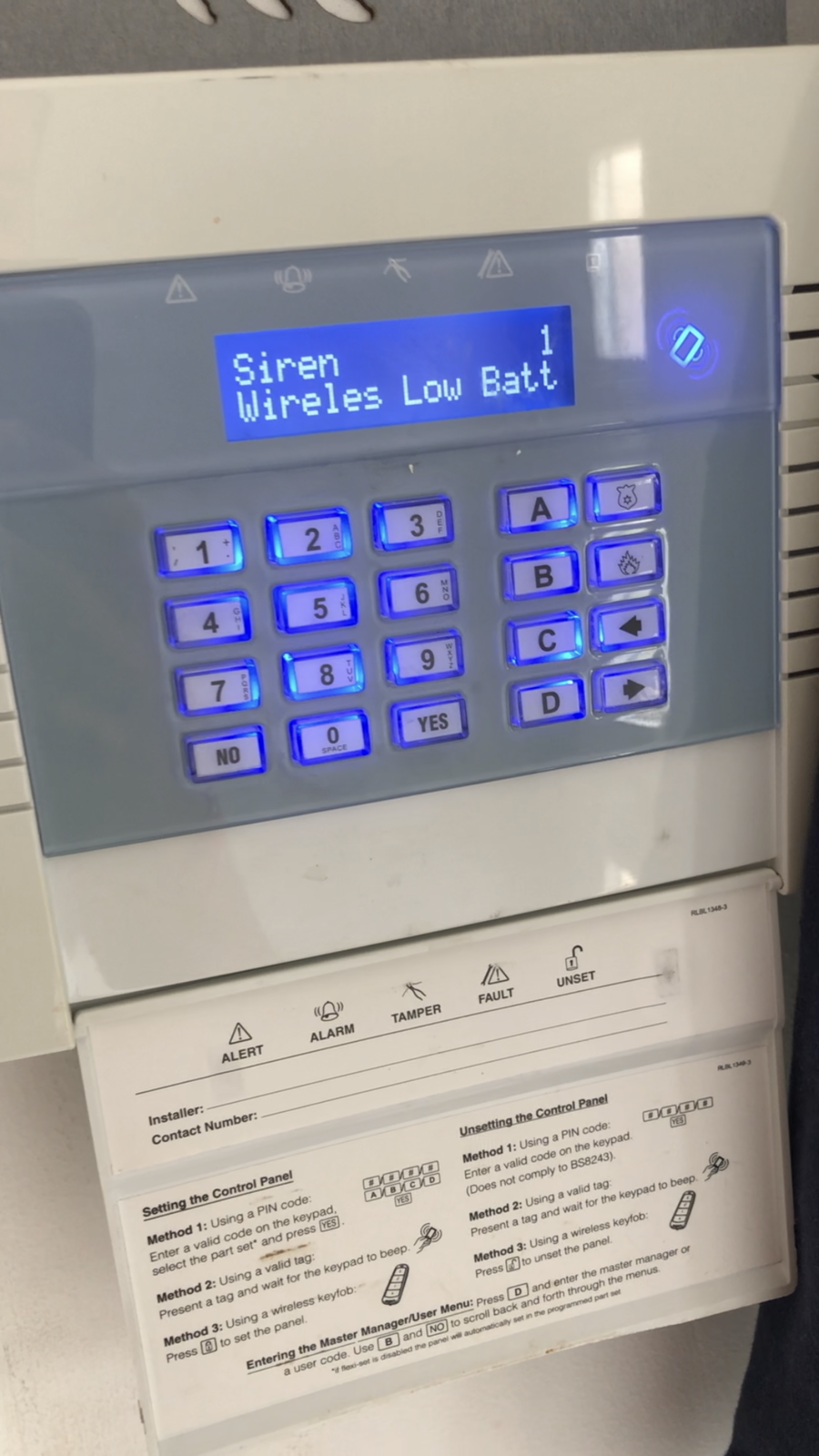

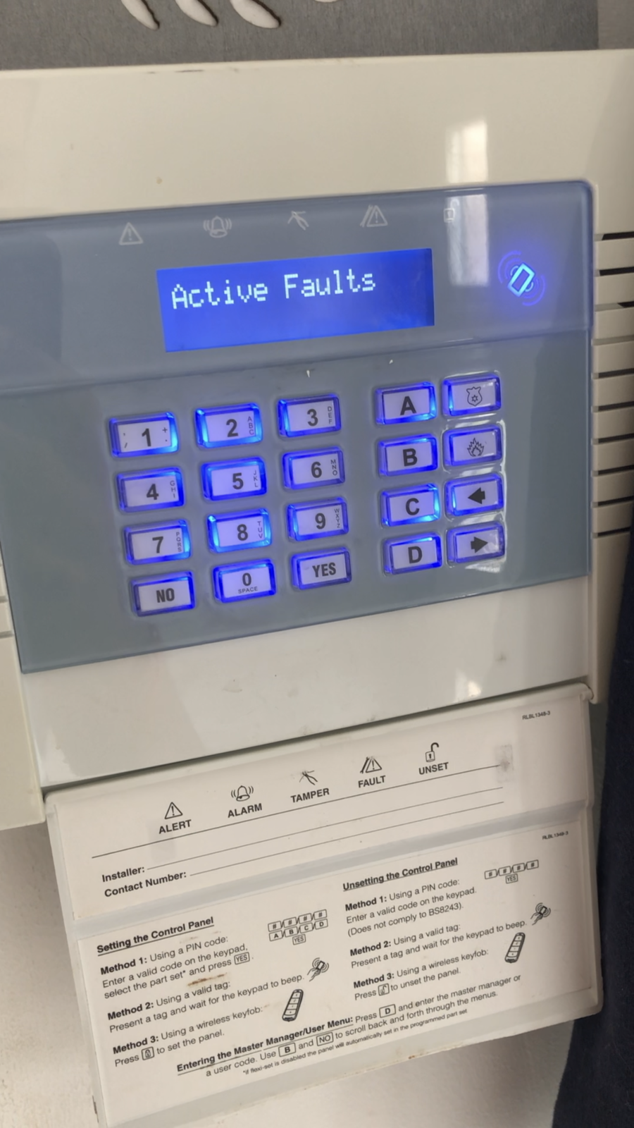

Hi All
I have an issue with my alarm - see pics
seems like the battery on the sensor has gone / is low
Is this an easy job to do?
I didn’t have the alarm installed myself But have for In Touch with previous owner who’s advised alarm company number. They said £120 to change the battery and “re program the panel”
but if it’s easy to do id rather do myself if not such a big job. Not keen on getting on a ladder but at times like this every penny counts
apologies don’t know model of alarm
Can go into settings and possible check if anyone knows how to? It’s around 8 years old. Pyronix

Go up ladder open bellbox see what battery it is ....round or two flat ones , order new batteries , replace ...
So there is no need to “re program the panel”
After changing battery?
Is the alarm company talking nonsense?
also - before changing - do I need to enter engineer mode? As it’s tamper proof ....

If the alarm is working fine, no need to program anything new do it yourself.
The bell will sound either way in engineers mode or not if you enter engineers mode first you won’t have to reset the tamper fault that it creates once you’re done
Ok so I’ll put in engineers code first as I’m not so familiar with the tamper stuff

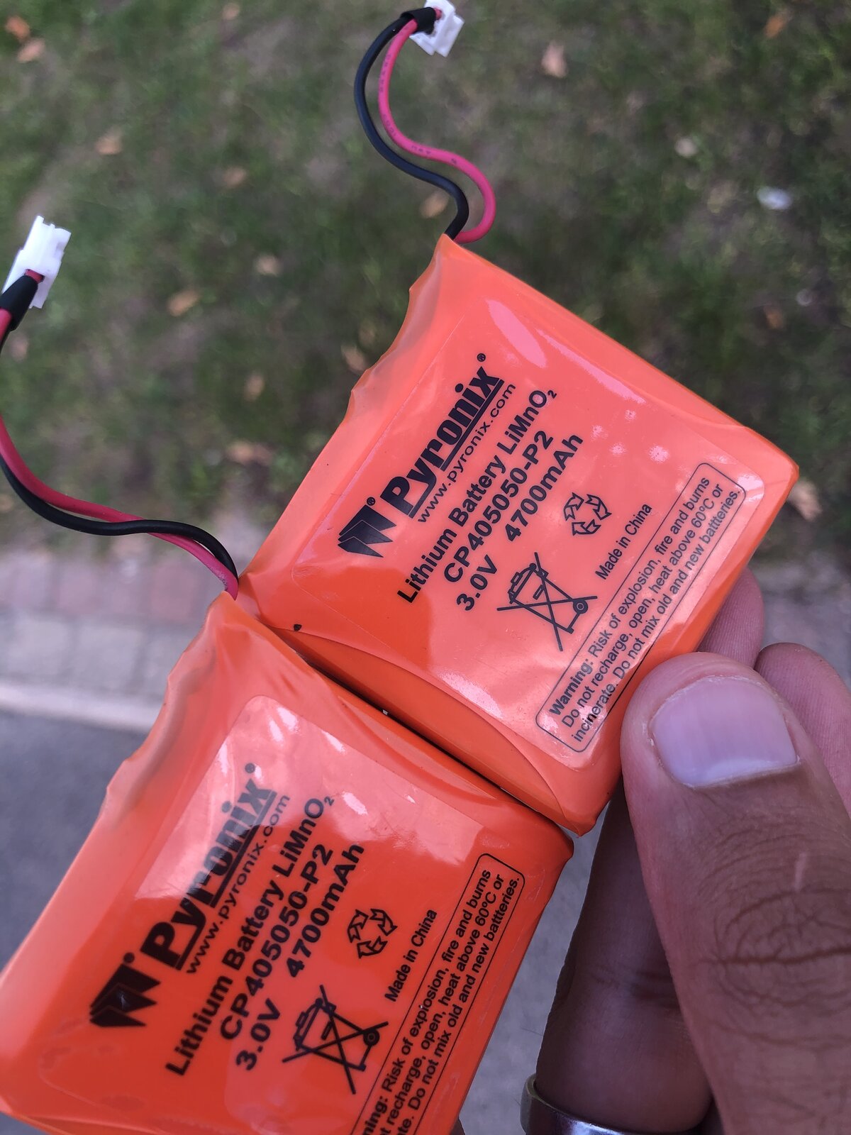

It is a toss up between the two versions of batteries older models usually have the cylinder one and newer ones come with the two squares standard.
take a small flat head screwdriver up and a large Phillips (any crosshead would do) use small flat head to prize the flap open central bottom of the bell box it’s hinged downwards so screwdriver in the top. Reveals the screw. Undo that enough to lift the lid up, the bell will siren and just depress the micro switch at your earliest opportunity to shut it up
depends on its age as to which batteries.

Service on this system ....change all the batteries, do a battery load test from engineer menu for main battery , check battery and signal levels from engineer mode , walk test all devices from engineering ( it will remove each one as tested) ....set and test each device ....DIY ...
it would be good to know roughly please..

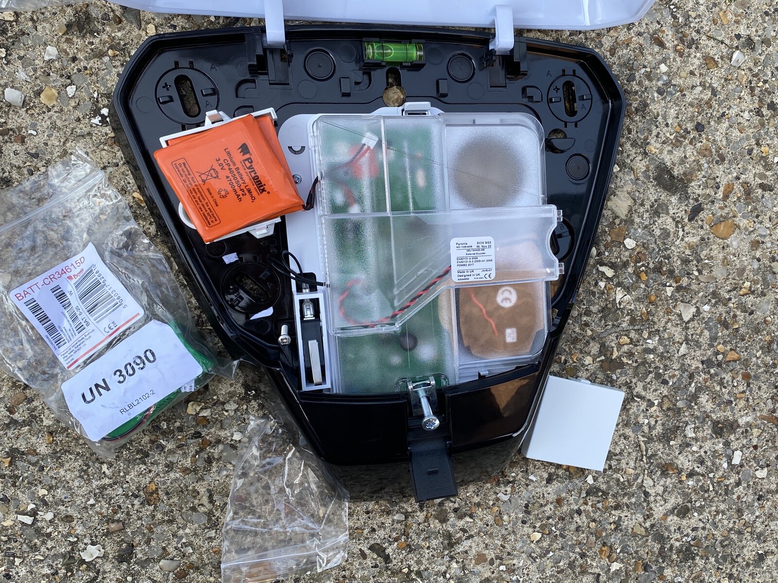

This is what you’ll be presented with, tamper micro switch is the flat blades switch bottom left once you take the lid off press that back down and it’ll stop the siren.
Batteries: cylinder p/n CR34615D
Flat square p/n CP405050-p2
Give them a google roughly about £20

I got a ladder we opened the flap
and pic battery is attached - same as yours :)
I went into engineer mode before taking it out (not sure if I needed to?)
did hold the tamper switch when opened flap
put battery back after taking pic- In case it loses memory?
once it’s ordered and delivered - will get back up there :)
