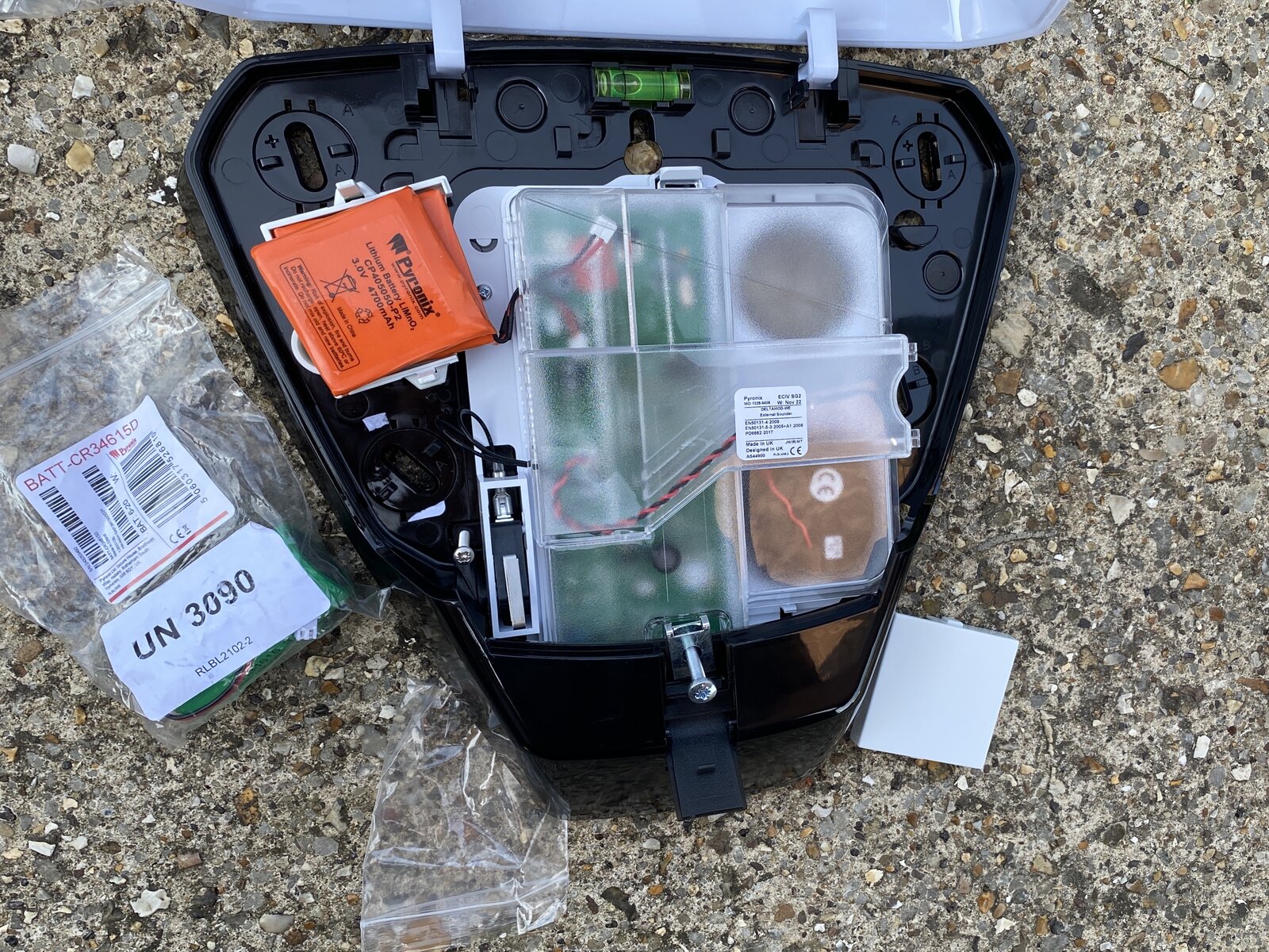

My bell looks like this. Is this a MK2?If so should I try to get the system to relearn or buy a new. One?
Mk2, try re-learning onto system first. If it still doesn’t sound then new bell module
The bell is in tamper so the lid isn’t sitting flush or it’s not tight enough to the wall.
Pretty sure the lid is flush so must be the latter . Thanks for the information.
If the back seems flush too, this screw may need tightening to bring the tamper switch off the wall towards the lid

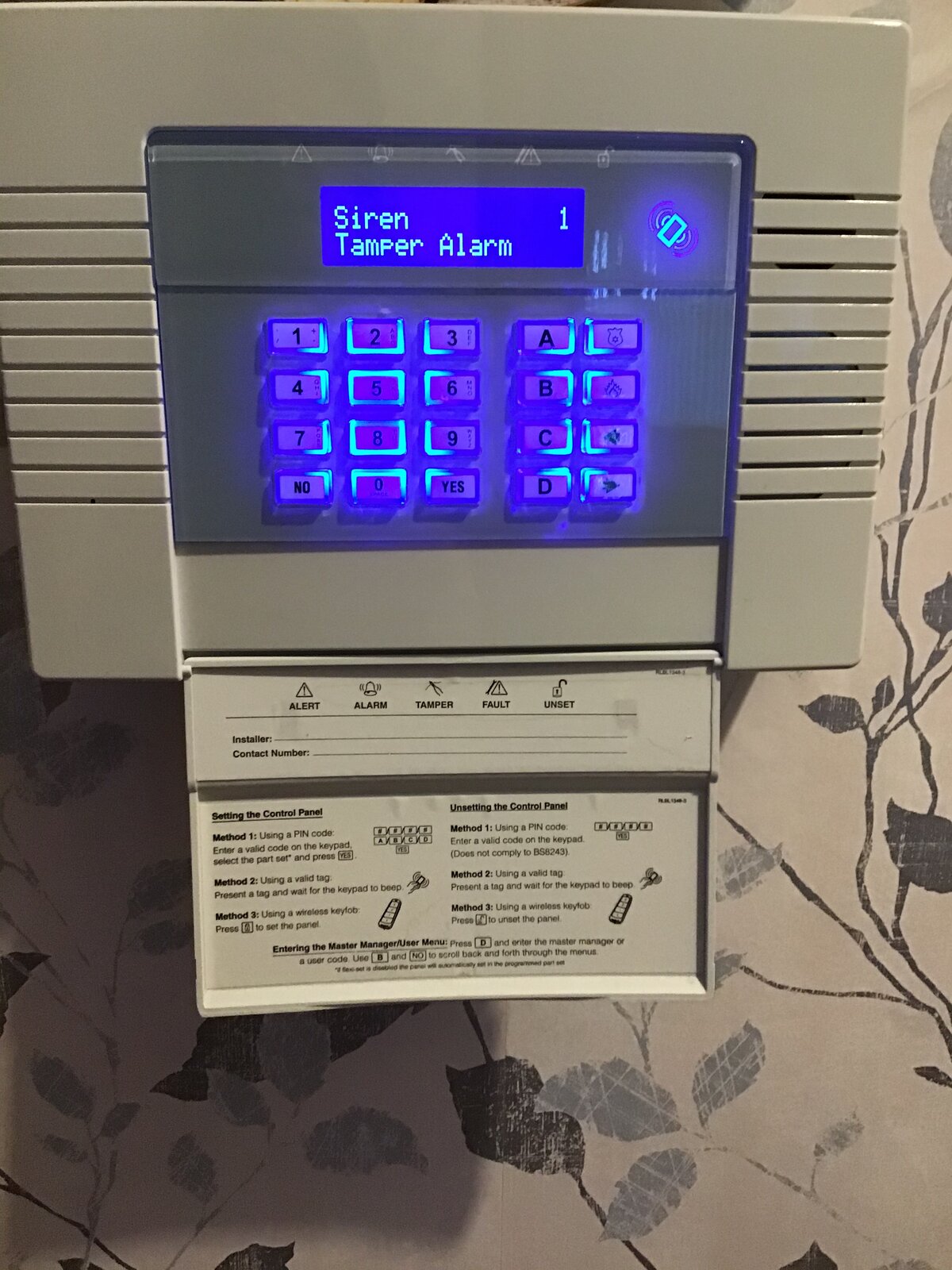

Hi I have a new issue with my pyronix enforcer system.
I have a decorater coming tomorrow to hang wallpaper. I went into engineer mode, unscrewed the cover on a pir, removed pir and bracket from the wall. I didn’t alter anything in engineer mode but when I took option to exit engineer mode the alarm went off with message test failed living room. I could not silence using my fob and the panel didn’t accept engineer code. At the moment it is silent but every 10 minutes the panel beeps for a second. I will need to put pir back on Thursday (have taken out battery also). My question is how do I manage to get access to panel again and what will I need to do after pir is put back to original position.
Also meant to say the cover is still off the pir. I have now put battery back in and closed pir. The message on the panel has changed to test failed but doesn’t say location (living room). The pir is sitting in my kitchen now.
Test failed due to the pir being missing/tamper should just press yes to go back into engineers mode and either remove the device from wireless devices+inputs or put the lid back on it for time being
