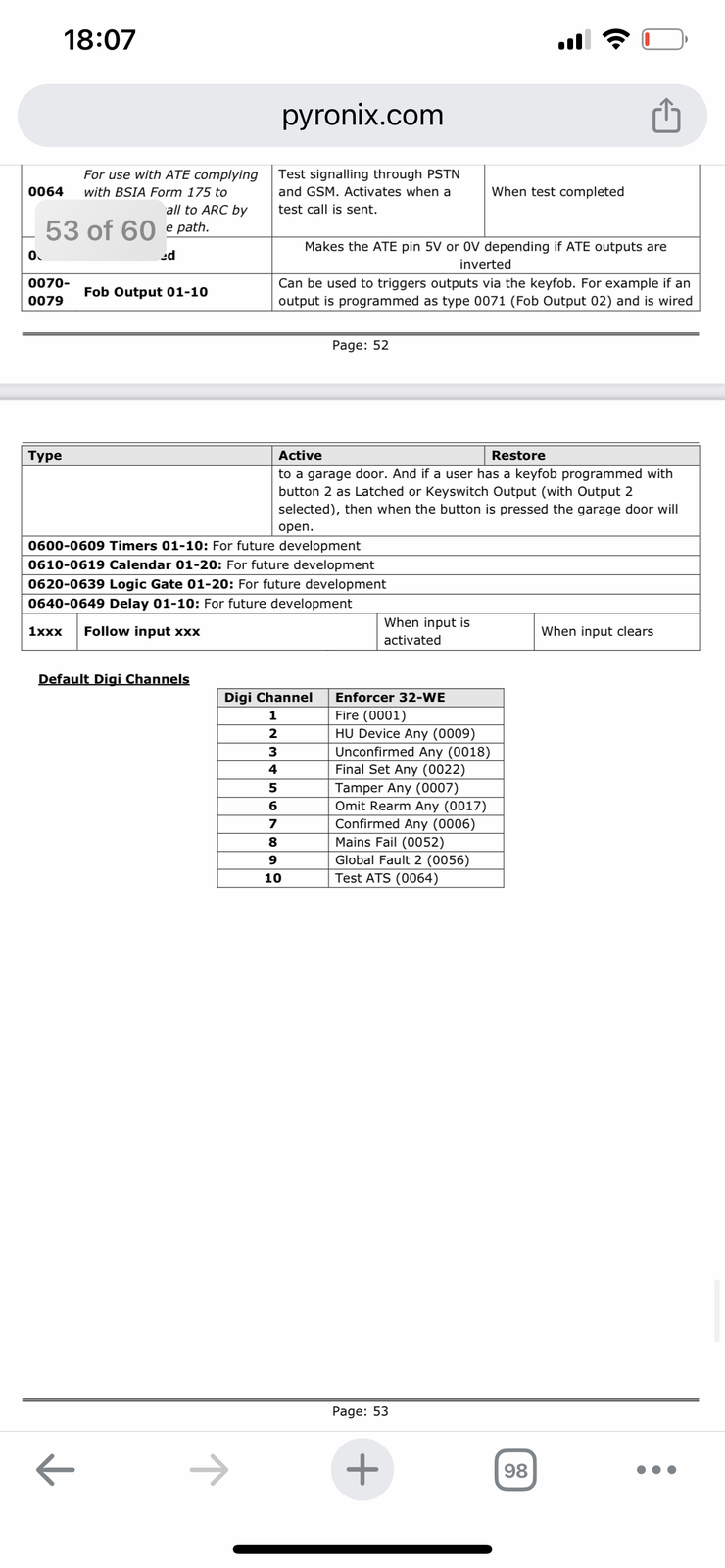

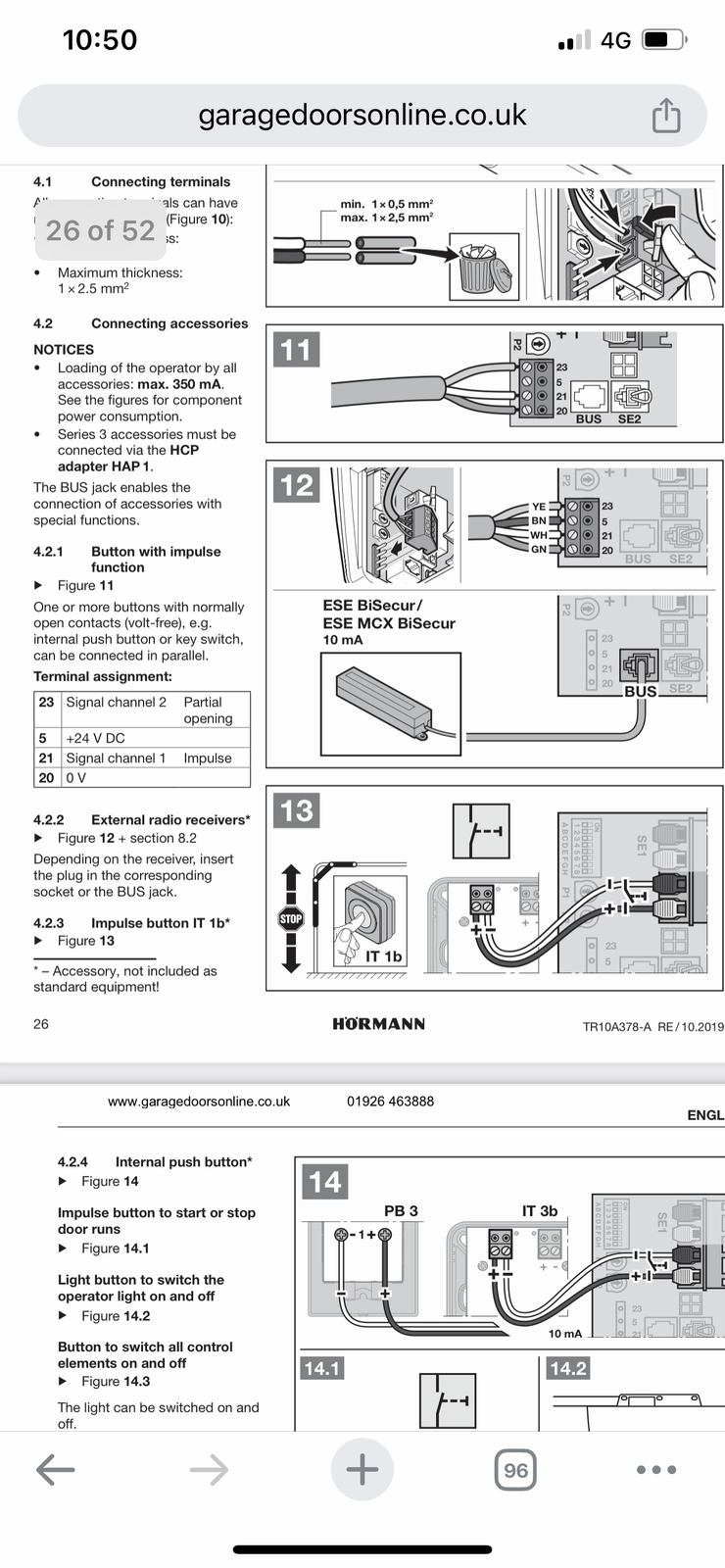

please could you advise any further on the wiring? I’ve attached my garage door manual. I assumed it would be figure 11, terminal 21 signal Chanel 1 impulse to Enforce PG1?
Output wired to relay which in turn shorts the two wires in FIG 14
Will have to check what programming options need to be set when I get home ( away at moment )
No to relay …will try a small Paxton relay on the enforcer if I get chance this weekend as most of the ones I’ve fitted with a garage door function have been the euro 46 which has a relay onboard allready …
Yes to push button

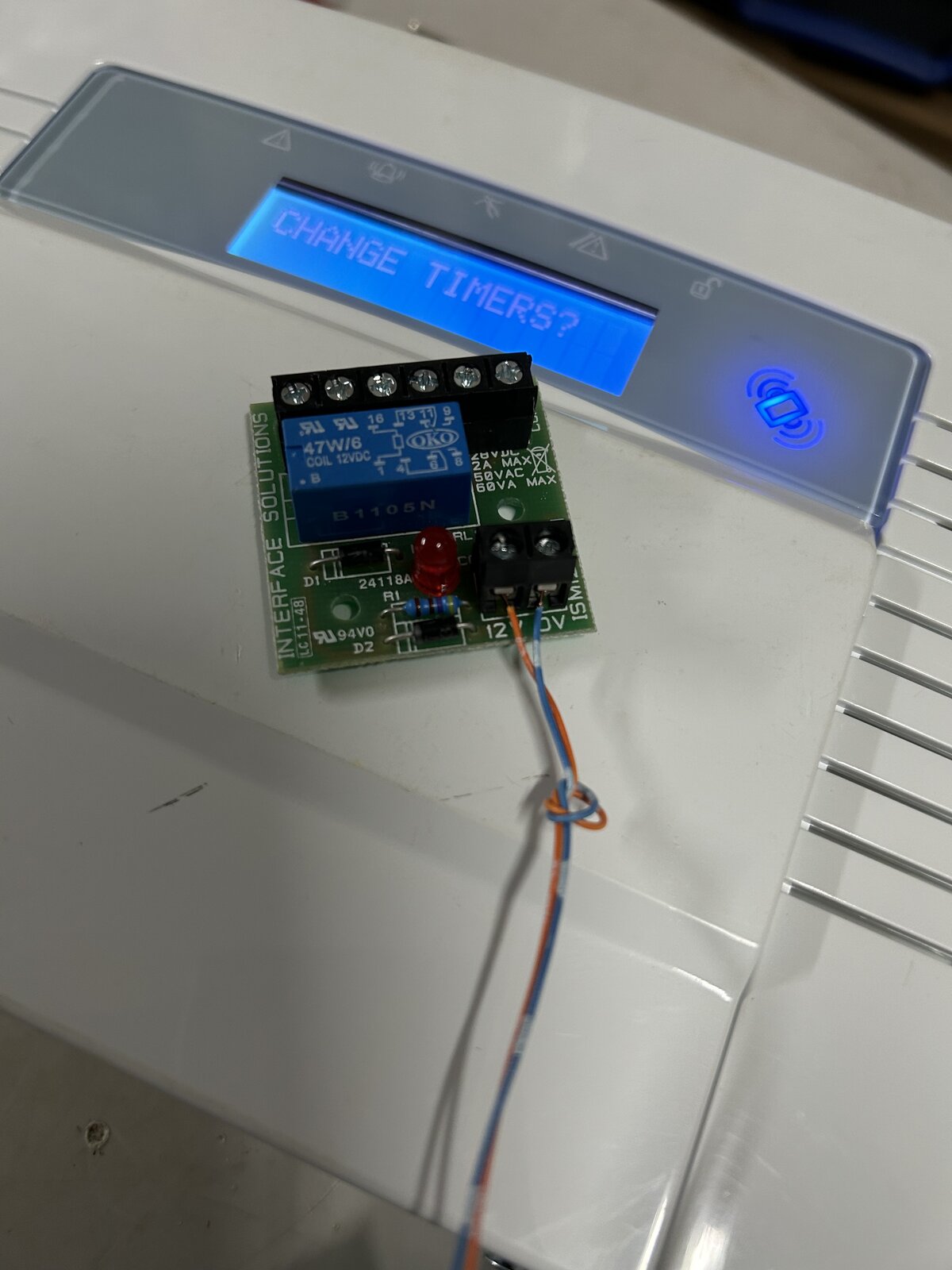

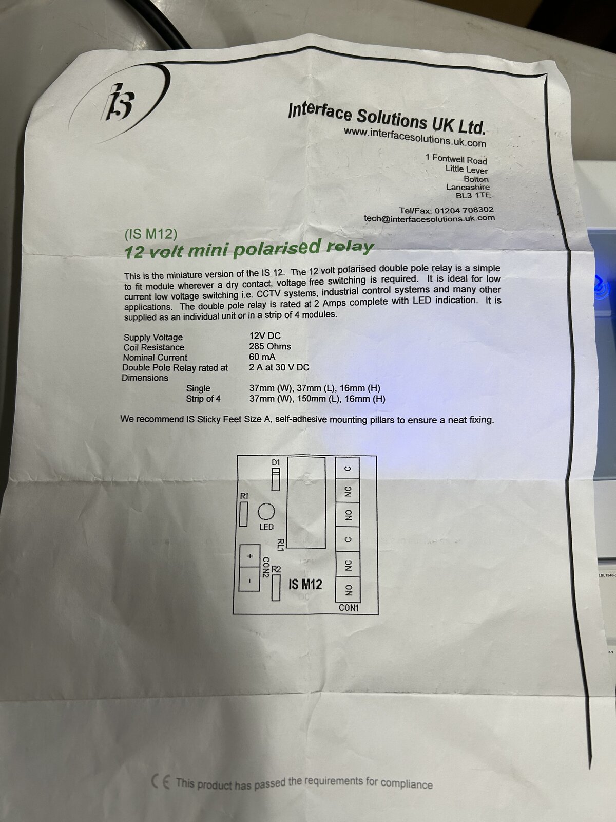

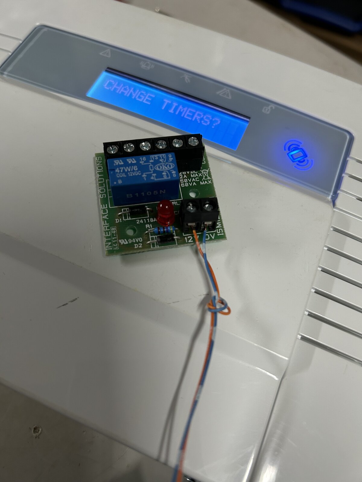

Maybe a 1 Channel relay like the one below? With the garage motor connected to COM and NO?
Yes maybe, can’t seem to find any recommendations in their install manuals.
Do you think that Amazon one’s worth a go or would you suggest the plaxton?

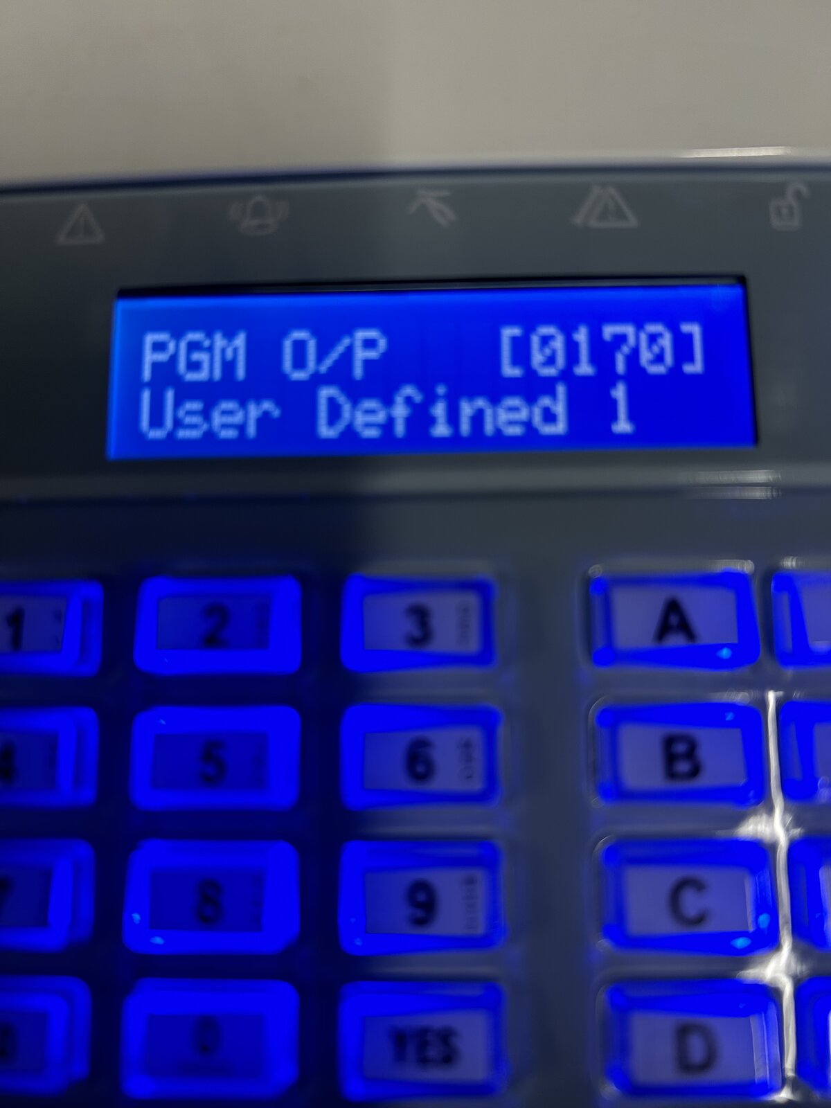

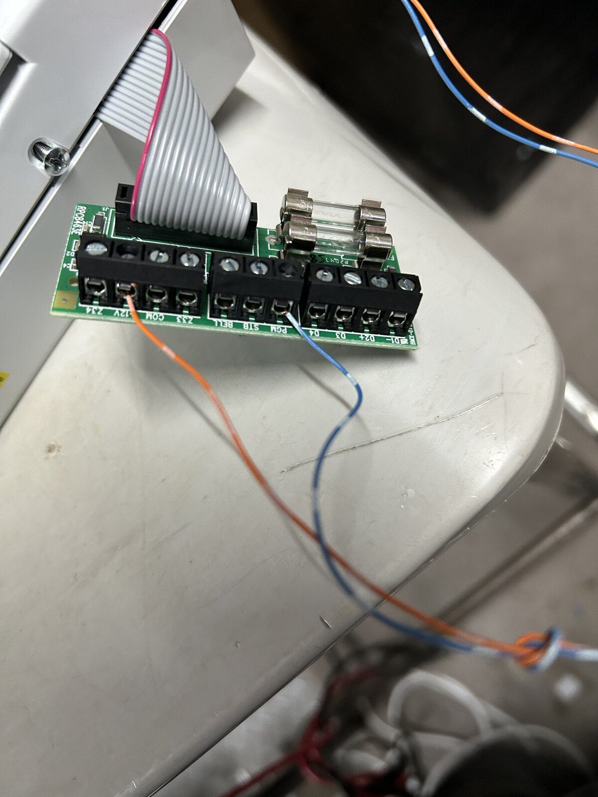

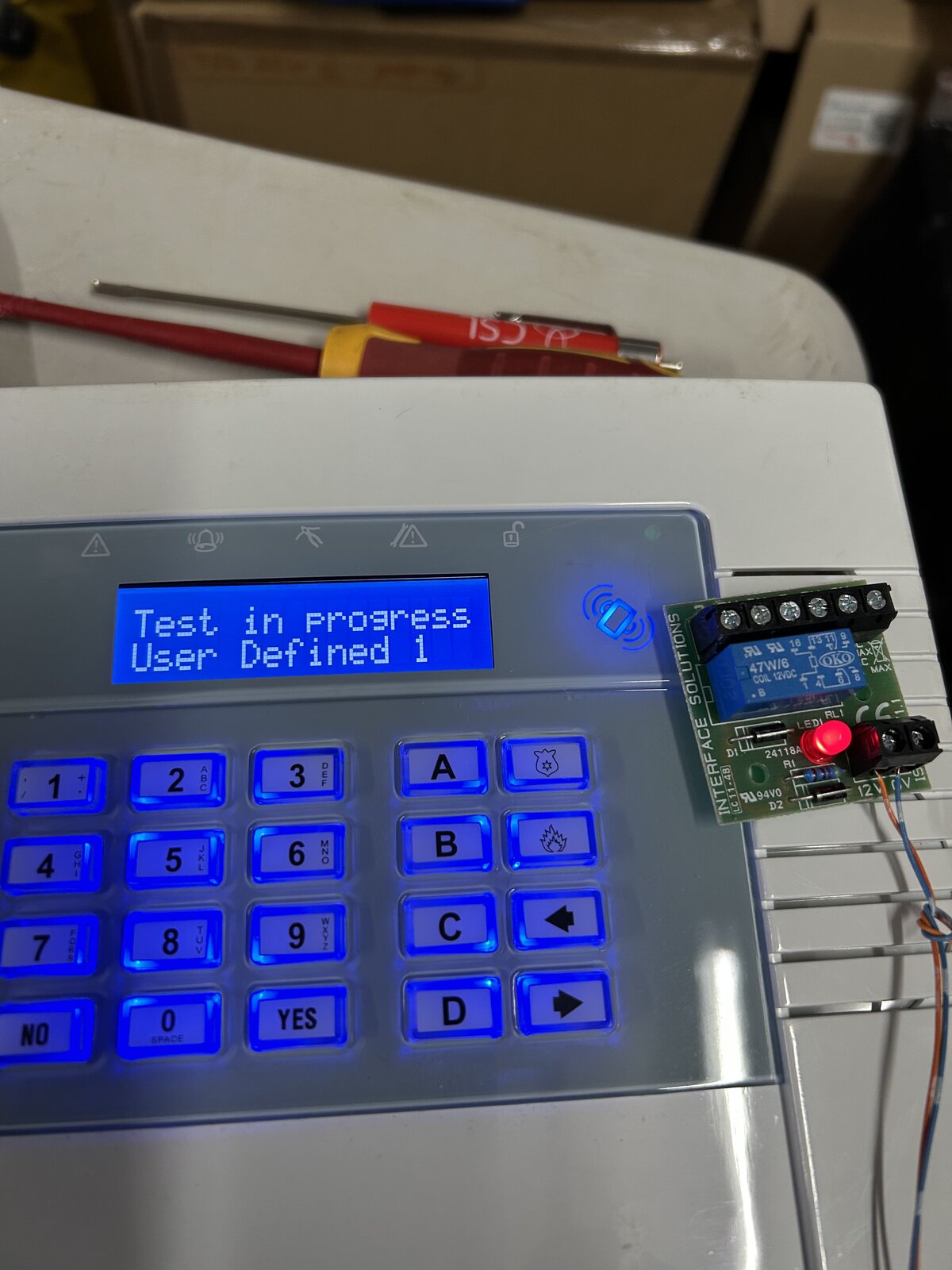

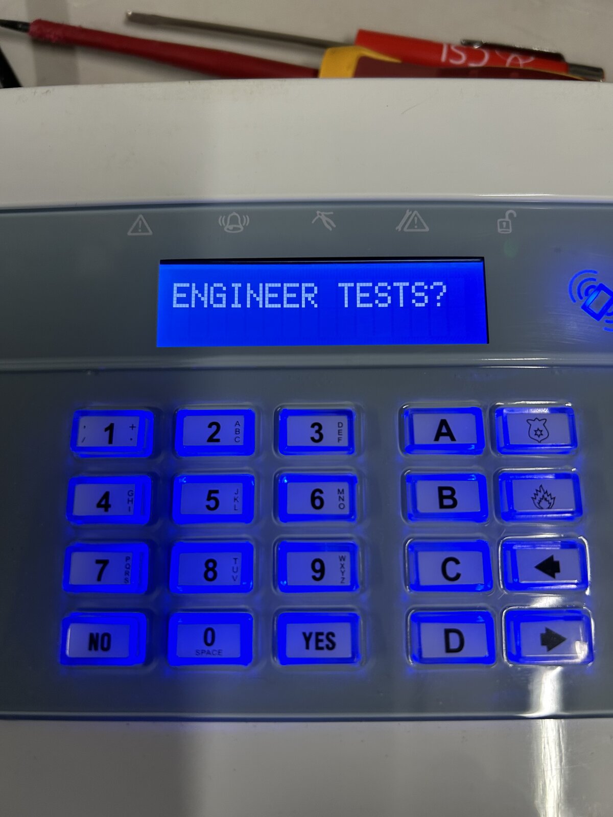

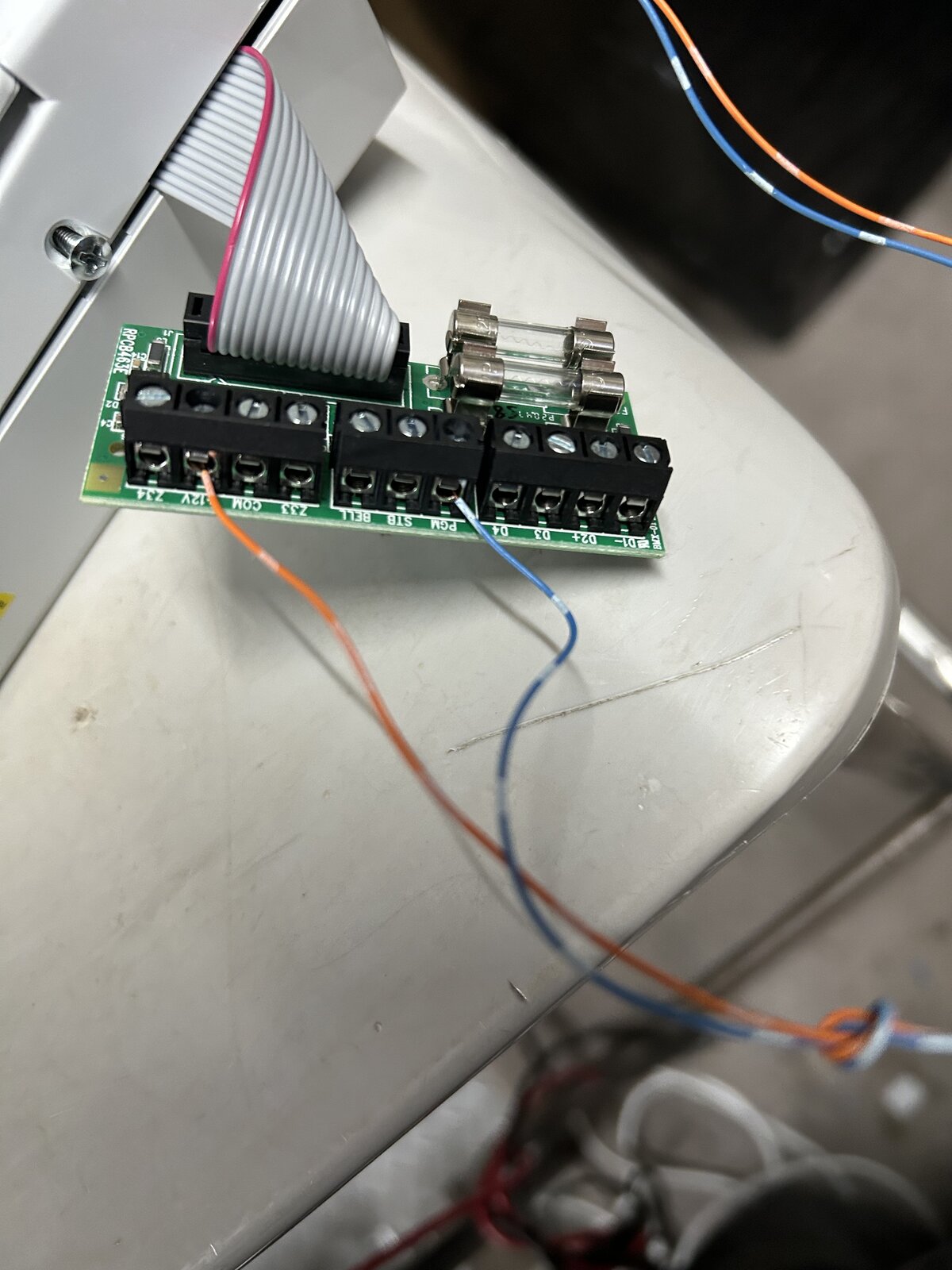

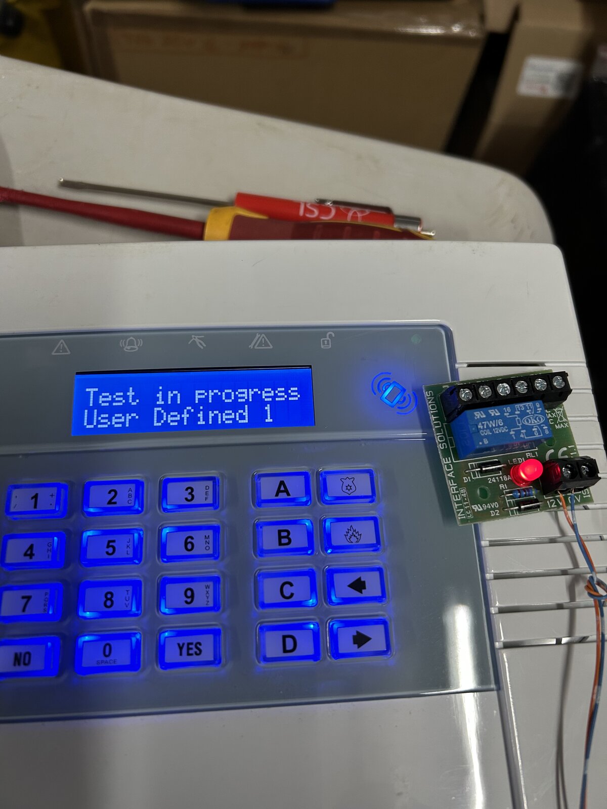

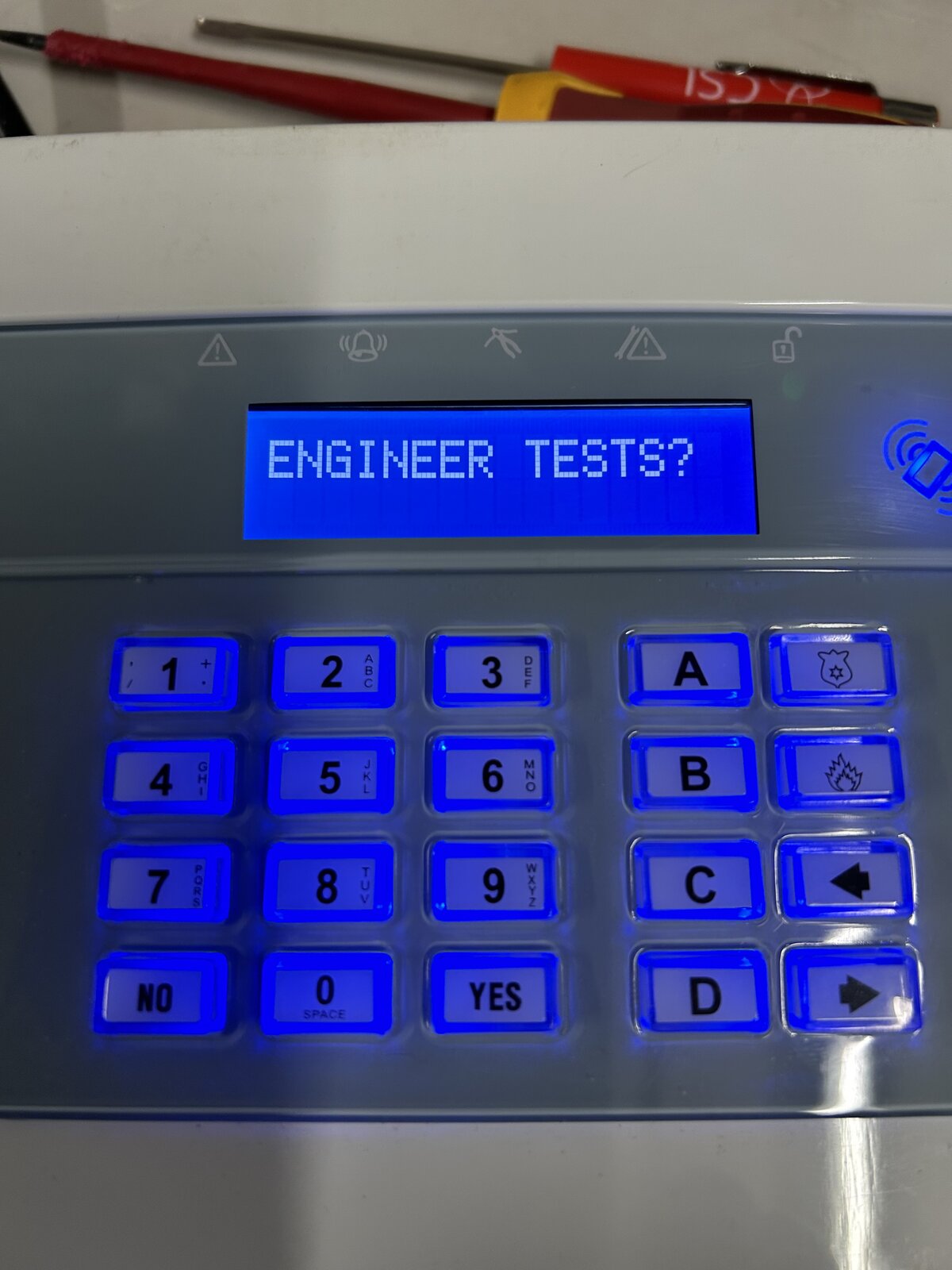

Ok tried it with a relay connected to PGM and 12+

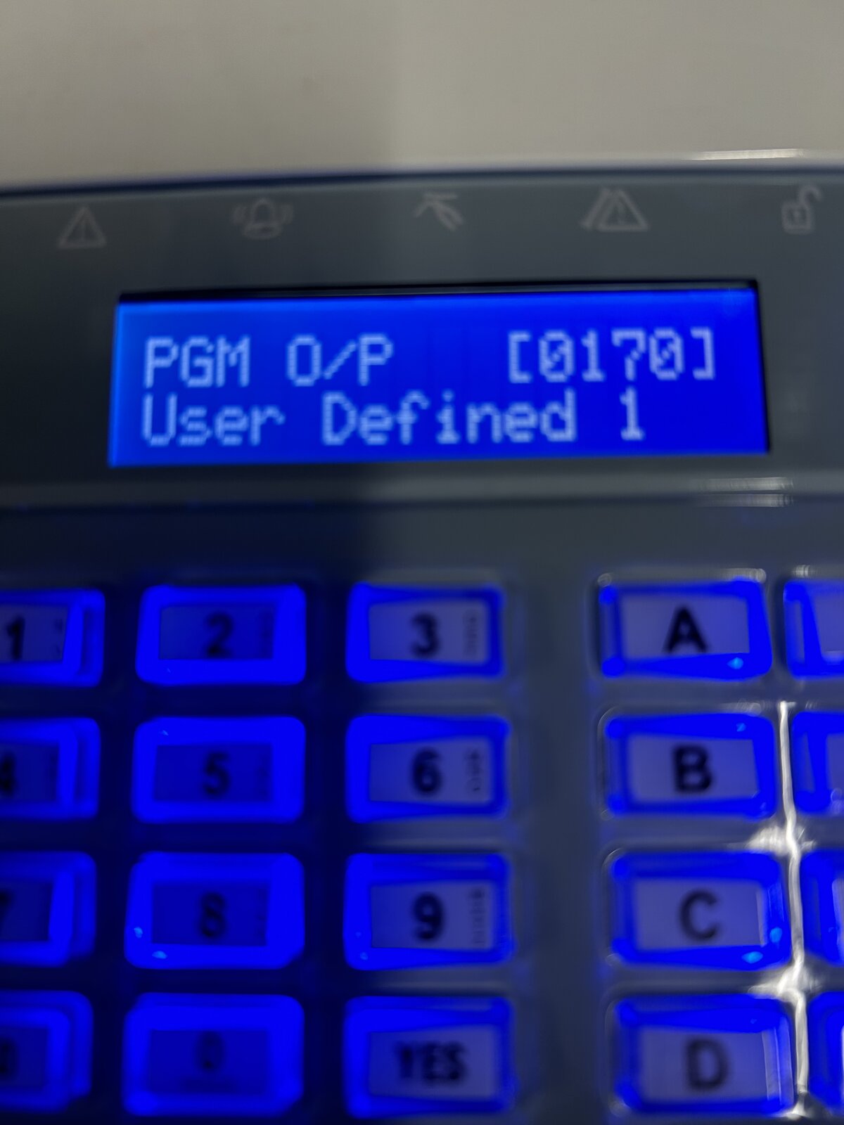

Change outputs / end station outputs / PGM Output needs to be 170 user defined
Program user output as timed ….set it to 2secs and then name it garage door ….
Go to engineer tests / test outputs , test 170 ,

One last question - where’s the best place to buy the IS M12? There’s a CEF (listed on IS website as a distributor) local to me but they don’t have this item listed.
Hi everyone, just to share an update. All wired in as to @sparkymarka photos and programmed and it works perfectly.
I can now control the garage door with the “ii” button on my pyronix keyfob, on the home control app and with a doorbell on the inside of the garage.
Many thanks @sparkymarka , much appreciated!
