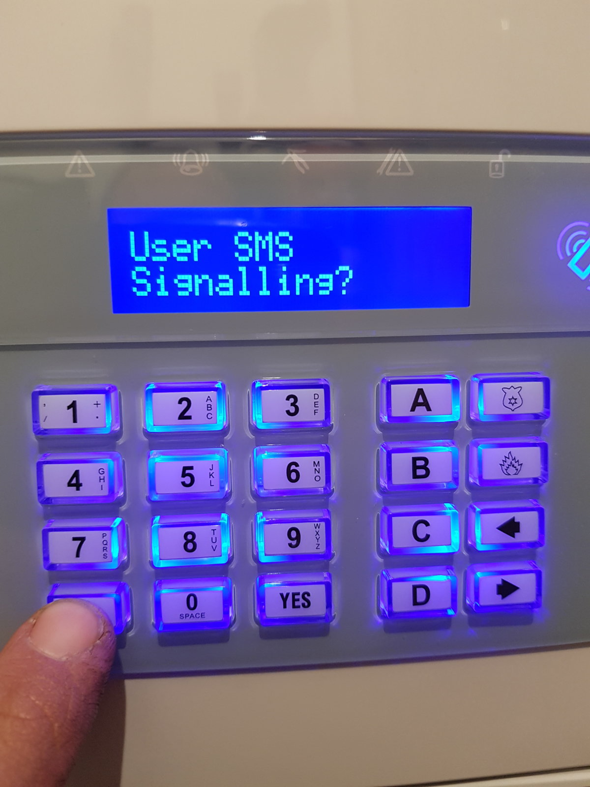

Pyronix enforcer is it wifi
On the back of the panel there should be a date printed on a paper sticker ...what is it ? Did you buy this panel new ?
Reason I am asking as I’ve not seen any of the chokes at the side of the psu for a while ...
I will find out a date
But my son done what you said power down and disconnect battery and hey presto wired it all back up and the Wi-Fi options are there and it's all set up on our phones now so big thanks sparkymarka but I will find a date
I bought it brand new from a cctv shop like 2 days ago
Can you not se the pic of the modual I have put on
I can see the picture just because its powered up and got lights on doesn't mean the panel can see it. On a few occasions for me its not worked the first time and taken a couple of goes.
The panel can only find modules on power up when it has found it you will then get additional related menus on the system.
