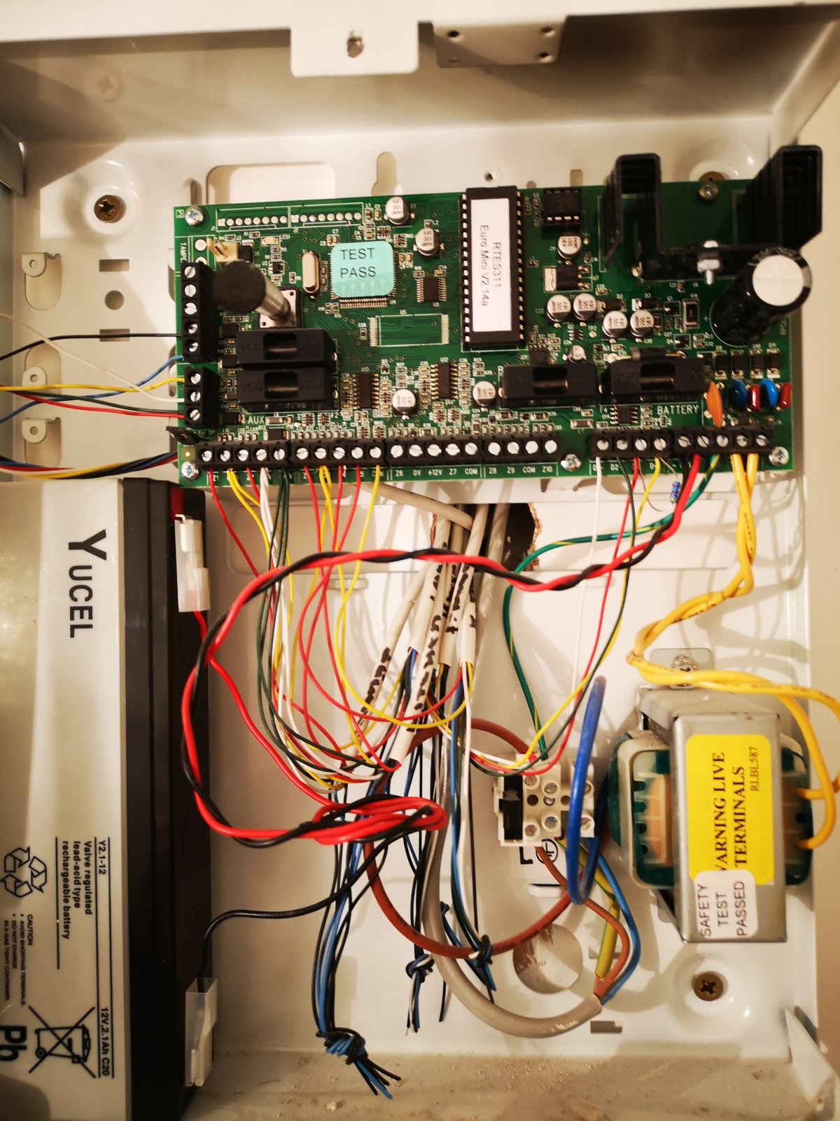

If you require help then photos of the wiring helps us determine what the problems could be.
You are being asked to post a photo of the main control panel wiring not the remote keypad .
This is the white box with you say you have checked the fuses ?
By the sound if it you has checked the fuse in the spur and not the fuses on the alarm control panel pcb. .
Sorry, here we go
Cheers sparkymarka!!

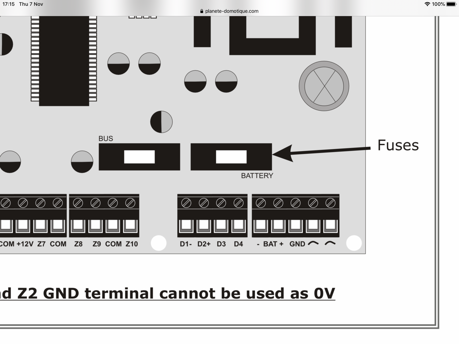

Next question though, how do I test if the bus fuse has gone or not?
Cool, I'll give that a go and let you know the outcome. Appreciate all the help on this BTW

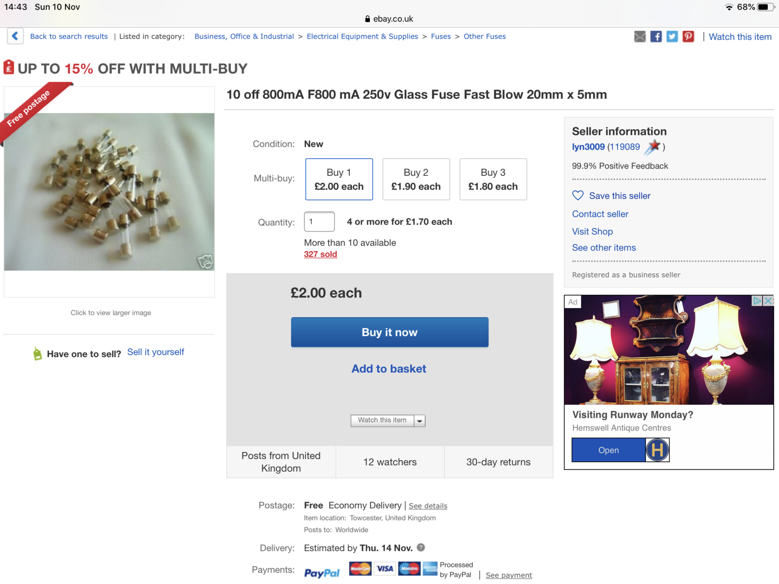

Bus fuse has gone. If I got a replacement, what voltage would I get as there is nothing on there. Also, I take it I can pick these up at screw fix?
No I see it now 250v
Think you might struggle ....looked on Halfords but smallest size is 1.5 amp ....what area are you in ?

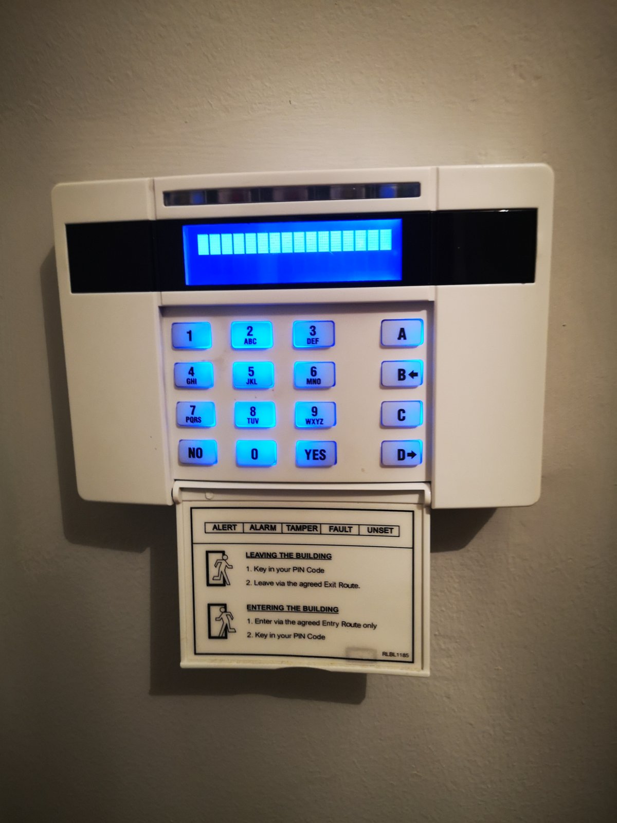

Now I have power to the keypad. But back to where I was before the power went
Here we go
Sounds like one of the data lines is off / faulty would have to try it on a euro mini to see what happens , ok
