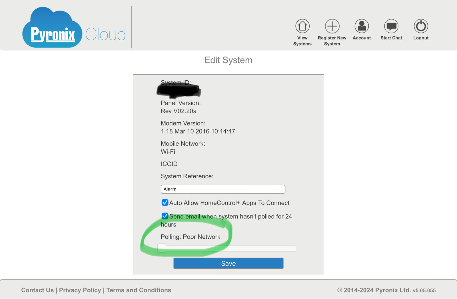

Did notice this poor network statement…

Sorry to frustrate you chaps, but still have the ongoing issue of no comms.
Before I consider stripping this install out and installing something simpler for a self installer like RING, would one of you mind giving me step by step (idiots) guide to panel reboot? I think this is the only remaining option.
I don’t understand why this issue has started after many years of hassle free usage, frustrating…
