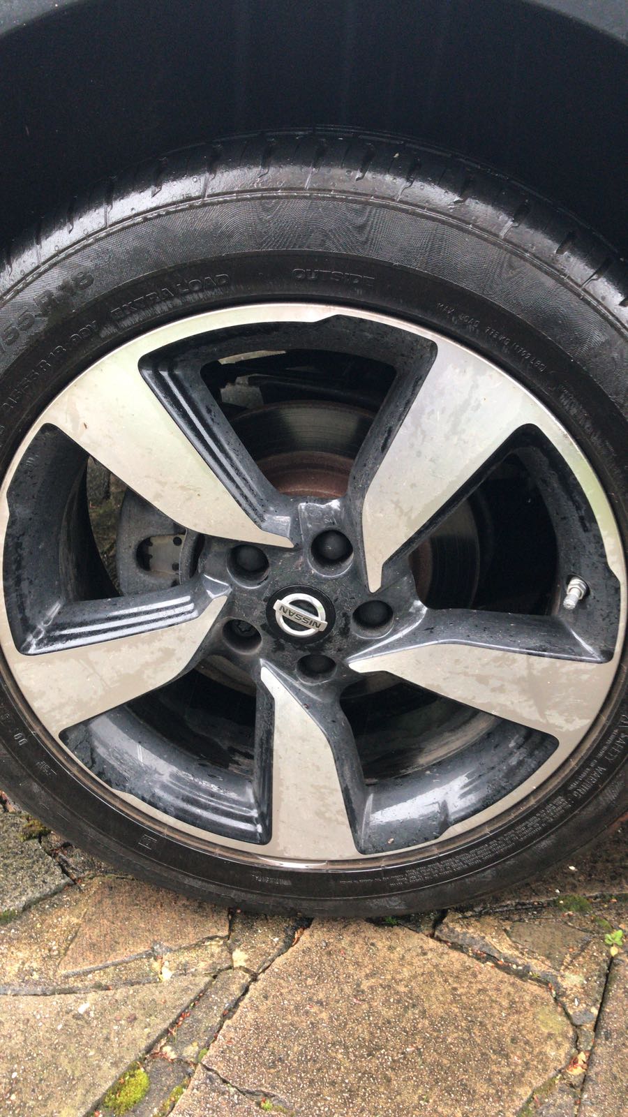

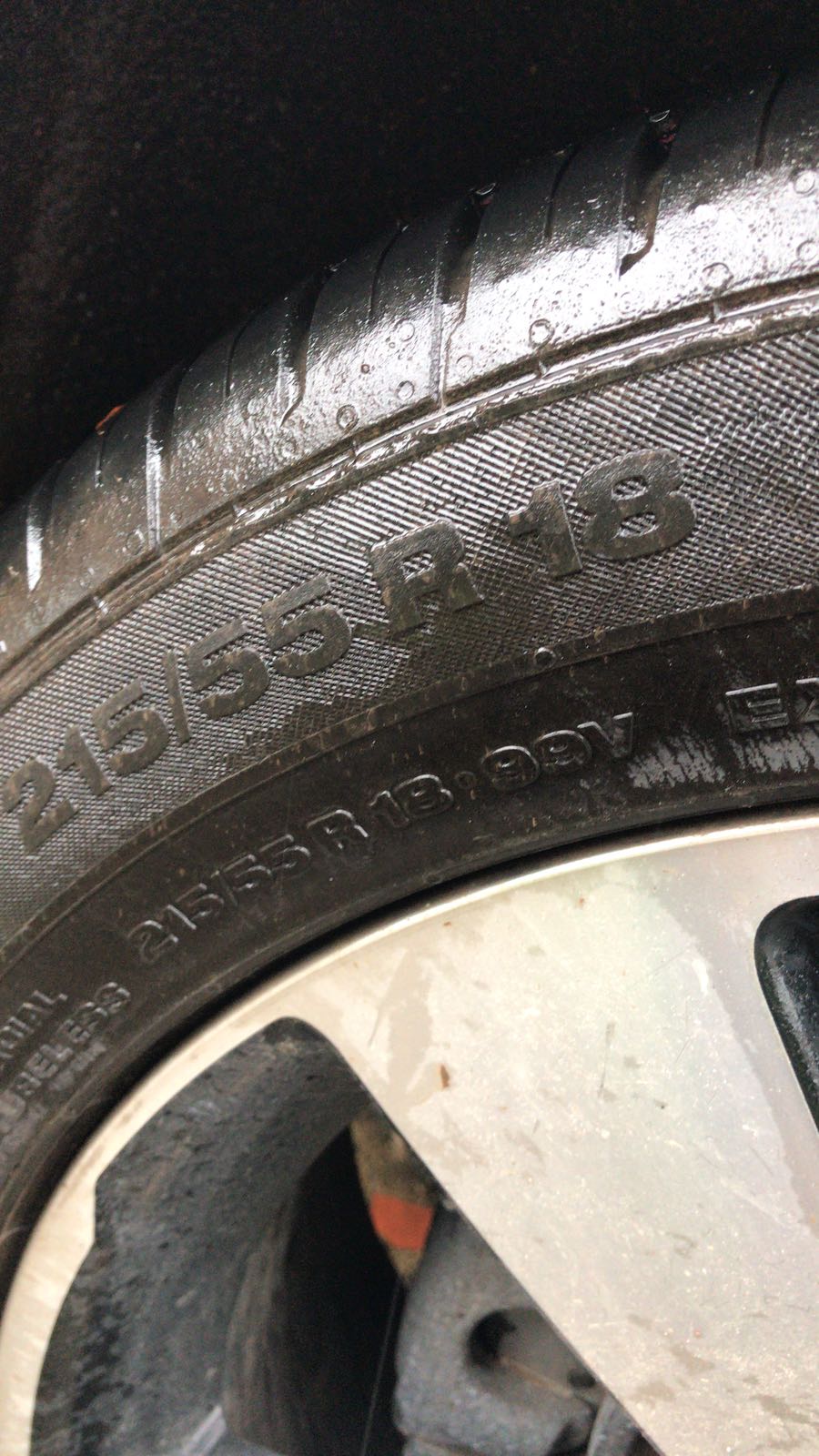

View attachment 139929 View attachment 139928 can someone offer me some advice please about obtaining a spare wheel for my daughters qashqai , 65 plate car .
I was concerned before reading the space saver post but now I realise the effect of not having a good proper spare is more worrying than before
It seems to me that the only safe answer is s proper spare, equal in size to the other tyres
Can anyone offer some advice ? Tia
ONLY buy a Qasqai wheel (and ideally for the same model)! There's a lot to wheels. It's not just a case of getting one the right diameter. It needs to have the right rim width and the right offset too (and of course, the right stud pattern and centre hole to locate on the hub). Smaller details include having the right cone angle for the wheel nuts (or bolts) to seat against and, of course, being suitable for the weight of the car! Strictly speaking, it would need to same moment of inertia as the other wheels because the ABS will have been mapped to expect that. It's just too easy for insurance companies to wriggle out of a big claim these days! Part of the reason cars are limited to 50 on spacesavers is as a result of some of the factors mentioned above. They need to do a "braking deviation test" when they are type approved. (unladen and fully-laden, with the spacesaver on each corner that it is approved to be used on). The car mustn't deviate from a 3m wide corridor when you stand on the brakes with the spacesaver on. In the previous thread, this might have been the reason for not being allowed to have it on (can't remember) but the front or rear. It was quite possible because the car couldn't pass its type approval test on it when fitted to the other axle.
