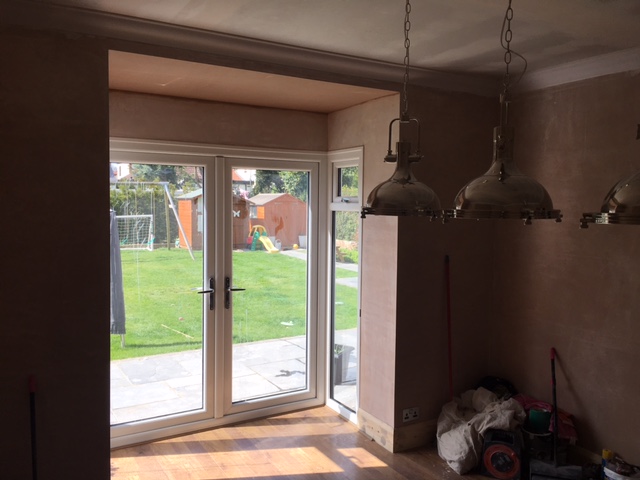

Quality of Plastering
Shocking workmanship. I bet some of the old, original plaster underneath, that was skimmed over, was in better finished condition than the "new plaster" that has just been put on. If that was my work, i'd be ashamed. Sorry to be so blunt about this, and nothing is ever perfect, but that is a very poor job overall.
So, in the position that I either ask it to be re-done? Or refuse payment? I hate situations like this...not that I have been in one before.

some of the corners in your photos look abysmal ... tough one for you and not a nice situation to be in to have to confront tradesman but you cannot pay for that
agree its rubbish and you have paid top dollar too, in fact over the top
Had the guy round today. Cited my concerns.
He said he would redo the bay and the wonky lines. He would also re-do the bay reveal where that slightly visible square of plaster board is.
He also apologised for the mess on the skirting. He spotted that before I brought it up.
He felt that the marks on the walls are cosmetic and due to the application of water to deal with the plaster going off so quick and did not think they would appear at all once a decorator had painted it.
The walls do feel flat and consistant to touch. To give him the benifit of the doubt, the pictures may be making the room look worse that it is. It is hard to say as I do not have years of experience looking at finished plastering jobs.

He said he probably thought his guy had issues getting a straight line due to the socket being there and the lack of space for the trowel to properly skim a good line (i'm paraphrasing). If they had only asked I would have removed the socket completley and put a chock on the cables for them.
View media item 99929
With regard to the raised square bump on the bay reveal. He said that he would re-do it all If I wanted. He would have to put new angle beads over the existing (new) angle beads in order raise the level enough.
I am still debating if this is worth doing, but you can feel a slight bump. I am just trying to determine how visible it will be when finished.
View media item 99948View media item 99944View media item 99947
Regarding the bump, you know its there if you leave it, it will always be a niggle and you will wish you had it put right in the first place.
I assume there is no issue in putting angle beads over angle beads to raise the level, if re-doing the bay frame/reveal.
No real issue, you'll just have an extra few mm added to the wall.
