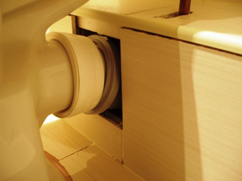

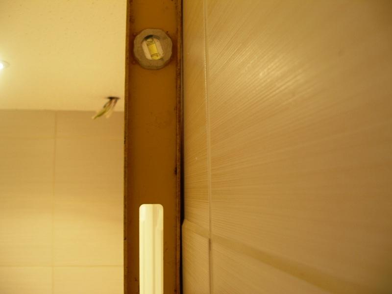

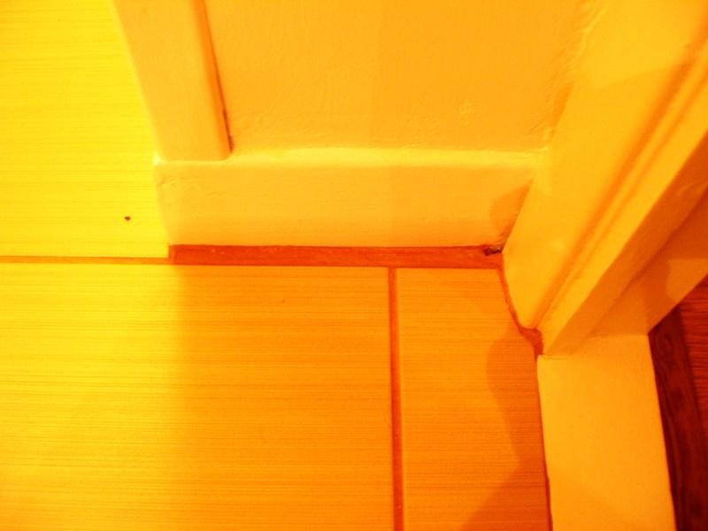

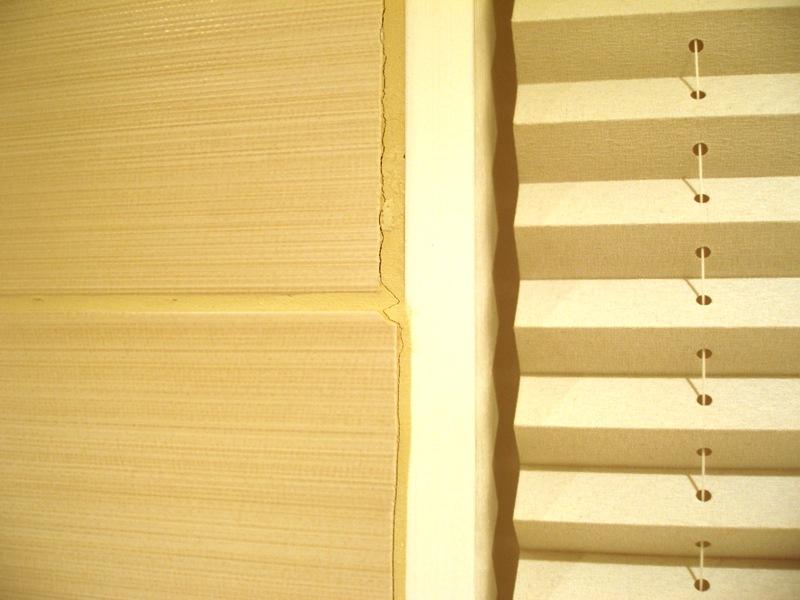

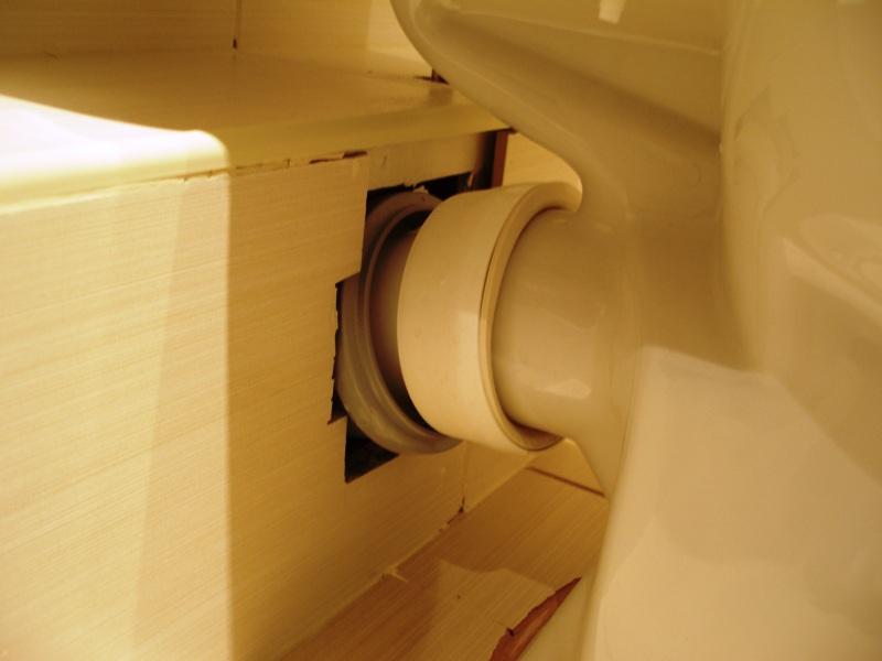

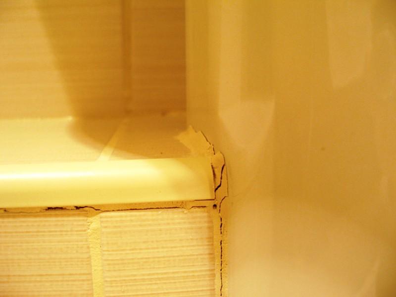

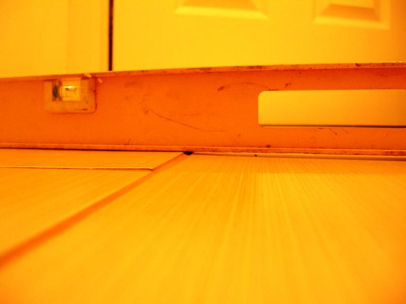

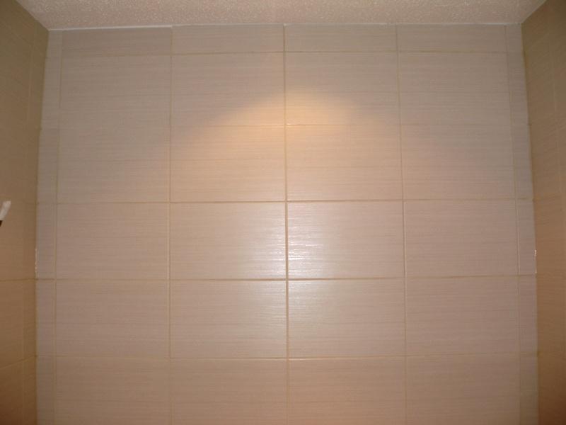

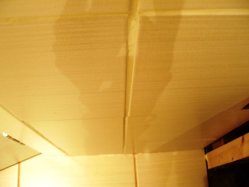

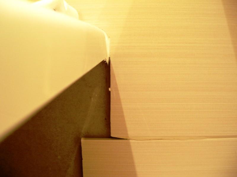

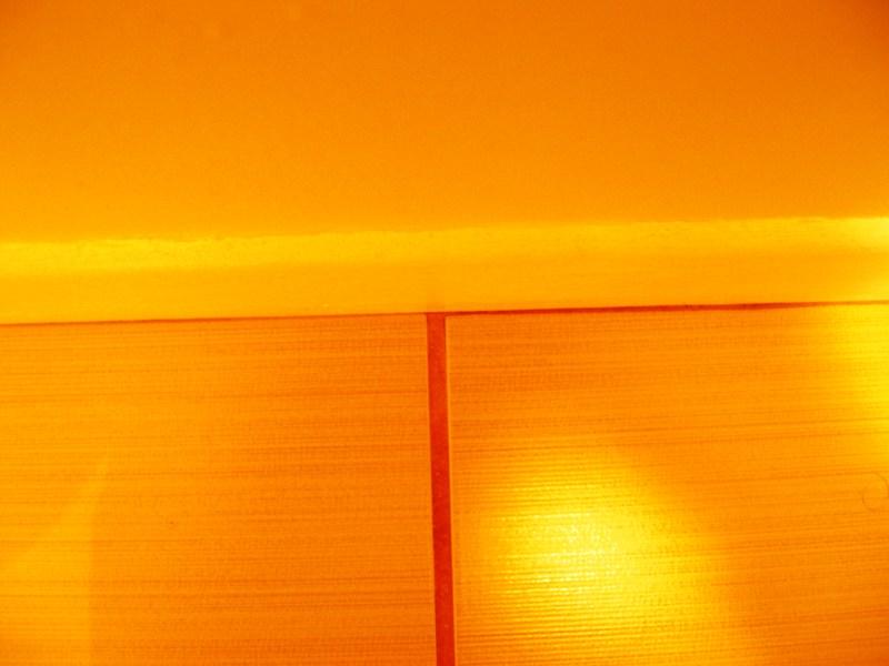

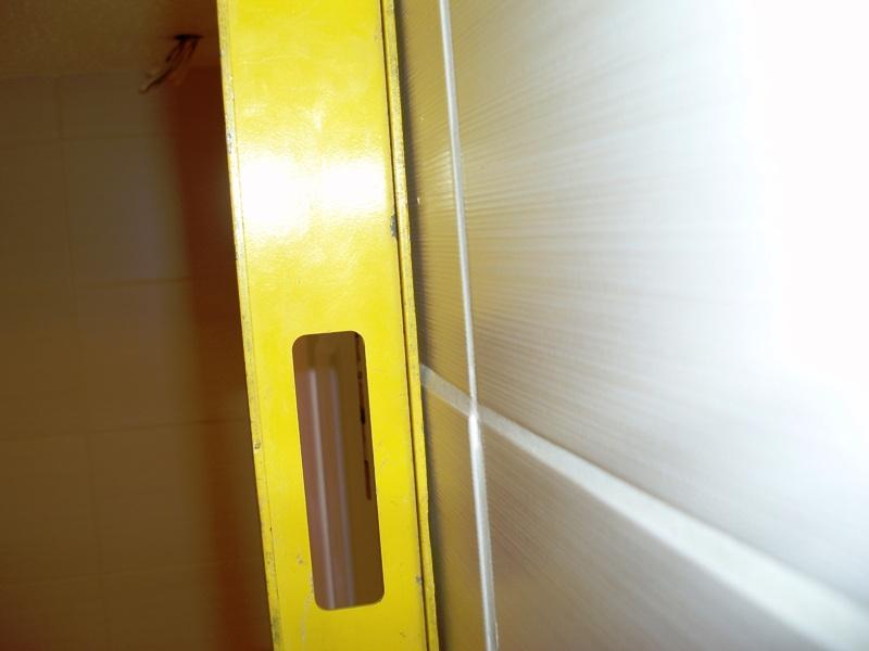

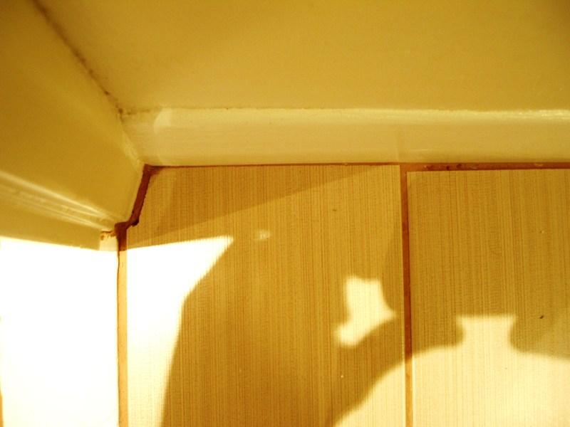

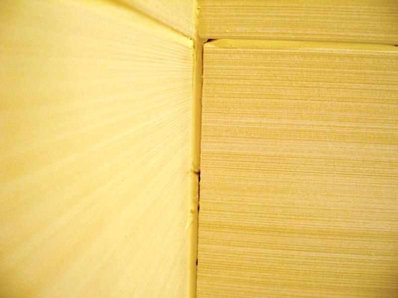

Few more photos added. It's not looking any better after 48 hours.
bloody hell, it looks even worse than it did before with the original pics. if it was me, i'd have the whole thing stripped then i'd have him in court for the cost of your tiles + cost of someone to rip it all out and re-prep for a proper tiler.
i honestly couldn't give a flat away with a bathroom which looked like that.
Just had the tiler round for a discussion.
He has offered to rectify the work that he feels needs to be done at his cost. I still need to agree with him exactly what the extent of this will be on the basis of a snagging list I'm going to prepare.
The main outline of what he is prepared to do is as follows:
Replace any tile where the lippage is more than 1mm. Some lippage is over 3mm.
Improve the look of other areas of lippage by applying fresh grout over the existing.
Replace any tiles where the intended 4mm grout lines are say under 2mm and over 6mm. Ditto any holes in the grout.
Hide the internal corners on the walls with a thicker (say 10mm) bead of sealant. Ditto any floor tiles that have been installed close or tight to the skirting. Ditto the join between the wall and floor tiles.
He estimates it will take two days and will seek full payment on completion.
He feels that in addition to the major issues I've raised, I have tried to add weight to my case by highlighting minor issues that would otherwise have been accepted.
He also suspects that anyone who recommends a rip out is just looking for work.
I've assured him that if the tiles come off the only person who will be putting them up again is me, safe in the knowledge my first ever project will be better that what he has initially presented me with.
However, as things stand, he has acknowledged some of the work needs to be rectified and that he can improve the look of the tiling.
As you'll all know, Trading Standards dictates that is the route I must follow. I'm understandably fearful of doing so, but I also have to trust his belief that he can do a better job.
Fingers crossed.

i know its hard to swallow,but by law you do have to give this..person..the chance to redo..but again it has to be to a standard off which you are happy with...
