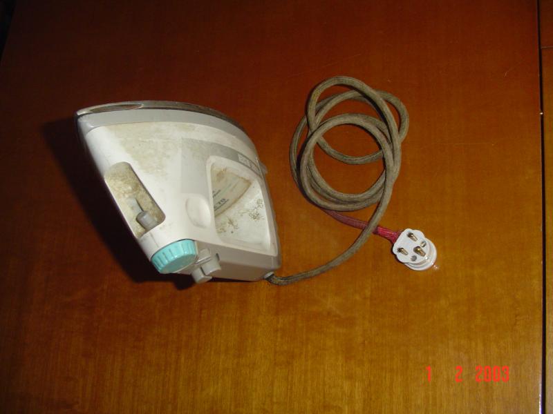

To be honest I personally think its ok too, apart from the fact that I suspect it is non compliant. That is until a casual comment of 'it trips if I have any lights on when I'm ironing' revealed this:
