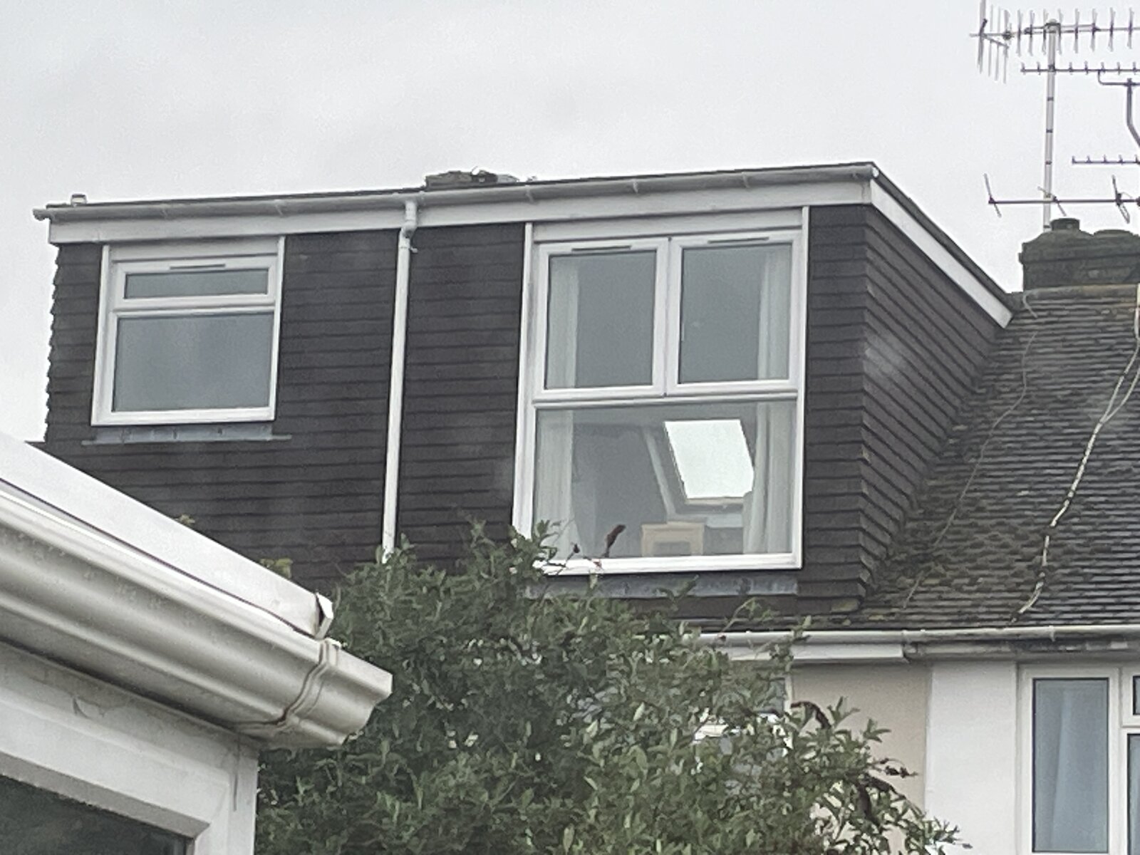

Hi all,
I was wondering if I could get some information on something that's been on my mind.
I live in a bungalow, the properties behind our bungalows are two-story homes.
One neighbour has had a roof extension put in, overlooking our properties and gardens.
I wouldn't have a problem with this, but the main window on the dorma part is large and completely transparent.
Not only does this neighbour walk around the room during the day and night completely naked, but a neighbour of mine says he sits or stands up there with binoculars looking into our gardens.
Shouldn't we have received some kind of notification of such an extension?
Not necessarily, lots of loft extensions are permitted development (so no notification, no conditions, nowt). Still needs building regs though and I'd be surprised if he made thermal efficiency with that massive window.
BUT......a quick look at the Planning Portal tells you that a loft extension is not PD if it involves addition/alteration to a soil and vent pipe. The top left corner of your pic shows what looks suspiciously like the top of a vent pipe- no way that was there before he built the extension so you may have some leverage if you wish to have a conversation with your local planners. The extension does look very 'in your face' (as in very close to your house and quite overbearing on the garden) so he might be on rather thin ice.

Anyhow, there are requirements for the windows in dormers to be of similar style to those in the main house. If that is not the case, that dormer is not permitted development.

Not sure if you're referring to me, but I've never seen them naked at the window and never look at their window, it's only because my neighbour next door mentioned it, did I take the photo, as I was always curious and somewhat annoyed that we weren't consulted before the extension was built.
I think it's the only house backing on to our bungalows that has a 2nd level/roof extension.
