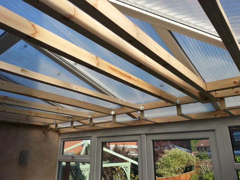

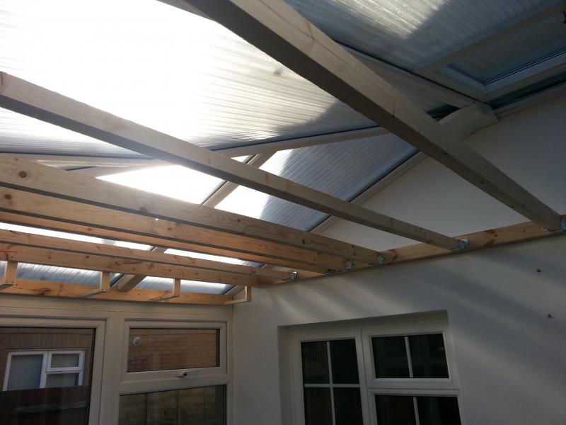

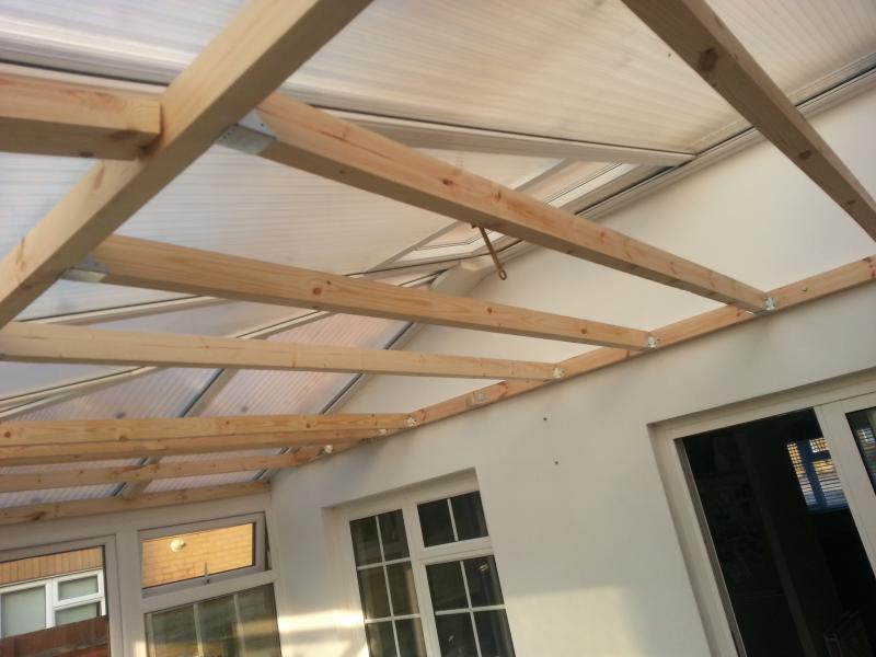

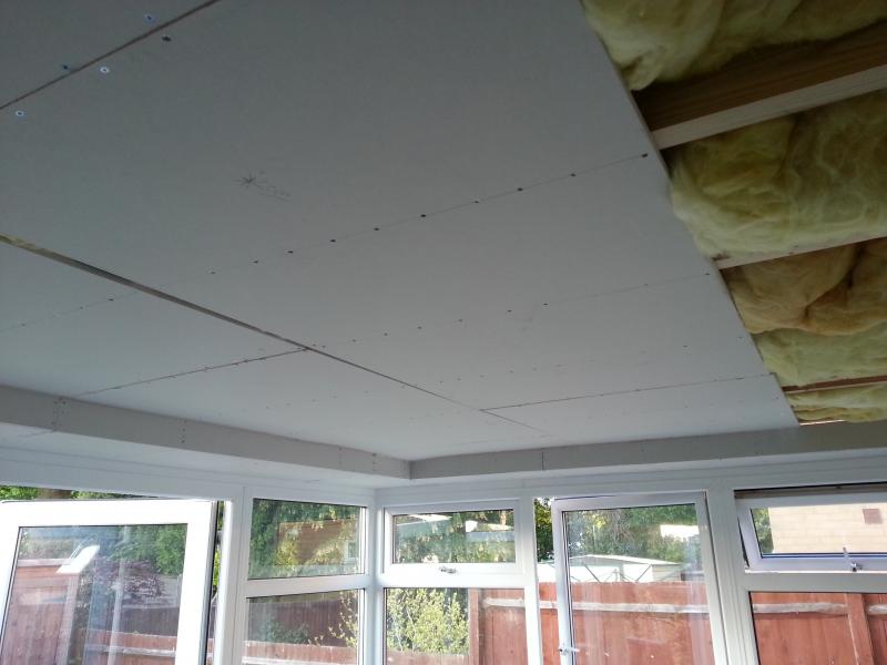

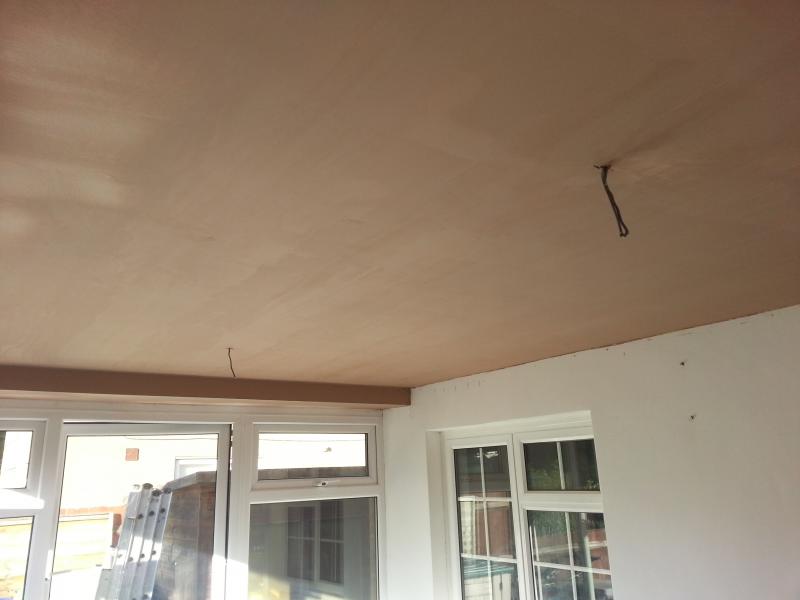

My conservatory Floor space is approx 4m x 3.3m
Cost wise (approx and off the top of my head)
The Timber spaces are at 450mm centres
Timbers - £150
Bolts and brackets - £30
100mm Insulation (doubled up) - 24m2 @ £2m2 (2 rolls)
Plasterboards - £30 (1800x900x12.5mm)
Electrics - £10
Plasterer - £200 (he also done some other bits in the house bit had this ceiling done in about 2 hours)
I done everything myself except the Plastering.

You may choose to vent the void but I haven't yet - its something I am considering doing with 100mm vent cowl - I will most likely add 2 or 3 however if you use the multifoil insulation fixed directly to the roof bars then I'm not sure if you need them but you will have to look into it further. I only done mine the way I have as I cannot afford to knock down the Conservatory and build an extension so its only really a temporary thing for a few years whilst I save up but so far we are really happy with it and it has made a huge difference.
You've done a great job... don't think Ive got the skills or confidence to try putting up all the timber you have! We just moved into a house that had a lean-to conservatory, and were initially made up to have one, until the first few sunny days! Ive had a quote of around £20k! to knock it down, underpin, build up, and put a traditional roof.. which is on hold, til I win the thunderball! So the approach you have used seems by far the most cost effective solution.
