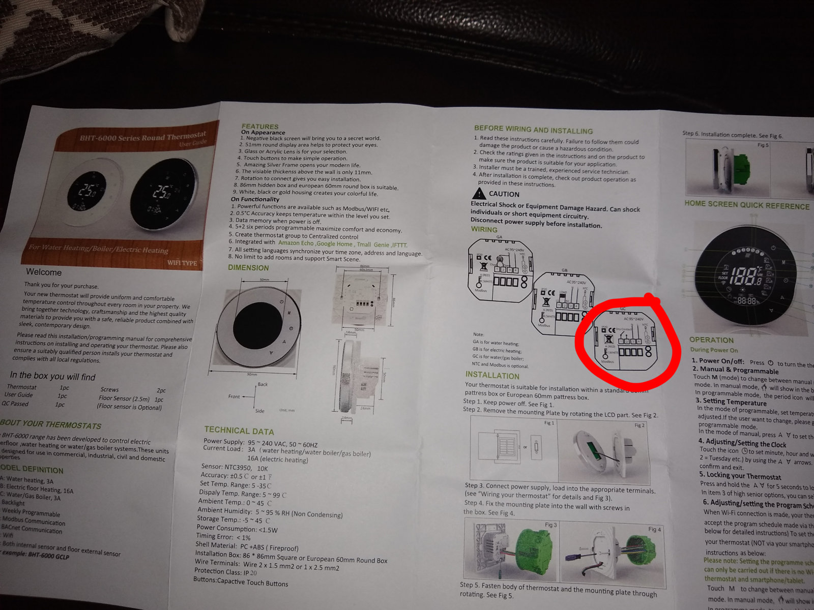

Quick question on smart thermostat wiring with pic
@Madrab
I have the GC version. Is that not the one that needs bridged and not the GB version? As per your last post.
Here's the instructions I got with the stat...
Just to make sure before I go ahead and wire it in, its
L - 4
N - 3
SL - 2
L bridged - 1
