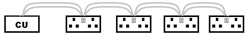

I have seen various 'unusual' circuit designs over the years and I'll absolutely and totally expect EICR % fails of this sort of circuit:
to be into the high 90's.
It will invariably be described a a ring with one socket and 3 sockets on a spur, or a ring with forbidden links etc.
You know and I know it's fully compliant but I imagine some of the regular good posters on here may struggle with accepting it. Not least of which may be due to the difficulty of getting 4x 2.5mm² T&E's into a BS1363 acceessory or even the backbox.
View attachment 258885to be into the high 90's.
I would do it - CU > S1 > S3 > S4 > S2 > CU. It is then reasonably balanced. Better would be five sockets as in CU > S1 > S3 > S5 > S4 > S2 > CU
I most probably would too but this sub threadlette is about wiring a 32A or even a 50A radial... using parallel feed 2.5mm² cable.
