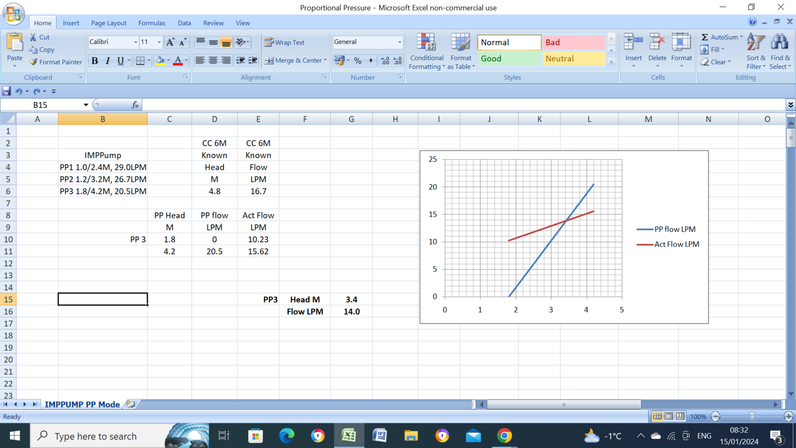

PP mode is interesting as well, if you ever have to replace that pump I would suggest that you get one that displays, at least, the power, watts, some now also display the flow rate in m3/hr, very useful for trouble shooting or whatever. Also, some, like mine, have a settable PP (and CP) mode which can be incrementally set in 0.1M steps to give almost any required head/flow so you can match the head/flow in PP mode to the CC head/flow with all rads open, the head/flow will then reduce as zone valves close or/and /TRVs throttle down.
Below shows what might be indicative of your head/flows in CC mode and PP(3) modes, even though the flowrate isn't greately reduced, the difference in head of 1.4M means that some rads just wont get their required flow without, at the very least, balancing, a pain.
