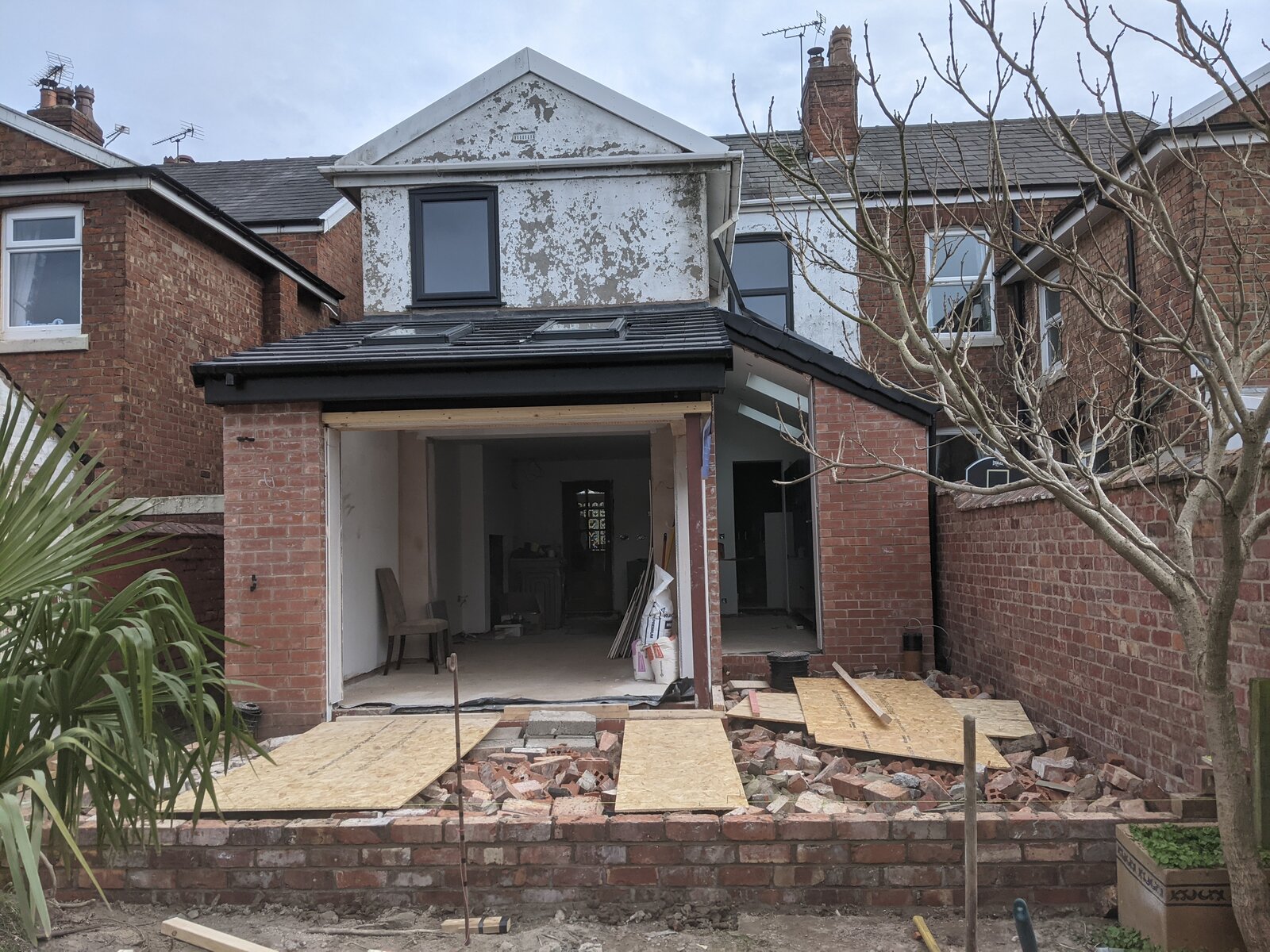

Looking for some advice. We are in the process of building a raised patio on the back of our extension. My neighbour has just called around and said they are not happy with the height and we need planning permission.
I'll be honest I was ignorant to us needing permission of any kind but was aware that the height may be a slight issue (the plan was to have screening plants to enhance both ours and their privacy)
I've looked into the 300mm rule but I can't figure out where to measure from? Is it the original house before the extension? The highest point of the patio (the garden slopes away) Or somewhere else?
Thanks in advance
If on a slope, measure the height from the upper most natural ground level to the top of the patio. If it exceeds 300mm, you’ll require Planning.
Ok, thanks. So, as I step out of my bifolds that is the uppermost natural ground. The new patio will be less that 300mm at that point. 3m further down the patio we will be at 420mm

Thanks for your reply. I invited him around this afternoon and offered him a beer to discuss (he declined the beer)
I have offered to drop the patio one brick taking it to 310mm at the highest point but well under as you leave the property (before the extension)
I have also, as an act of good faith, and despite us being well within permitted development, offered to raise the wall by 2 bricks at my own cost.
He said he "would think about it"
