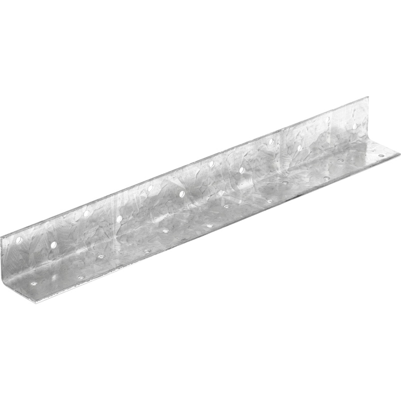

The oven sits at the top of the carcass, no frame should be required, usually sit on a couple of metal rails fitted on carcass sides to aid ventilation.Infill panel or draw below depending on dimensions.(timber rails are acceptable as the base of oven should not be hot.)

I’m pretty sure one of my ovens was mounted on a couple of pieces of angle plate.
