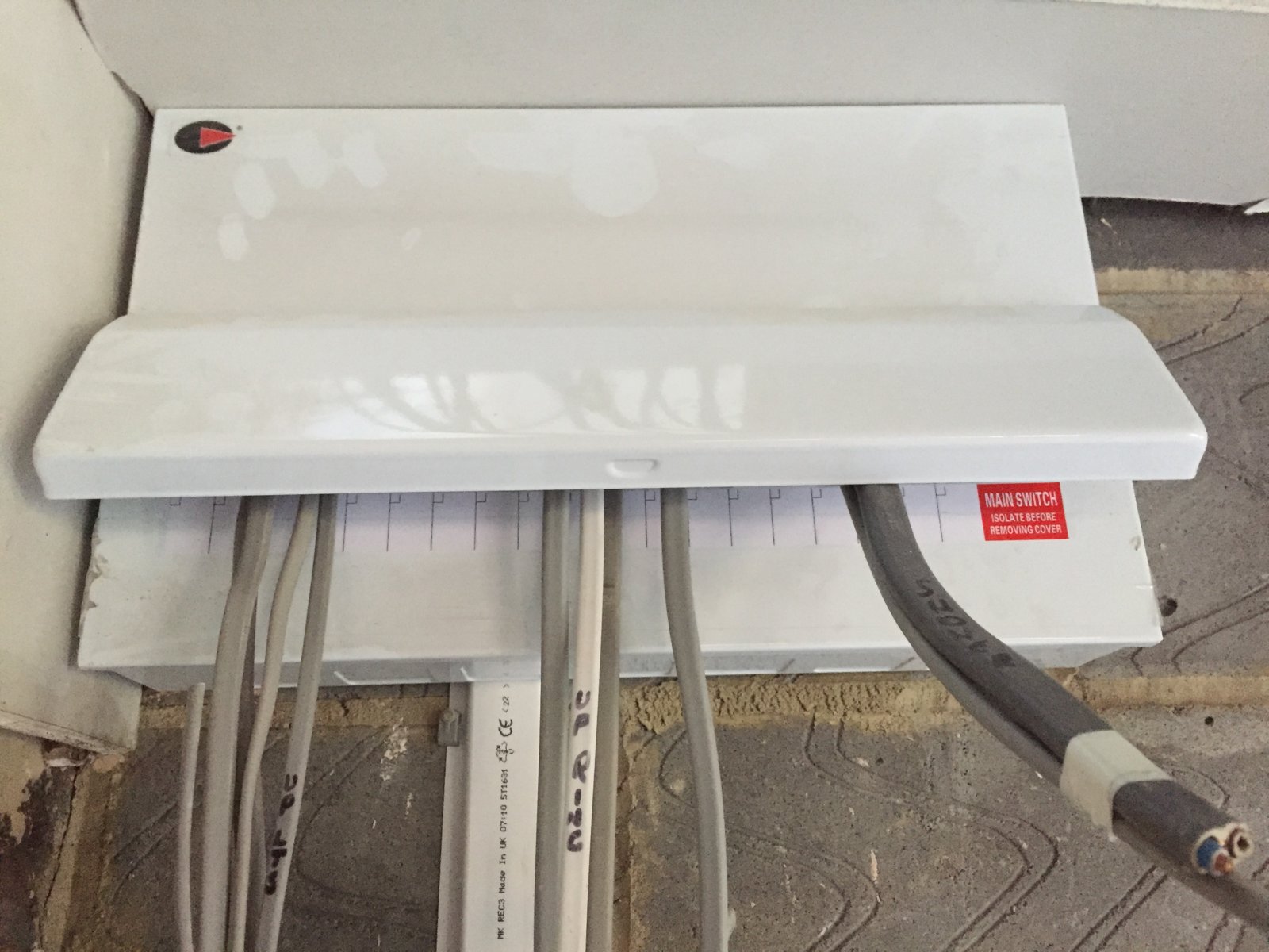

Has your electrician given you a certificate with test results yet? Can you photograph this? Can you photograph your new CU?
Thanks for your reply Lectrician. I’m not sure whether it previously had no rcd protection. The previous consumer unit and Rayburn were installed in 2003 when the house was built.

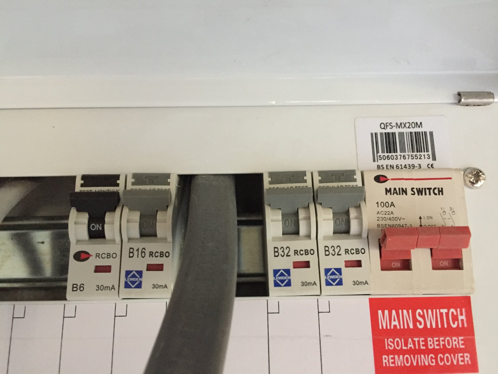

The electrian still has more work to do on consumer unit and electrics in house in general, but Rayburn trips are obviously in. Picture of unit uploaded. The Rayburn is the one (or two - I can’t remember) next to the main switch.
Electrician has ordered a ‘c grade trip’ to try in the new unit. Not sure whether he has used insulation resistance tester. Will ask him.

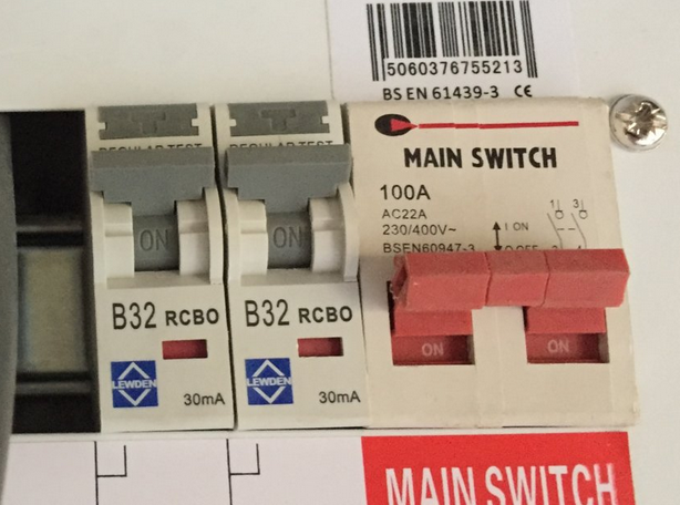

And if I'd remembered what was in the photo I'd looked at only about 10 minutes earlier I'd have known they were RCBOs not MCBs.:(
Many heating appliances use mineral insulated heaters which can draw in moisture from the atmosphere, this will cause a RCD (A RCBO has a RCD built into it) to trip. Most likely it is a moisture problem which is down to fault on Rayburn.
However also it is easy to put a wire in the wrong hole so it could be the wiring, "the cooker does it either after 5-20mins" points to Rayburn, the RCD works within 40 mS so it seems likely as the cooker is switched on moisture is driven from one place to another causing it to trip.
That will achieve nothing.
Highly unlikely given the state of that consumer unit.

This 'electrician' is nothing of the sort.
Why are there cables coming out of the front of the consumer unit?
Why is that mess even energised - there are live parts just inside those holes where circuit breakers or blank plates should be installed.
Did this person arrive on a horse?
There are no circumstances where this shamble is acceptable:
I wondered that.
Reasoned that they are for circuits yet to be connected in the CU.
TBH, apart from (as in "Apart from that, Mrs Lincoln, how did you enjoy the play?") the gaping holes it leaves it's not a bad way to avoid unterminated cables floating around inside the CU in circumstances where they can't be left not yet brought into it.
A result of putting the CU tight up to the ceiling.
I remember seeing the post-fire photos where a DB had been installed like that, and during a fault, the smoke and heat simply rose into the ceiling void and ignited the accumulated dust, followed by the joists and the studwork walls on the several floors above, and the whole house.
If it had passed into the room rather than a void, it would have set off a smoke detector.
CU looks like it’s been fitted a little early.
It looks like RCBOs, so I would assume it’s tripping due to earth leakage. A C type would not cure that.
I've never seen work in progress New "Temporary" Electrical installations done like this ever in all my years. How very odd, the Wall or Ceiling hasn't got a speck of plaster on it, the CU will obviously have plaster round it but why not utilise the knock outs so it it will be easier to install the cables when they become "permanent"?
When the ceiling/plasterboard above is plastered the cover won't be easy to get off without disturbing it?
