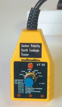

So as an electrician I may well decide that best option is to fit a RCBO. As @JohnW2 points out then I need to inspect and test and complete the paperwork, so need a RCD tester, the tester will cost over £100, so clearly not worth it for a one off job.
OK as a home owned we bend the rules, I use a cheap tester £25 tester
these don't record time, so to spec required really, but good enough for DIY at home, but not good enough at work, at work unless down as being an electrician I can't even swap a 13 amp plug.
